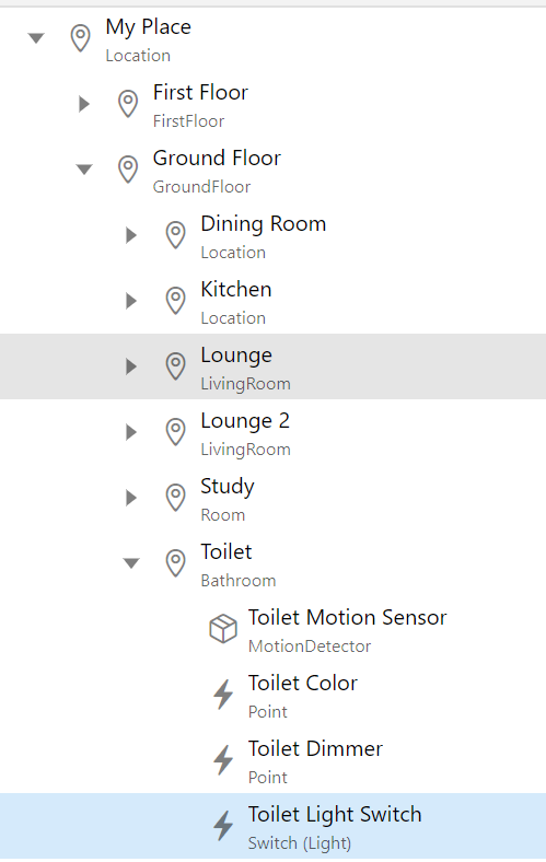

The main_widget_Light_Card in post 1 is now a different name to the original card_2 name - has this been updated in the code as thats my next challenge my room has a light in it which has a non semantic tag of light but it is not showing (it is also a dimmer which might be the issue?)

I added the light as a switch item and added Lights and Light as a non semantic tag - still not showing I wonder if the model is not set up correctly?
No, model is not right, you light items need to be in a Lightbulb equipment group.

Aha - my bad for consistency - seems overkill to put a single light for a toilet in a group until you are trying to use the model like this which makes perfect sense.
I have a light showing! Are you OK with me changing the first post to help flesh out the instructions for newbies?
