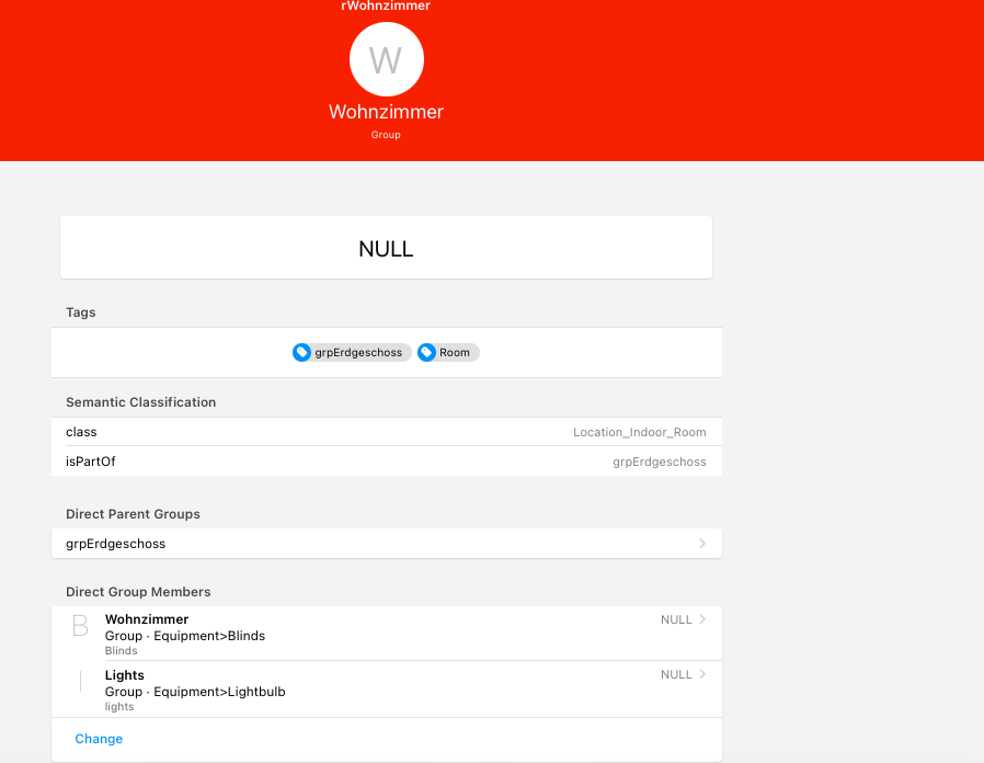

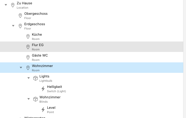

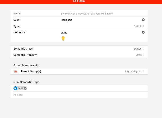

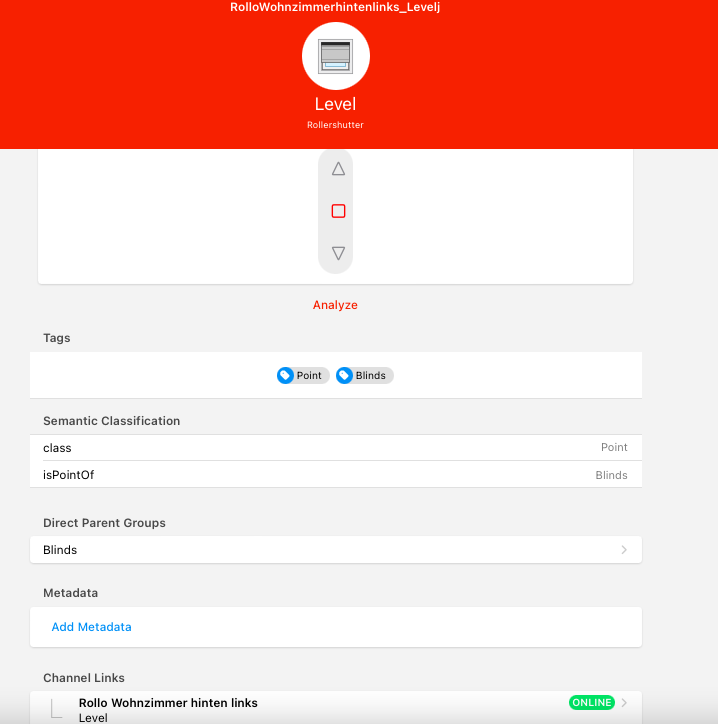

Maybe there’s some non technical people out that could help with the doco - I could if I get to understand what’s required - I’ve got the main widget and the light card now thanks but can’t work out from the thread what’s needed for tags - I’ve got a room with a non semantic tag of Room and it doesn’t show and a light with a non semantic tag of Light and that doesn’t show anywhere- I don’t want to turn this thread into a support thread for silly problems but maybe a base of instructions might increase peoples input for testing or contributing if there was some time to do it - perhaps it might be time to move to a new thread where things could be pinned to the top etc?
