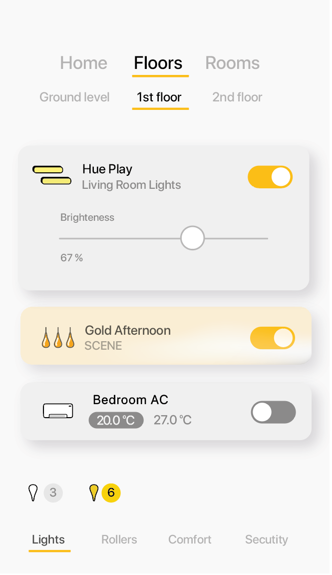

Hi! This widget page is a new project based on the idea to have a new widget for OH3, with a new user-friendly layout to allow control of most of the items detected in semantic model. This will be achieved by a collection of several widgets (e.g. for lights, rollershutters, climate, weather, etc.) installable from the marketplace.
For each “Floors” menu there will be “Rooms” sub-menu to manage and control each single device.
Actually the project is on alpha stage and we all know that it is a long hard way from the idea to the final result, with lots of coding and solving issues, but day by day we’re doing our best to reach that finish line.
So stay tuned on this spicy topic, and any help or suggestion are always welcome.
In the end, this project shall also start a documentation about how several functions have been realized, to be a starting or learning point for others.
Design Drafts
Prerequisits for use
A properly set semantic model based on a floors / rooms / equipment structure is essential. As the semantic model knows more than just the types floor or room (e.g. attic, groundfloor or livingroom, kichen), all floors need to be additionally tagged as floor and all rooms need to be tagged with the additional tag for the floor group item (e.g. gGroundFloor).
Please note, that you can only have one equipment (e.g. Lightswitch) in an equipment group, otherwise it will break the widget. To group more than one, please use non semantic groups, which then can also have the count option.
More to follow later.
Example pictures will follow

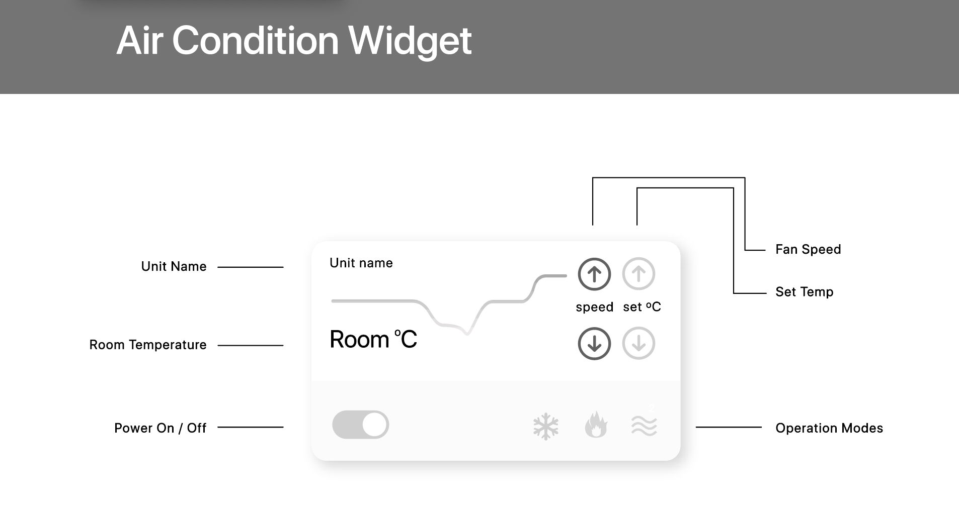

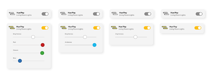

Hello Sir, Hello Community. Many thanks for that beautiful widgets .
Having zero experience with coding i’m wondering if there is a volunteer to create a new widget based on Temp Card you have create with some additions. Im uploading my design for a quick review. Any thoughts is welcomed! Am a poor Mac User who loves to design and having zero talent in coding!
Thank you for your time reading this

Hi @Dimitris,
i am also not a coder but I love to try the things out.
I will have a look at this design this evening and post my efforts.

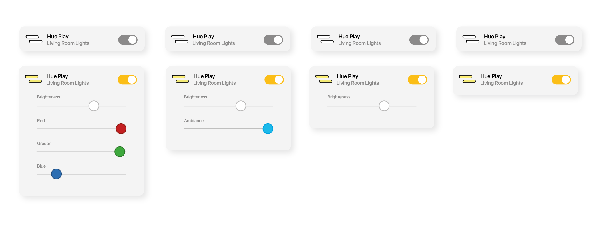

For now another question from me - because I am not a designer at all: Could you design a good looking “room widget” to build a dashboard for mobile phones?
Perhaps we could together manage the jobs :wink:
Absolutely! Can you provide me with a short brief ? What you want to control and which info must be included in the card? or send me an existing design for trying some alternatives and improvements. Thanks for your reply

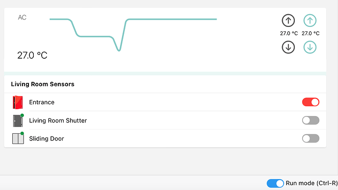

first of all the promissed code:

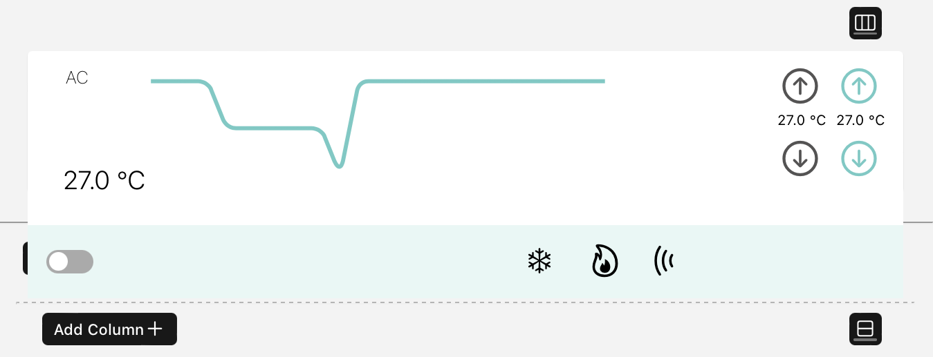

please try it and give me feedback - i will finish it then.

my thoughts would be to see the light state, the actual temp, actual humidity the state of windows and roller shutters .
WOW. It works and is beautiful - You are awesome!
Yes i have some feedback :smiling_face:

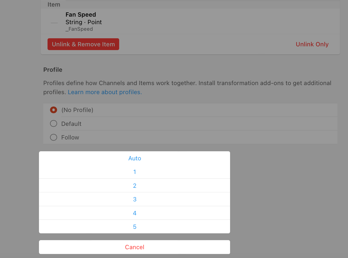

Grey buttons selects the fan speed:
Grey Arrow up selects the upnext value, grey arrow down the previous value.
Values 0,1,2,3,4,5
(Auto =0, Sleep=1, Low=2, Med=3, High=4, Turbo=5)

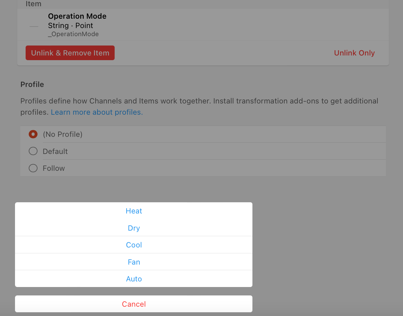

Channels@AC:
Set mode buttons preferred to be aligned right and selectable- displays Active mode. MODE Icon changes color when selected and the inactive goes grey. (Channel Operation Mode)
Last but not least:

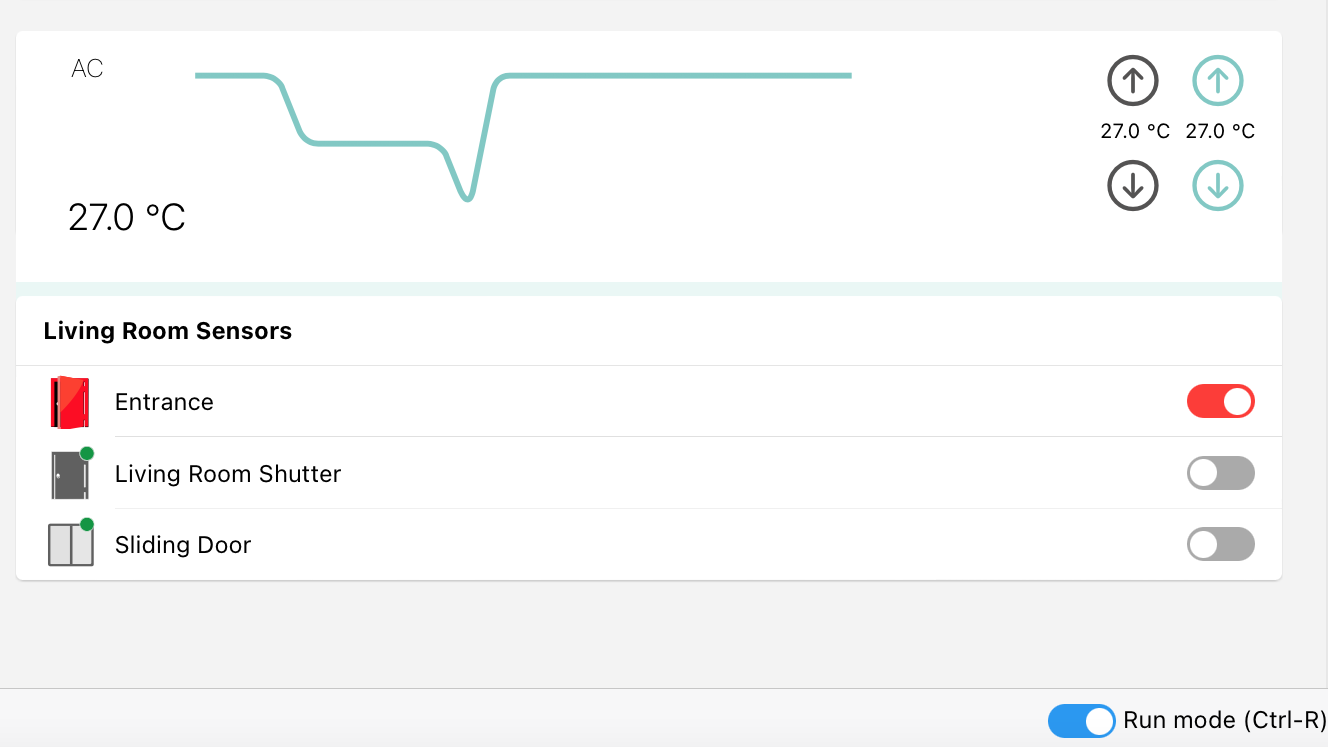

While I’m editing the widget, the layout seems ok.
When i run it, the bottom part of the widget is missing (goes under the next cell)

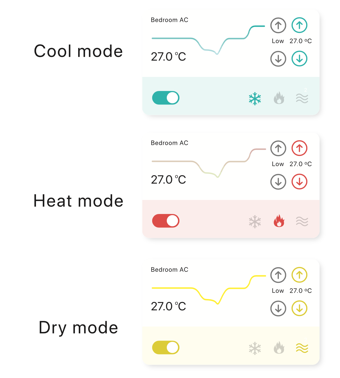

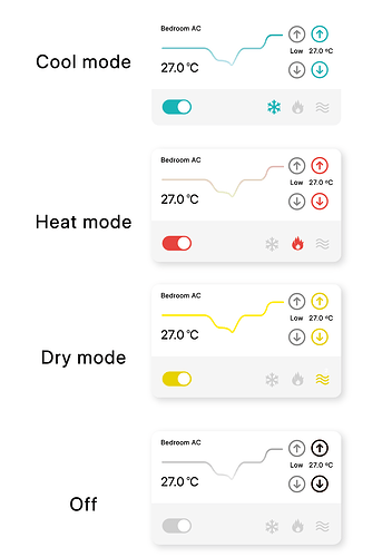

I’m sending you just a little bonus until to start design the layout i promised. It’s something that I’m working now. When it finishes, Tomorrow i will be hands on for our little project.
Alarm and rollers cell_overview.pdf (419.0 KB)

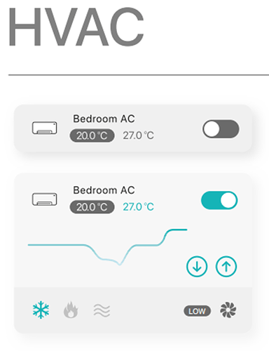

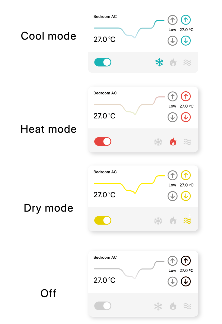

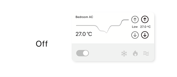

And the updated version for the AC widget:
AC Widget_02.pdf (154.0 KB)
In this version (i think its better..) only the icons changes color depending on selected mode (cool, heat, dry)
Again, THANK YOU. Pls give me some time!

Hi there,
I made some efforts - hope to post the updated Code this evening / night
here comes the updated code. At this time, please have just a look if the Layout is correct and that the widget does not overlap with other widgets.
The features (step up and down, on/off) would be easy to add - but the layout drives me crazy…
I tried to different approaches - please have a look, which works for you:

                - component: oh-button
                    visible: true
                    iconF7: arrow_down_circle
                    iconSize: 35
                    action: command
                    actionItem: =props.set_temp_item
                    actionCommand: =Number(items[props.set_temp_item].state.split(' ')[0]) + 0.5
                    style:
                      position: absolute
                      top: 120px
                      right: 100px
                      height: 35px
                      background: transparent
                      color: "#7fc8c5"
          - component: f7-col
            config: {}
              default:
                - component: Label
                    action: toggle
                    actionItem: Irrigation_Switch
                    actionCommand: '=(items["Irrigation_Switch"].state === "ON") ? "OFF" : "ON"'
                    text: =items[props.temp_item].state
                    style:
                      font-size: 34px
  footer:
    - component: oh-toggle
        item: =props.color
        color: teal
    - component: f7-icon
        f7: snow
        f7: flame
        f7: radiowaves_left
uid: test123
tags: []
props:
  parameters:
    - description: Title
      label: Title
      required: false
      type: TEXT
    - context: item
      label: Temp1
      required: false
      type: TEXT
timestamp: Jul 28, 2022, 3:05:22 PM
component: f7-block
config: {}
  default:
    - component: f7-row
        style:
          background-color: white
        default:
          - component: f7-col
              width: 85
              style:
              default:
                - component: oh-trend
                    trenditem: =props.temp_item
                    trendGradient:
                      - "#7fc8c5"
                - component: Label
                    text: =props.title
                    style:
                      font-weight: 150
                    trendItem: =props.temp_item
                    trendGradient:
                      - "#7fc8c5"
          - component: f7-col
              width: 5
              style:
              default:
                    f7: arrow_up_circle
                - component: Label
                    text: 12
                    f7: arrow_down_circle
          - component: f7-col
              width: 5
              class:
                - justify-content-center
                - align-items-center
              style:
              default:
                    f7: arrow_up_circle
                - component: Label
                    text: 34
                    style:
    - component: f7-row
        default:
          - component: f7-col
              style:
                background-color: "#eaf7f5"
              default:
                    item: =props.title
                    color: teal
                    f7: snow
                    f7: flame
                    f7: radiowaves_left
and number two:
Overlap issue was corrected. But i think we have a long road ahead! :thinking:
In my perspective, try more to align with the layout:
If you think that you need graphic elements in a specific format (svg icons?) just letme know.
Re dashboard. Im thinking about navigation nightmare. I have design an early draft that the user can navigate to areas and equipment with a simple way ie
Find below an example for light equipment and the properties that the specific light has.
To minimize the information showed, when the equipment is off, cell is minimized and presents only the on-off button (and some badges in some cases). When you power on the light, shows all the available controls.
Clolumn 1: RGB light
Column 2: Light with temperature control
Column 3: Light with brightness control only
Column 4: Light with on- off control only
first row: Light is off
second row: Light is on showing the available controls.
Same logic for all equipment: In my opinion, when something is off you dont need all the controls. First turn it on (default:previews state), then control it.
Take a look how this can implemented further, ie to support Scenes
The goal is simplicity for better monitoring, navigation and control.
Again, there is a long road ahead.
Please let me know what you think.
Cheers
Hi dimitris, all,
Compliments for your design!! Looking forward to you code/implementation of the full app. How far are you?
I’m using openhab for some time now and it is very stable and has lots of options through the marketplace. However, I’m missing a coherent UI design that is relatively easy to implement like mushrooms in Home Assistant. So far I managed to get made a couple of widgets and screens, see below.
I was wondering if it would be an idea to create a set widgets / design with group of people to have one nice designed look and feel? I’m not very well with code but can manage the there are some more experts involved.
What do you think?

My main Problem while coding Dimitris Widget is to get the colored footer. An oh-Block makes ist difficult to scale/make ist responsive.
Perhaps you can have a look at the code i posted. The First try seems to look best but is Not scalable or overlaps other Widgets…
