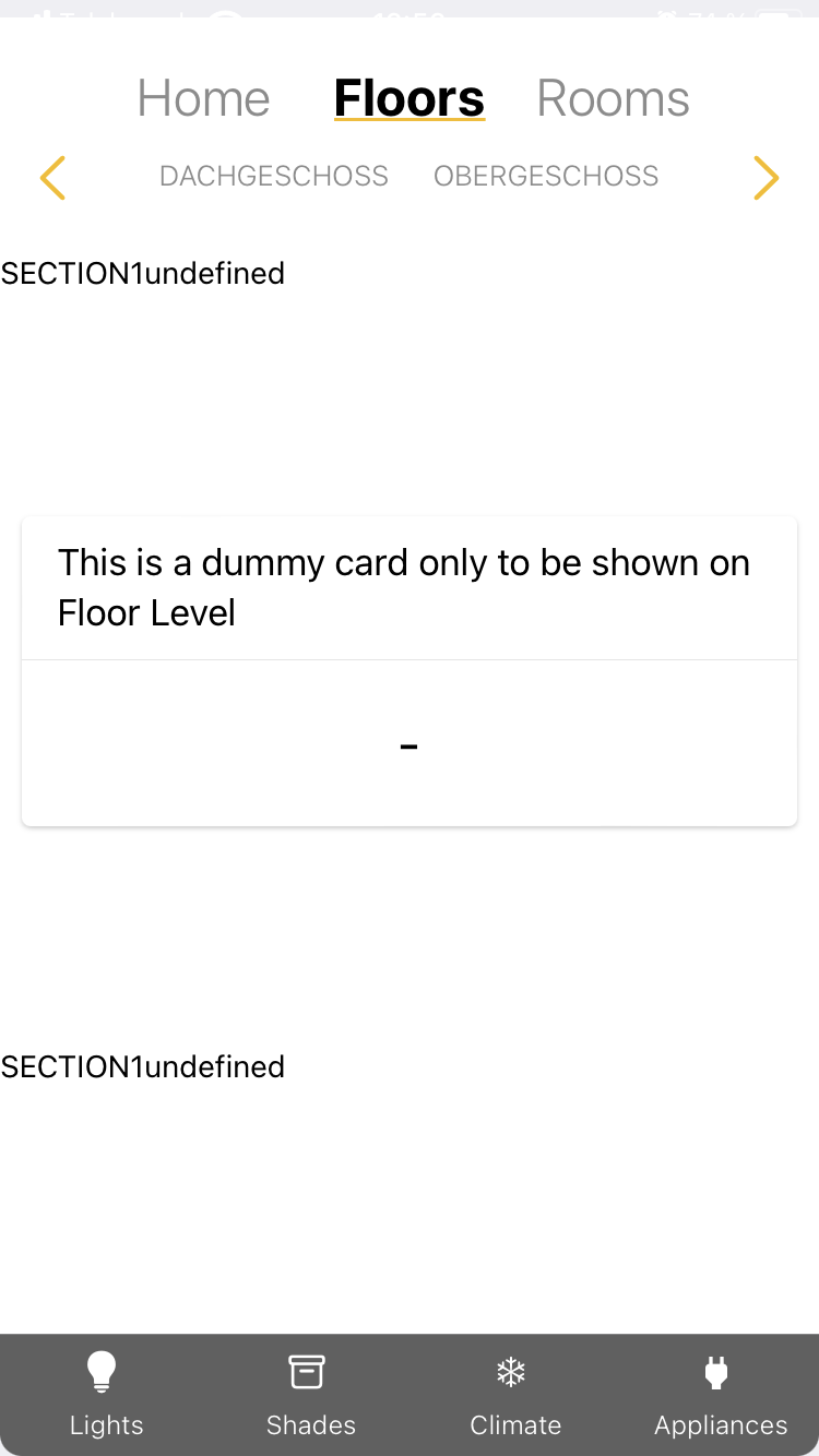

[OH3] Main UI - main_widget - part 1 - The main_widget [3.3.0;3.4.9)
The “main_widget” project is a series of widgets to create a new mobile view for controlling your openHAB installation. For full functionality, you will need to install all widgets listed in the development thread.
Installation:
  • Add the non semantic tag “Floor” to all your floors and if you like, also add the widgetOrderIndex to them
  • Add the name of the floor group 8e.g. gGroundfloor) as a new non semantic tag to each room in that particular floor
  • If you want a specific ordering in the floors and/or rooms menu, please add the widgetOrderIndex as metadata to your items in the model.
  • Install all needed widgets for this projekt from the marketplace.
  • Create an new layout page in openHAB MainUI
  • Enter the code tab for the new page and paste the following code

configure the main_widget on your new page with the missing information (some items/groups need to be definded.
Screenshots

                    visible: "=!vars.objVar ? false : (vars.objVar.selectSection==SECTION1) ? false : true"
                    default:
                      - component: f7-row
                          style:
                            display: flex
                            height: 2em
                            justify-content: center
                            overflow: hidden
                          default:
                            - component: oh-repeater
                                filter: loop.menuArrayRoom_idx == 0
                                for: menuButtonRoom
                                fragment: true
                                in: =loop.menuArrayRoom
                                map: ((loop.menuButtonRoom.metadata && loop.menuButtonRoom.metadata.widgetOrder && loop.menuButtonRoom.metadata.widgetOrder.value) || 0).toString().padStart(3,'0') + '&' + loop.menuButtonRoom_idx
                                default:
                                  - component: oh-button
                                      action: variable
                                      actionVariable: objVar
                                      actionVariableValue:
                                        floor: =vars.objVar.floor
                                        room: =loop.menuArrayRoom[loop.menuButtonRoom_source.sort()[loop.menuButtonRoom_idx].split('&')[1]].name
                                        selectSection: =vars.objVar.selectSection
                                      class: '=(vars.objVar.room ==(loop.menuArrayRoom[loop.menuButtonRoom_source.sort()[loop.menuButtonRoom_idx].split("&")[1]].name)) ? "selected_menu_item" : "unselected_menu_item"'
                                      style:
                                        flex: 0 0 auto
                                        height: 2em
                                        order: =(((vars.buttonIndexRoom || 0) % loop.menuButtonRoom_source.length) + loop.menuButtonRoom_source.length + loop.menuButtonRoom_idx) % loop.menuButtonRoom_source.length
                                        text-underline-offset: 4px
                                      text: =loop.menuArrayRoom[loop.menuButtonRoom_source.sort()[loop.menuButtonRoom_idx].split('&')[1]].label
                    action: variable
                    actionVariable: buttonIndexRoom
                    actionVariableValue: =(vars.buttonIndexRoom || 0) - 1
                    iconF7: chevron_right
                    style:
                      color: "#F8BB00"
                      flex: 0 0 auto
                      height: 2em
          - component: f7-row
              style:
                align-items: center
                display: flex
                flex-direction: row
                flex-wrap: nowrap
                height: 2em
                width: 100%
              visible: "=!vars.objVar ? false : !vars.objVar.floor ? false : true"
              default:
                    fetchMetadata: semantics,metadata,widgetOrder
                    filter: loop.floorItem.name==vars.objVar.floor
                    for: floorItem
                    itemTags: ","
                    sourceType: itemsWithTags
                    default:
                      - component: f7-chip
                          style:
                            background: "#F8BB00"
                          text: =loop.floorItem.label
    - component: widget:main_widget_Home_Card
        locationTitle: =props.locationTitle
        referencePIN: =props.referencePIN
        scenesGroup: =props.scenesGroup
        securityGroup: =props.securityGroup
        securityMode: =props.securityMode
    - component: widget:main_widget_FloorsAndRooms
    - component: f7-block
        style:
          background: =props.bnavColor
          border-radius: 0px 0px 10px 10px
          flex: 0 0 auto
          margin-bottom: -4em
          overflow: scroll
        visible: '=vars.objVar ? (vars.objVar.selectSection=="SECTION0") ? true : false : false'
        default:
          - component: f7-segmented
              style:
                display: flex
                flex-direction: row
                justify-content: space-around
              default:
                - component: oh-link
                    action: variable
                      room: =vars.objVar.room
                      selectThing: Security
                    badgeColor: '=(vars.objVar && (vars.objVar.selectThing=="Security")) ? "orange" : "red"'
                    class: '=(vars.objVar && (vars.objVar.selectThing=="Security")) ? "selected_bottom_navbar_item" : "unselected_bottom_navbar_item"'
                    icon-f7: shield_fill
                    iconBadge: =(Number(items.gDoorsOpen.state)+Number(items.gWindowsOpen.state)+Number(items.motionDetected.state))
                    text: Security
                    action: variable
                      selectThing: Scenes
                    class: '=(vars.objVar && (vars.objVar.selectThing=="Scenes")) ? "selected_bottom_navbar_item" : "unselected_bottom_navbar_item"'
                    icon-f7: rectangle_on_rectangle_angled
                    text: Scenes
                    action: variable
                      selectThing: Appliances
                    class: '=(vars.objVar && (vars.objVar.selectThing=="Weather")) ? "selected_bottom_navbar_item" : "unselected_bottom_navbar_item"'
                    iconMaterial: power
                    text: Appliances
                    action: variable
                      selectThing: Energy
                    badgeColor: green
                    class: '=(vars.objVar && (vars.objVar.selectThing=="Energy")) ? "selected_bottom_navbar_item" : "unselected_bottom_navbar_item"'
                    icon-f7: bolt_fill
                    iconBadge: ""
                    text: Energy
        style:
          flex: 0 0 auto
          margin-bottom: -4em
          overflow: scroll
        visible: '=vars.objVar ? (vars.objVar.selectSection=="SECTION0") ? false : true : false'
        default:
              style:
                display: flex
                flex-direction: row
              default:
                    action: variable
                      selectThing: Lights
                    class: '=(vars.objVar && (vars.objVar.selectThing=="Lights")) ? "selected_bottom_navbar_item" : "unselected_bottom_navbar_item"'
                    icon-f7: lightbulb_fill
                    text: Lights
                    action: variable
                      selectThing: Rollers
                    class: '=(vars.objVar && (vars.objVar.selectThing=="Rollers")) ? "selected_bottom_navbar_item" : "unselected_bottom_navbar_item"'
                    icon-f7: archivebox
                    text: Shades
                    action: variable
                      selectThing: Climate
                    class: '=(vars.objVar && (vars.objVar.selectThing=="Climate")) ? "selected_bottom_navbar_item" : "unselected_bottom_navbar_item"'
                    icon-f7: snow
                    text: Climate
                    action: variable
                    class: '=(vars.objVar && (vars.objVar.selectThing=="Appliances")) ? "selected_bottom_navbar_item" : "unselected_bottom_navbar_item"'
                    iconMaterial: power
                    text: Appliances
