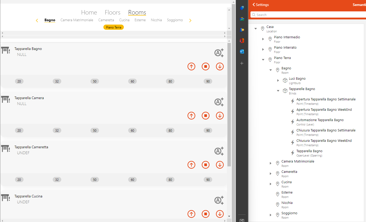

Ive dropped in the widgets but nothing shows in any room - I can also see scrollbars everywhere is that expected? Maybe I just need to wait for some documentation
Strange, did it work for you before updating ?
Please post a screenshot and list what widget you have installed.
hi, i’ve found some bugs to be corrected:
this summarize what i see:

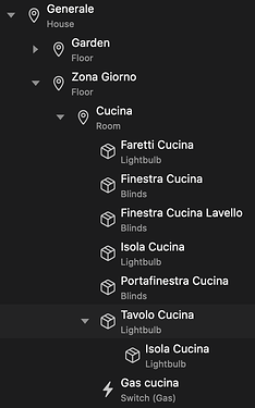

these are 3 different rollershutters but shown all in the same room.

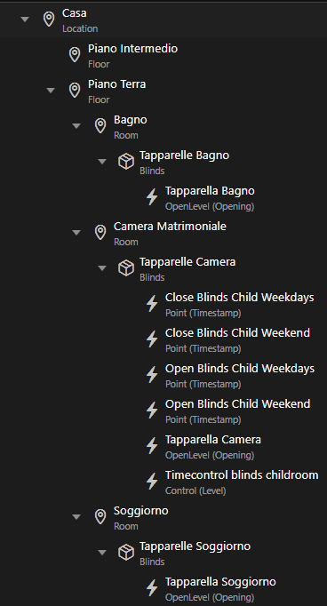

this is my test model:
“Close” and “Open” items are members (just to test) of both “Tapparelle Bagno (Blinds)” and “Tapparella Soggiorno (Blinds)” (even are not shown in the model).
also tried leaving these 4 additional items only to “Tapparelle Bagno (Blinds)”.

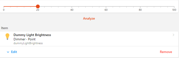

nice idea to add time picker, but better also to explain how to use API Explorer, just adding a screenshot.

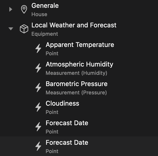

weather widget has no data. I configured the Local Weather and Forecast as equipment in the semantic model with data as point item. Items correctly get the data from OpenWeather but they are not shown in the widget (probably a noob question, but I couldn’t find anything in the forum).

We need to see some of the item definitions.

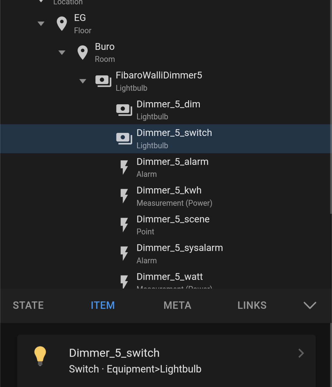

Did you add the needed „modeBlindsXxxAuto“ switch item to the equipment groups ? This is marked as mandatory, whereas the DateTime Items are optional.

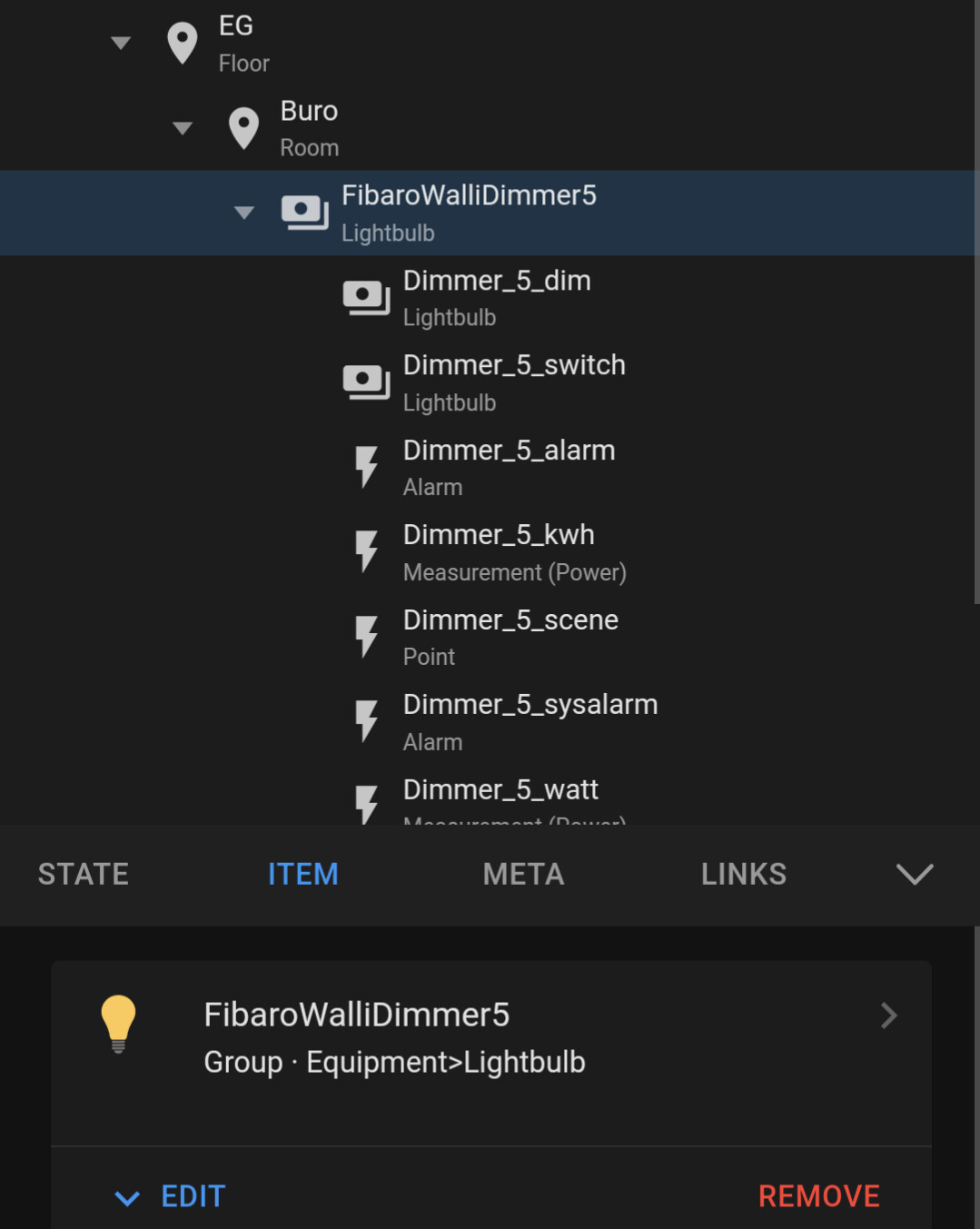

Please post the light equipment and switch definition.

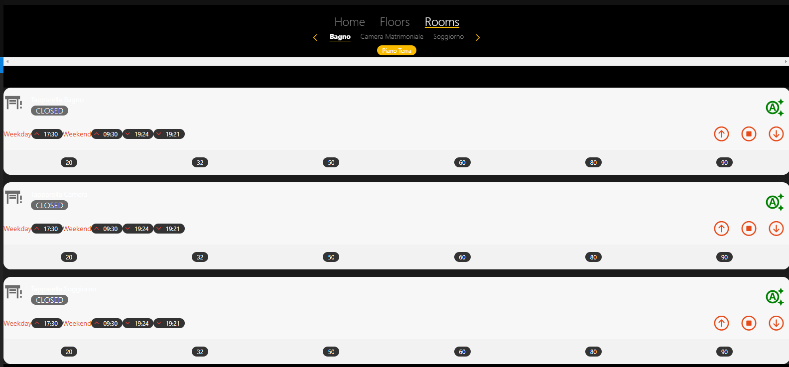

@hmerk you’re wrong. sometimes is better to spent 5 mins to be sure you’re right, instead point the finger to someone else telling is making something wrong.
rollershutters need to be reconfigured by the previous version and also your code need to be changed.
yes i haven’t said is forced to white, i’ve said the text is white. better to force black or add theming option.

From the docs:
A Switch item to enable/disable the automatic/time control [mandatory]

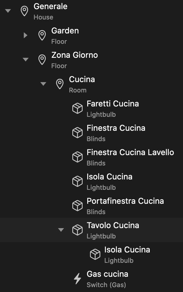

by the way, again i post my settings, to show you the issue:
is my model not correct? (don’t pay attention to UNDEF value)
if my model is not correct, i will say sorry.
i spent 4 hours to check my model, and before surrender i checked the code, and there was the error.

You quoted me asking a question to another user. Within his screenshot, I could not see the items in the blinds equipment group, so question was valid.
Experience we made here was mostly issues with the semantic model caused problems.
I cannot see the details of your items, therefore cannot say if you model is correct or not.
If you found an error in my code, why not telling here ?
I am not saying it is perfect, but I am not publishing untested code.
And it was not just me prooving it works following the posted instructions.

I have forced to set text colors to black and changed the chip background.
Don‘t know why „light-gray“ worked in light-mode but not in dark-mode.
Now using the hex code and it works on both themes.
