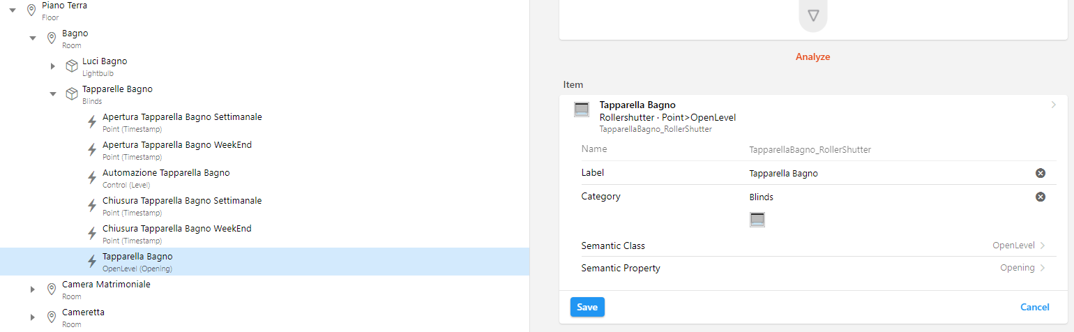

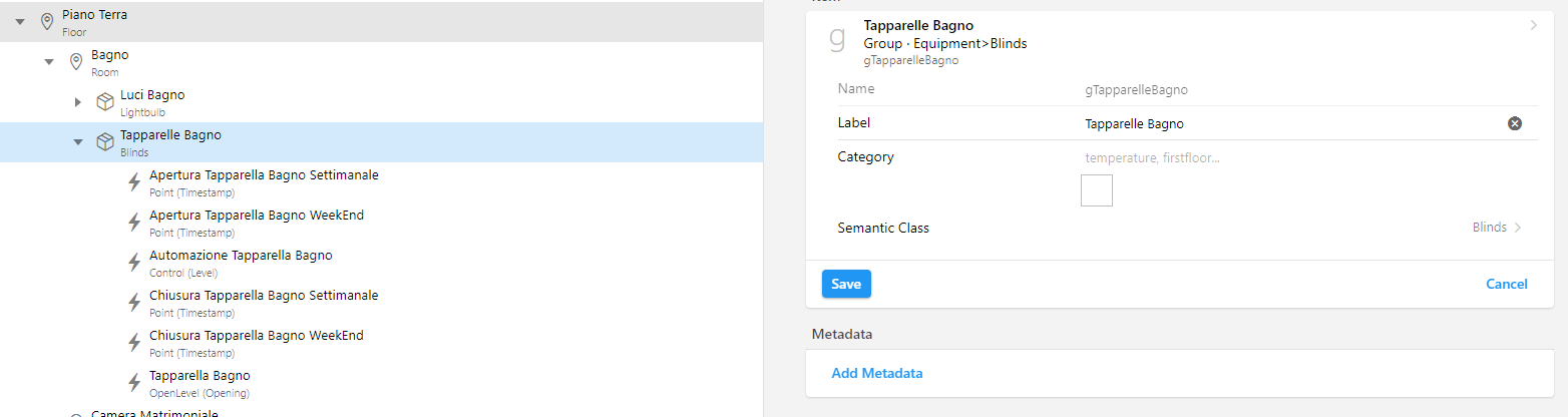

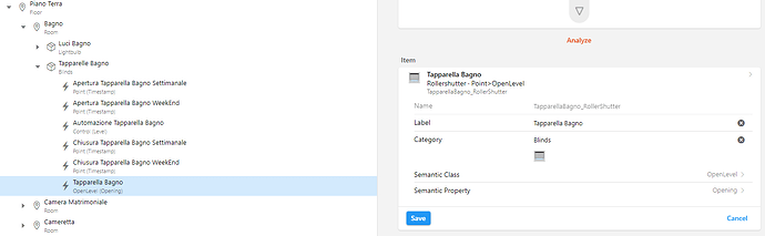

Sorry, no, I don’t see the Switch Item in the blinds group, please see below, name and label of Item is just an example.
A Switch item to enable/disable the automatic/time control [mandatory]
Label: Timecontrol blinds childroom
Type: Switch
Category: Switch
Semantic Class: Control
Semantic Property: Level

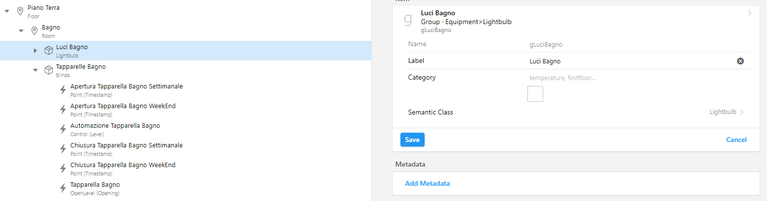

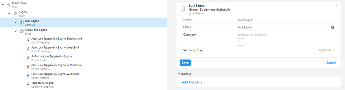

Why postinng lights ? this has not changed and you had it working before.

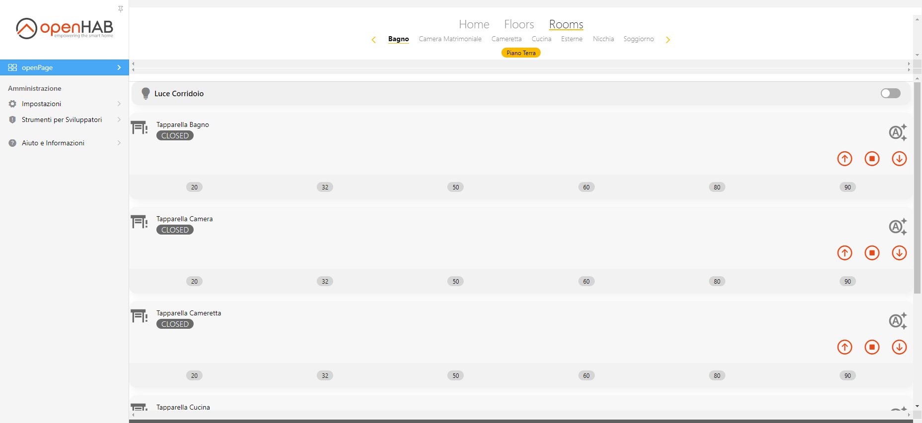

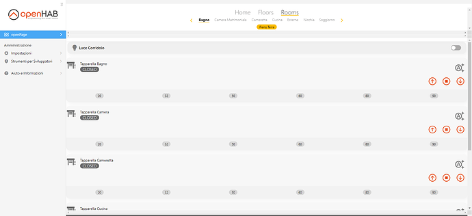

sorry a mistaken screen for lights (that are not working due to main widget line to be changed…)

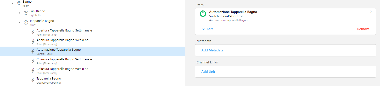

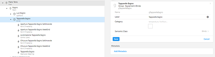

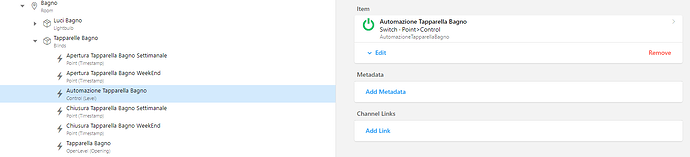

by the way, yes, the switch item is there:

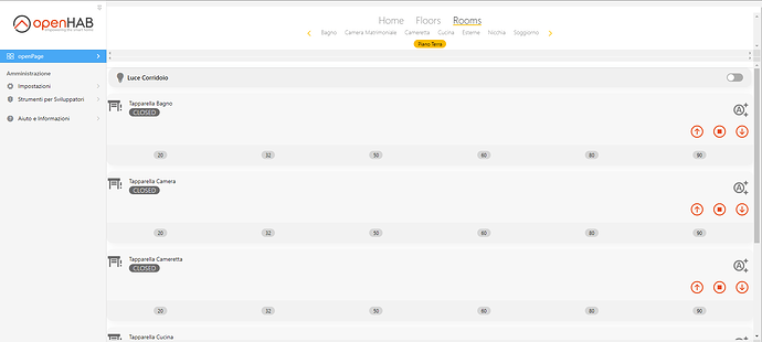

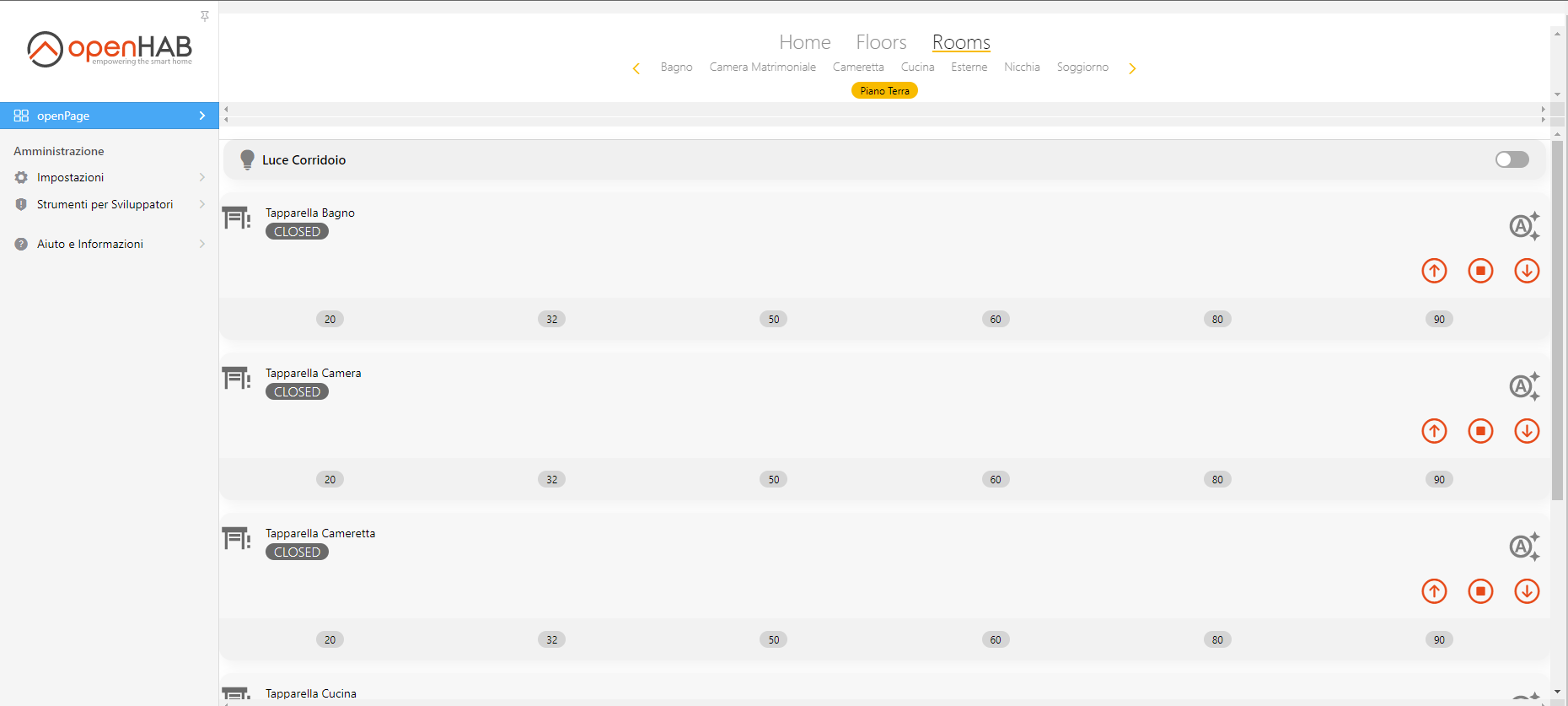

the widget are displayed but not filtered by room. if i chose Bathroom (Bagno) i see all my rollershutter widgets off all rooms. so rollershutters are not divided into rooms…
What do you think needs to be changed in main_widget ? It is working like before
Strange, as it is working here with the latest published code
Did you update main_widget and add “FloorsAndRooms” ?
yes, of course, just 2 days ago :slight_smile:
                - component: oh-repeater
                    fetchMetadata: semantics,metadata,listWidget
                    filter: loop.equipmentItem.metadata.semantics.config.hasLocation == vars.objVar.room
                    for: equipmentItem
                    itemTags: Blinds
                    sourceType: itemsWithTags
this solved my issue to display correctly rollershutter widget divided into single room. i don’t know if this is wrong, but it works. can you give a look?

No, this is wrong, correct would be (and is in the published version)
                    filter: loop.equipmentItem.metadata.semantics.config.hasLocation == loop.roomItem.name
                    for: equipmentItem
                    itemTags: Blinds

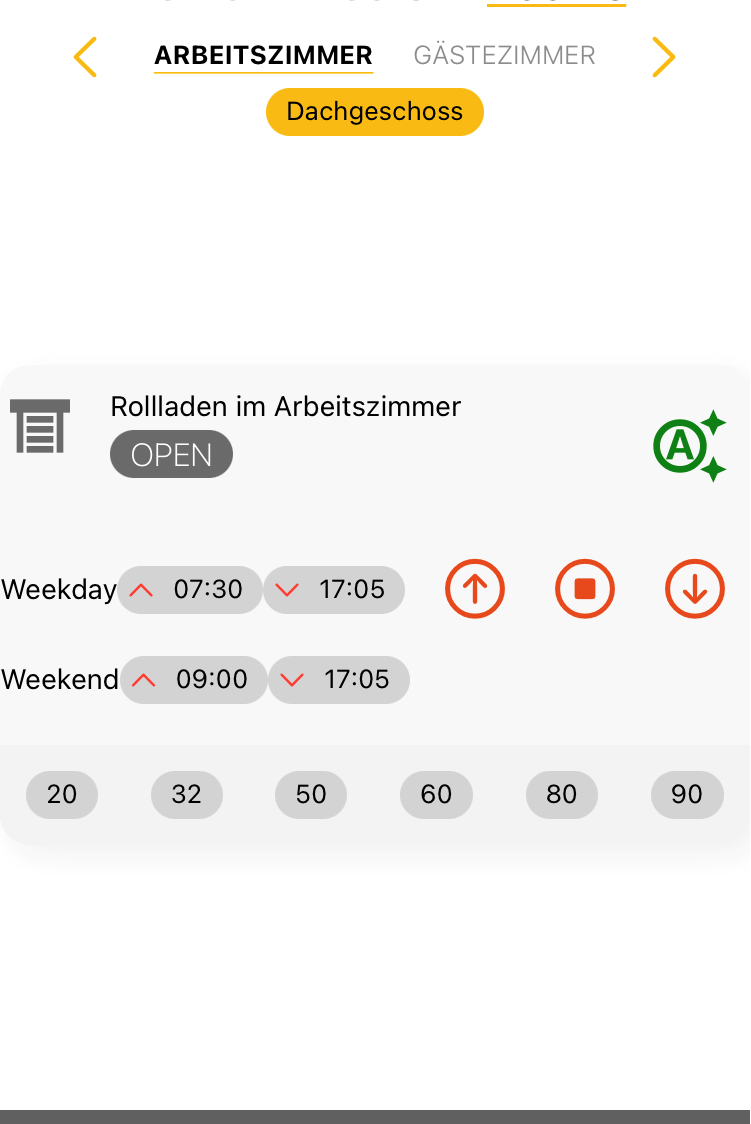

This is the code I am running, giving the earlier posted result.

i know this is NOT the one published, but what i mean, the published one is making not filtered my roller widgets. changing the line as i posted (taken from previous version of your widget) make filtering correct.
maybe mistake is somewhere else, but this solved the issue. that’s why i asked you to check deeper what’s wrong.
This is difficult to debug, as I cannot reproduce that behaviour.

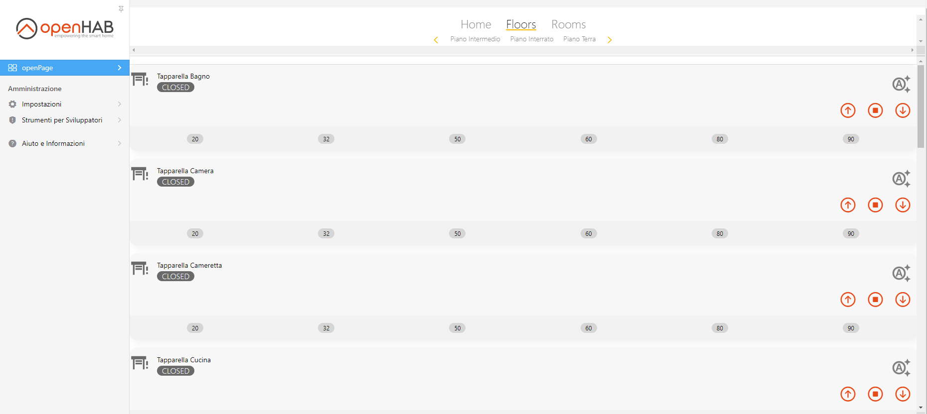

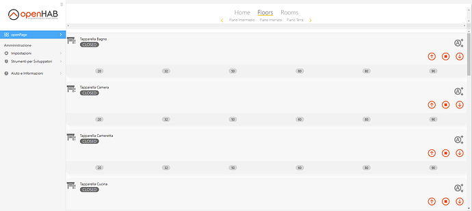

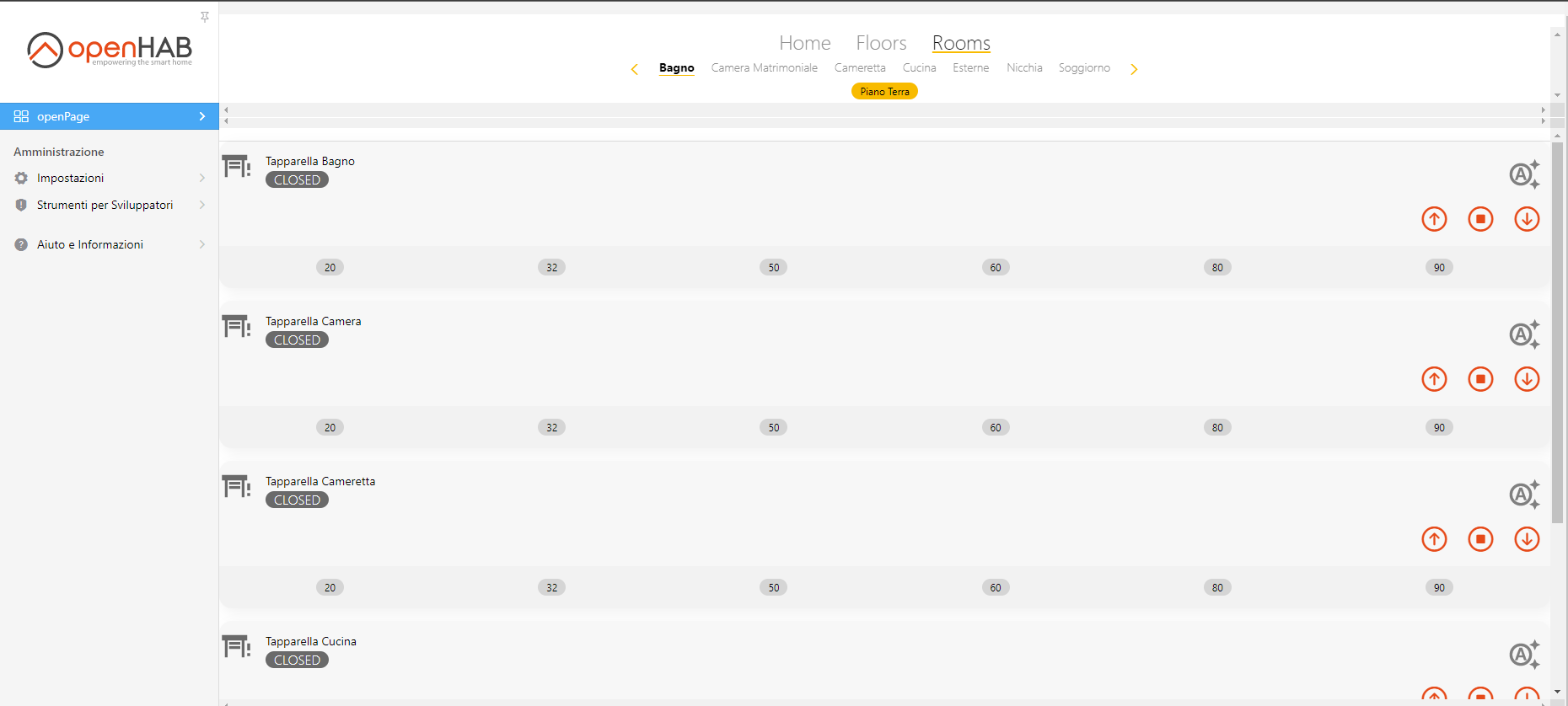

Can you please post some screenshots
  • after pressing floors top menu
  • after selecting a floor
  • after selecting a room
@All

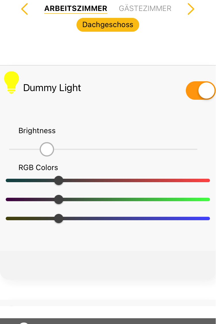

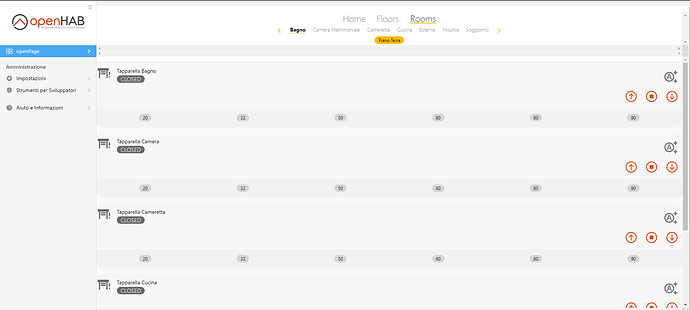

I have just updated the Lights cards, which I forgot two days ago. Also updated the screenshot to see the new color control.
This should fix the latest reported issues.
Sorry for any inconvenience.
This is also when selecting Shades below.
