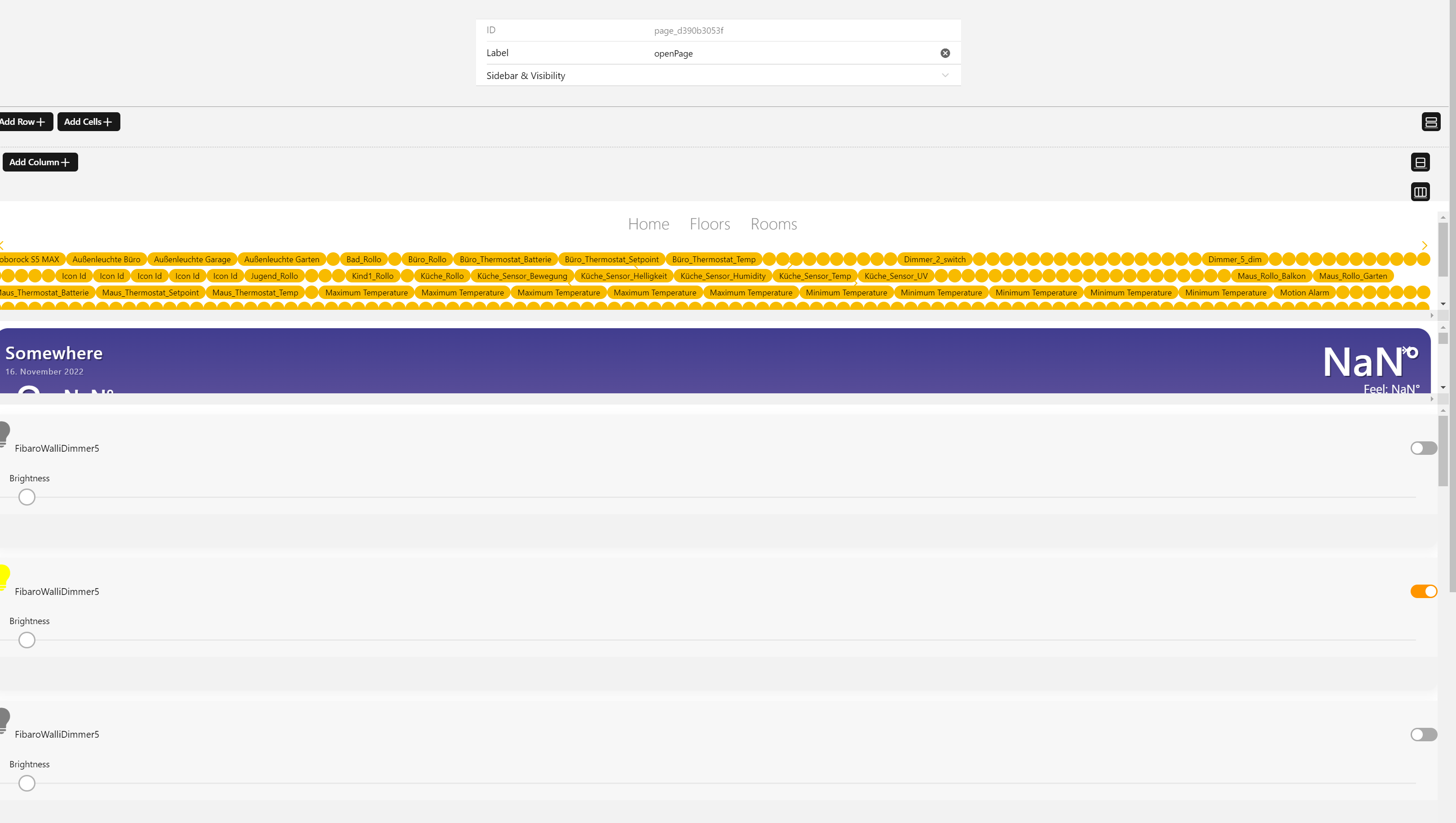

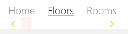

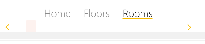

If i test the openPage, i can click the menu, but i dont see the floors nor the rooms. But if i click, i open real rooms and i see the equipment of the room. But i cant see the name of the rooms/floors in the navigation. The red square is my mouse position.
When i edit the openpage, the menu looks like this.
Last but not least, every light is shown three times in the widget, but only one of these lights can controll the real light.
I hope you can understand my writings. And i hope to hear from you.

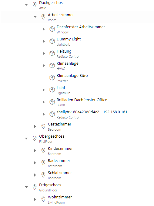

You need to create floors and rooms in the model, not just an entity “FLOOR” and an entity ROOM.
Please see this screenshot:
So You will have
  • Group->Location->GroundFloor
    • Group->Location->LivingRoom
    • Group->Location->Kitchen
  • Group->Location->FirstFloor
    • Group->Location->Bedroom (child)
    • Group->Location->Bath
    • Group->Location–>Bedroom (parents)
and so on…

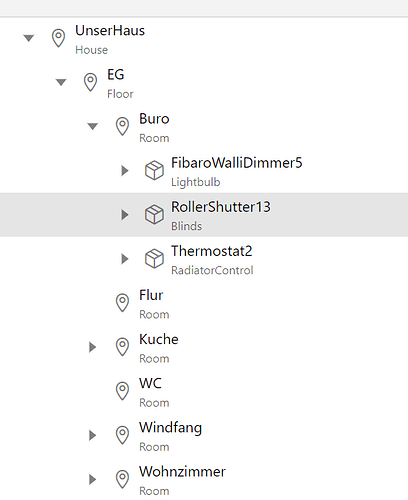

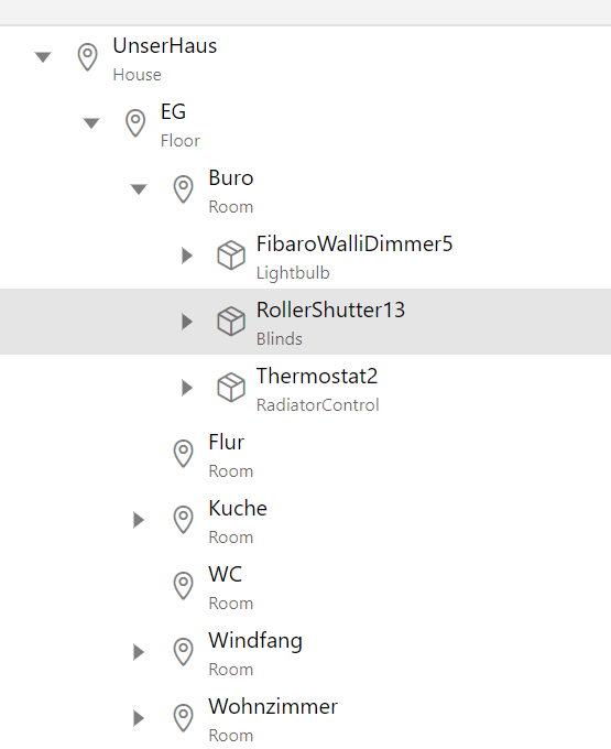

Thats my model, how is it empty?
Ok, better than youposted earlier.

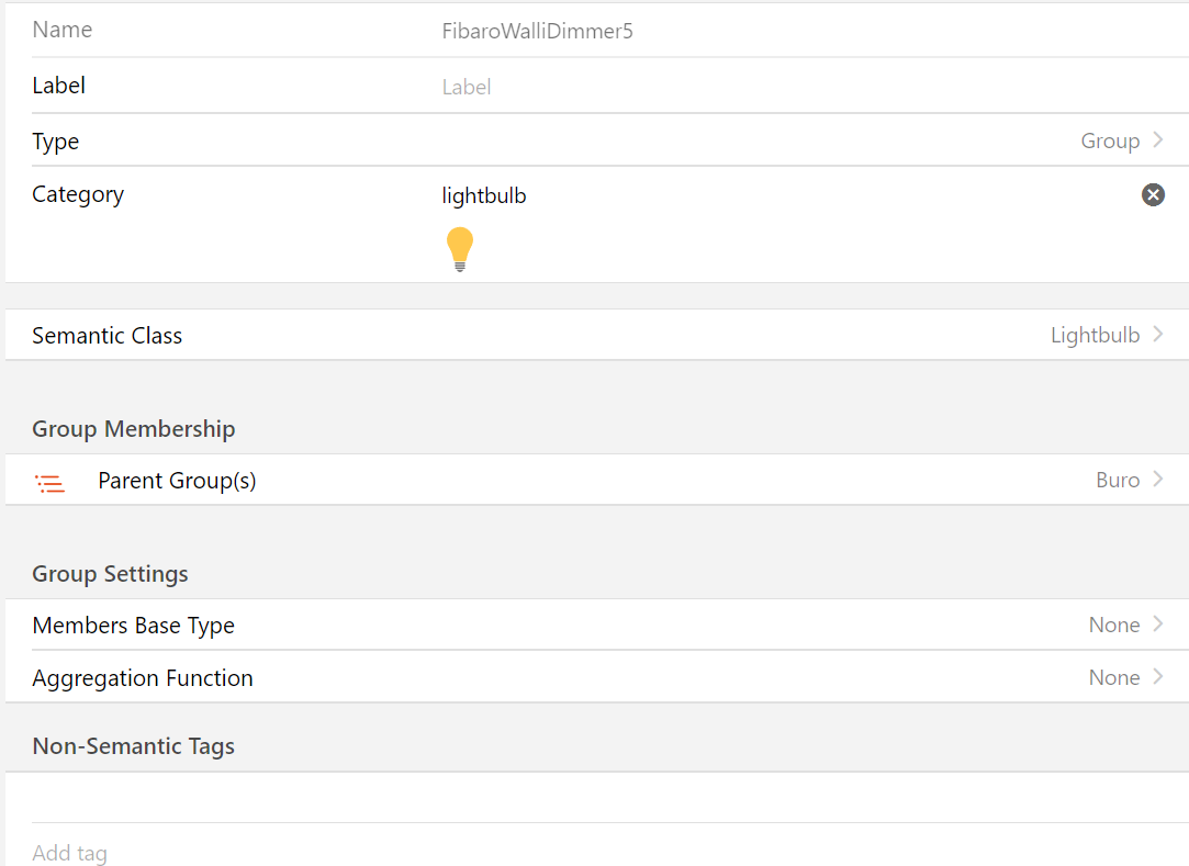

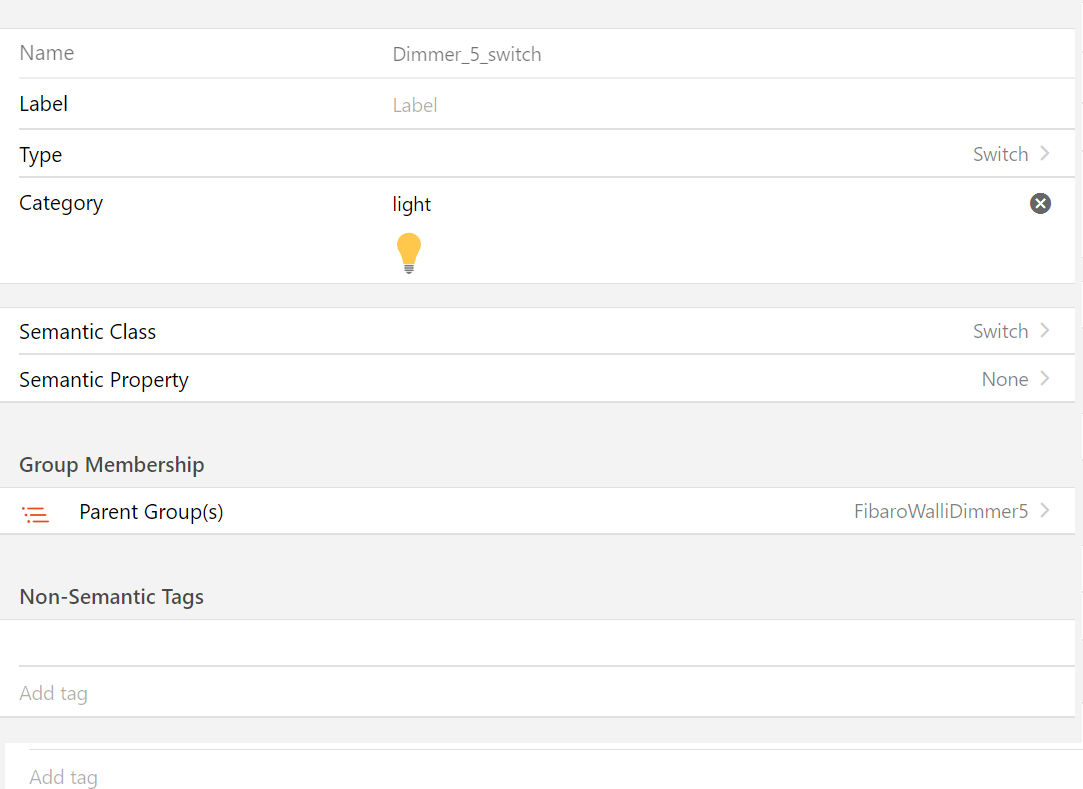

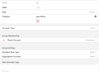

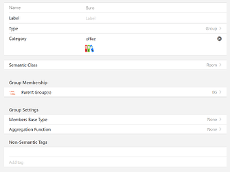

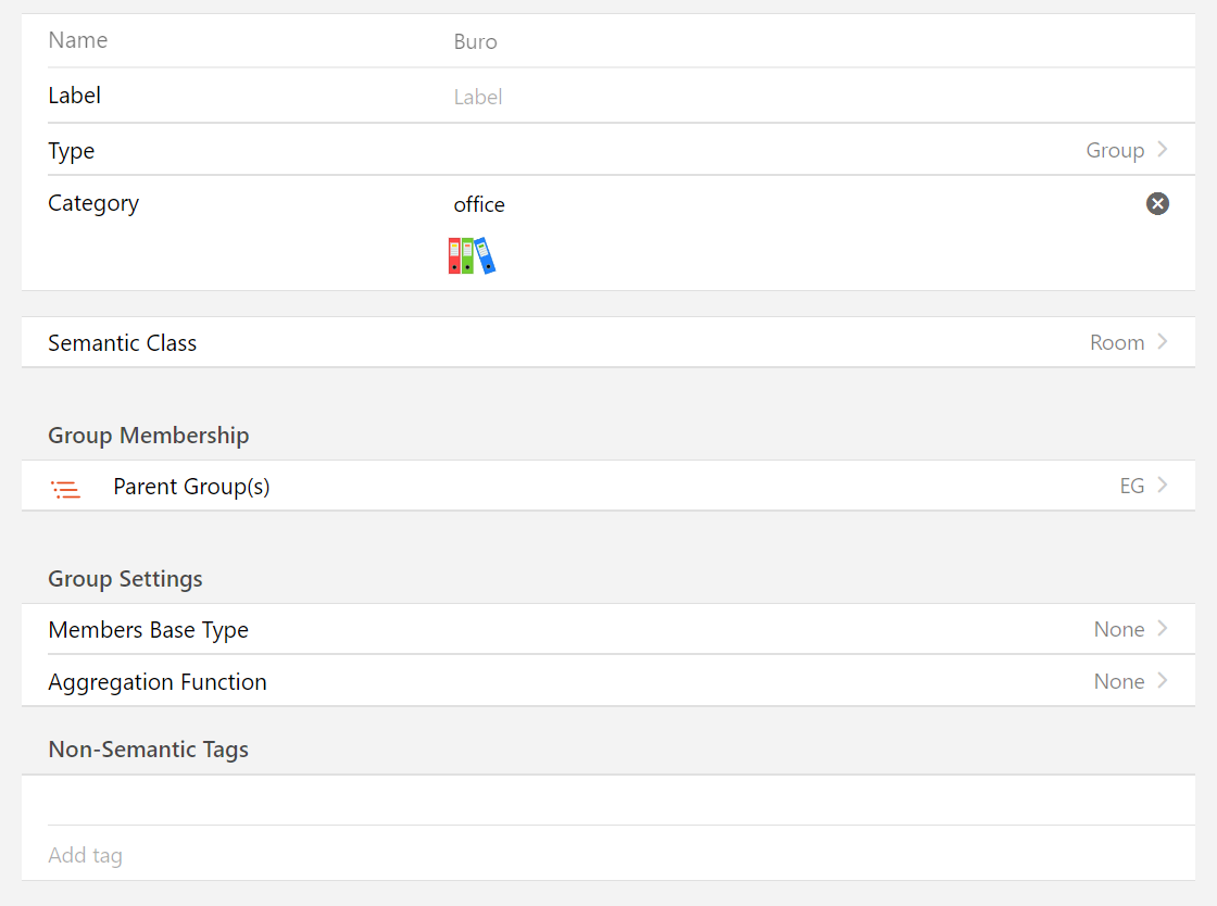

We need to see the details for one floor, room and an equipment.

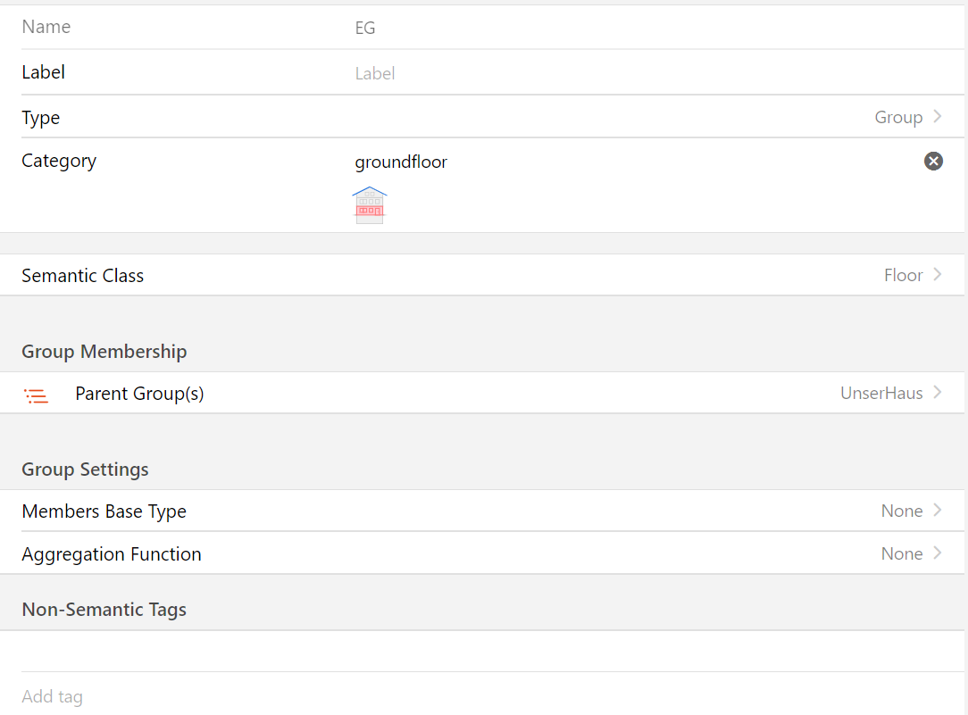

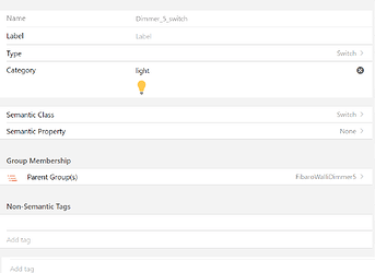

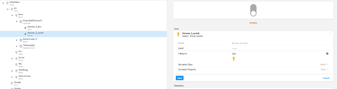

Thank you for your response, I made some screenshots. I hope they help you.
Could it be, that you did not set a single floor or room label in your modell.
I only see empty placeholders „Label“.
Yes, it’s still in progress, do I need the labels set? For floor, room and equipment? Or only floor, room? I will try it!
/edit rooms are showing. I go on testing, thank you @hmerk!
