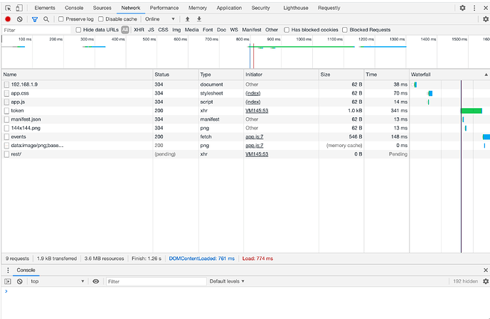

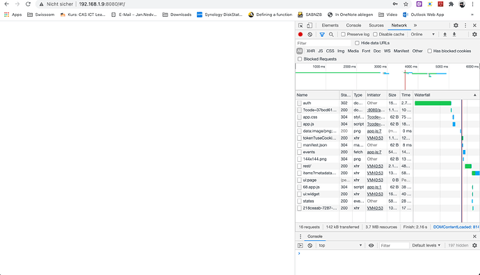

Hej Yannick
To be honest, I have no idea what to look for… Therefore I activated Developer Tools in Chrome, cleared the application cache and made a screenshot, what it showed after login with admin login:
hope that helps…
Thanks a lot
Jan
I have updated to Build #2148 and experience the same behavior. I checked all kind of logs, but couldn’t find any reason. Page loading stops with rest/ (pending) xhr app.js:9
