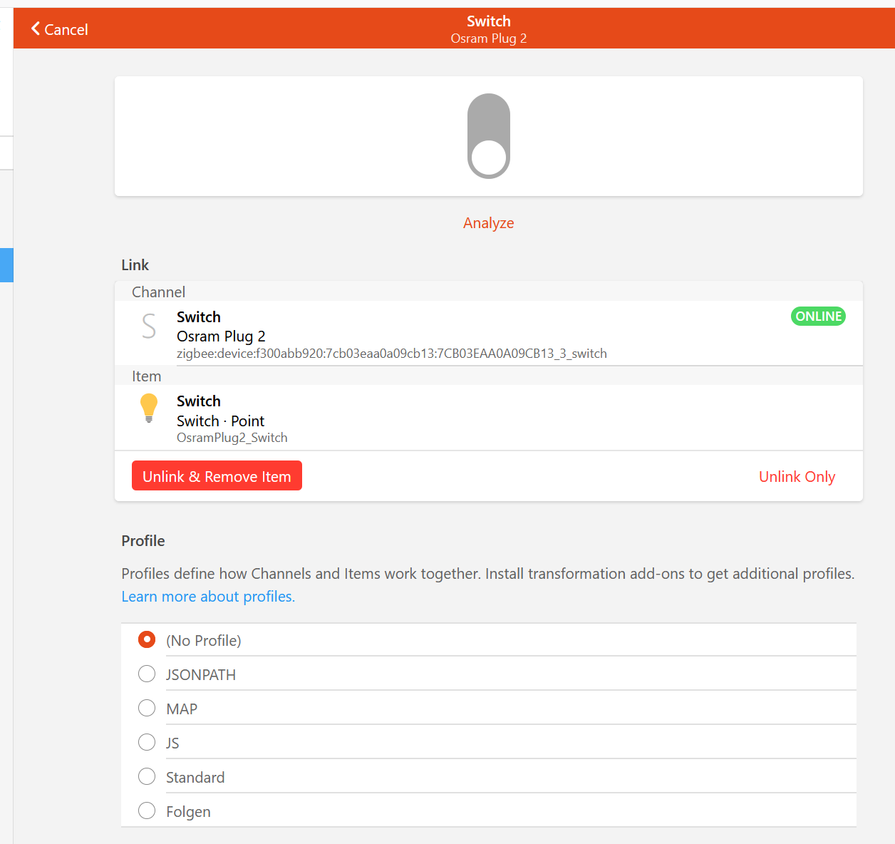

I use openhab 3 with openhabian on a raspi. I’m currently trying to integrate my Osram plugs via Zigbee Binding using PaperUI.
Via PaperUI i can turn the plug on. But when I try to turn it off, I get this message: Please specify a function and a source format for this Profile in the ‘function’ and ‘sourceFormat’ parameters. Returning the original state now.
In the console i can easily switch it On/Off: openhab:send OsramPlug1_Switch OFF
How can I implement this in PaperUI?

Sorry, i meant the normal graphical user interface in OH3.
Here is a Screenshot:
OsramPlug1|690x462
OK, that’s openHAB 3 with its MainUI.
Can you go a level deeper on your Channel that isn’t working, and show us that configuration?

The Switch above is working only from off to on.

The Plug works well if i define the item in a textfile:
Switch OsramPlug1 “OsramPlug 1” (gOsramPlugs) { channel=“zigbee:device:f300abb920:7cb03eaa0a0a2f3f:7CB03EAA0A0A2F3F_3_switch” }
I also tested a second Plug, the same result. I just want to understand why it doesn’t work.
