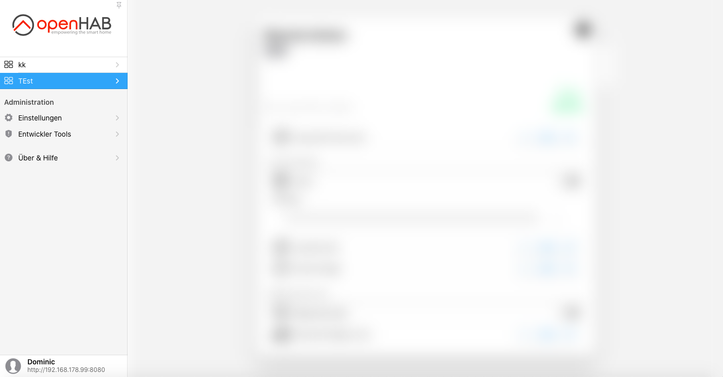

Hmmm. First of all: thank you.
I think, what I am looking for is a expandable card. I tried several ones - but the only thing I get is a blurred screen:
I used this code (found in the forum):

Do you have an idea, what’s going wrong here?
