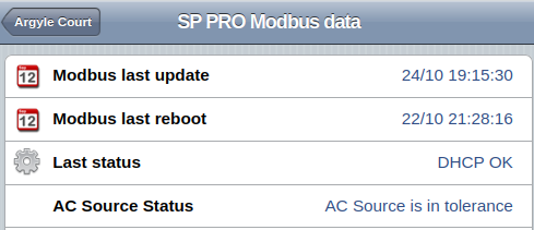

HabPanel: I may have identified the wrong tech; I have one panel on the wall, where I can’t remember how I did it (yonks ago).
I use only the classic UI:
