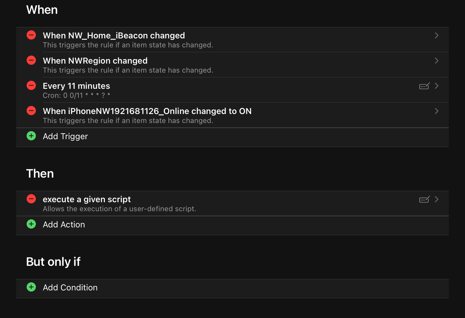

To recreate my rules I added the triggers to the ‘When’ area and thought it was ok to add the part of my existing rules as a DSL script to the ‘Then’ area. From my experience this has caused my instance to work initially however over several hours become unresponsive and eventually crash.
I have around 6 or so rules triggering when various people enter/leave locations, turning on/off stuff and sending notifications.
To get my instance stable I disabled the rules, by pressing pause. For nearly two days now my instance has been running smoothly, no errors ect.
