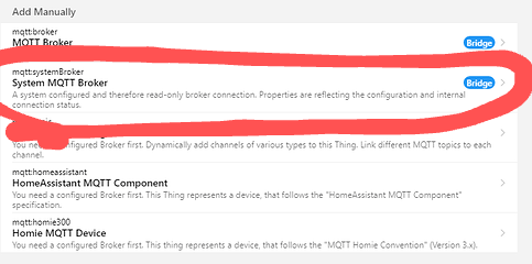

If you have a mosquitto broker, was do you install another broker (the System broker)?
The OH “System Broker” isn’t a mqtt broker itself, rather it is a default, read-only connection to a separate mqtt component (mosquitto in my case), which the OH MQTT binding brings with it, cannot be turned off/removed, and which leads to a Thing being automatically generated to represent this default/system broker connection.

Perhaps I’m not understanding a nuance here, but why not use the MQTT Broker Thing, instead of the System MQTT Broker Thing? Isn’t System MQTT Broker Thing a relic from when the MQTT Binding shipped with an internal MQTT broker? As OH3 doesn’t ship with this internal MQTT broker anymore, I don’t know what System MQTT Broker does…
I do not know why the MQTT binding comes with that system broker concept - what I can see is that it’s there (on top-level settings screen), and that it doesn’t work in OH3.

The system MQTT broker no longer exists - OH3 doesn’t come with an embedded broker.
The option for the System MQTT Broker Bridge Thing comes when you install the MQTT Binding, hence the issue needs raising in the add-ons section of GitHub!

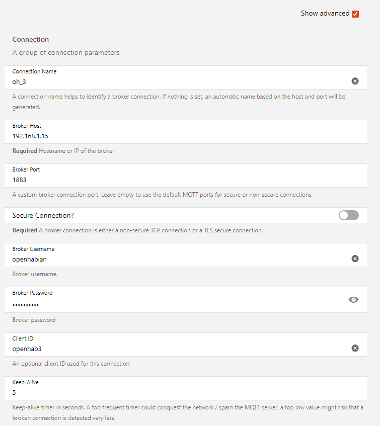

You set it up here
I keep getting connection reset by peer
Its working now
