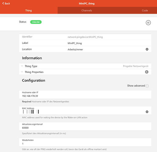

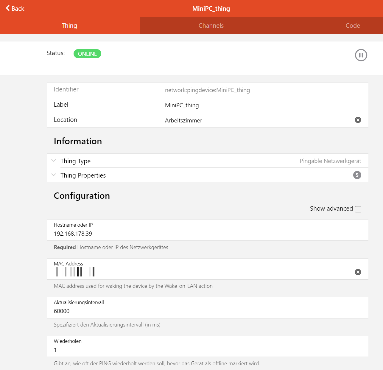

  2. I created a thing called ‘MiniPC_thing’ also using the UI:

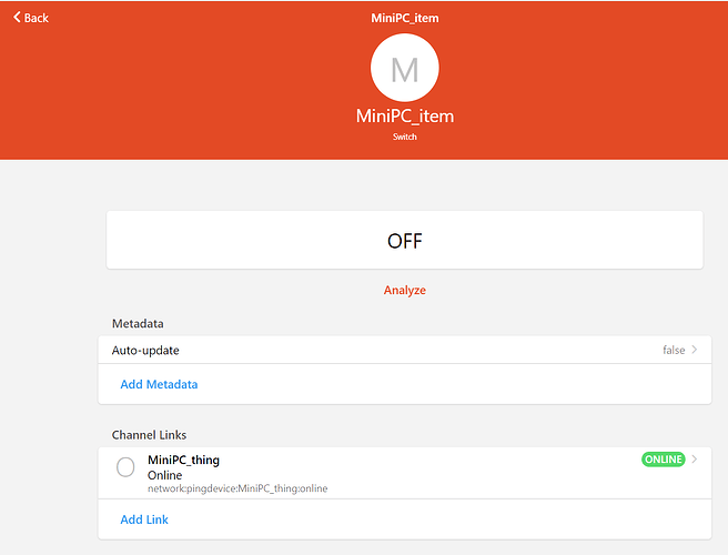

I set Auto-update to false using metadata, but now I stuck.
I thought if I create an item of type ‘Switch’ I get some switch-icon in the UI what I can use set to on and off for testing - but it just shows ‘OFF’ - no icon that I can really use.

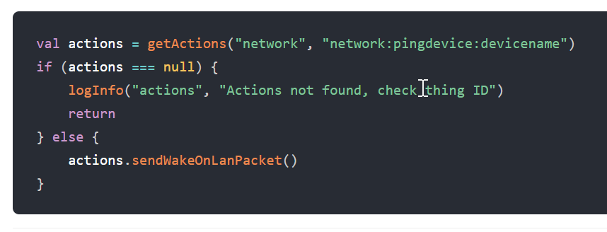

This is old syntax, for the V1 wake-on-LAN binding. It will not work in openHAB 3.
Wake-on-LAN can now be effected through the Network binding. See this section of the documentation on how to achieve this via a rule.
The tutorial that you are using will not work without modification, as it was written for the old v1 binding. See the latter posts in that thread for more information.

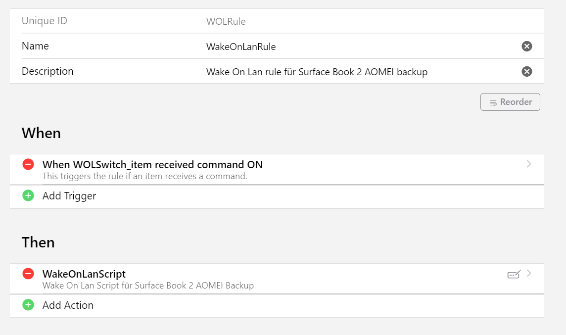

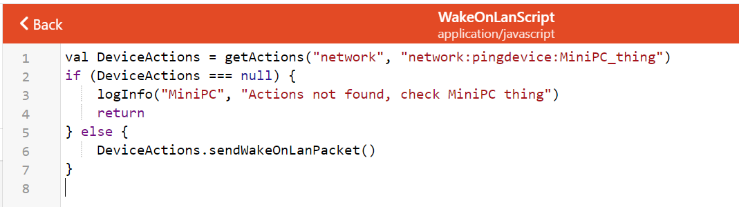

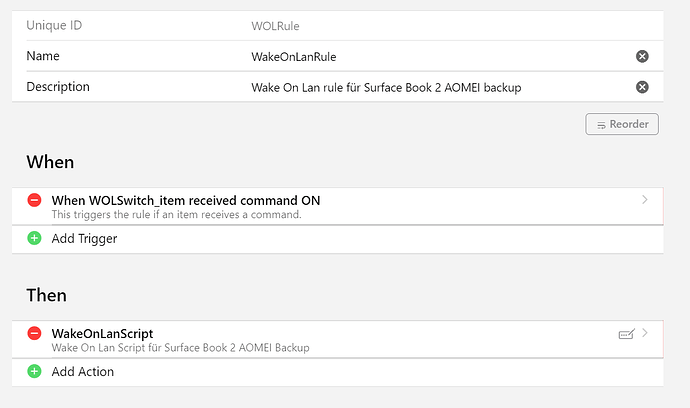

now I have a simple Switch item and created a rule using OH3 UI:
In the Then section I added a script:

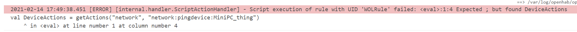

But if I run this script using the 'Run Now (Ctrl-R) inside the OH3 script editor I get following log in frontail:
What I am missing here?

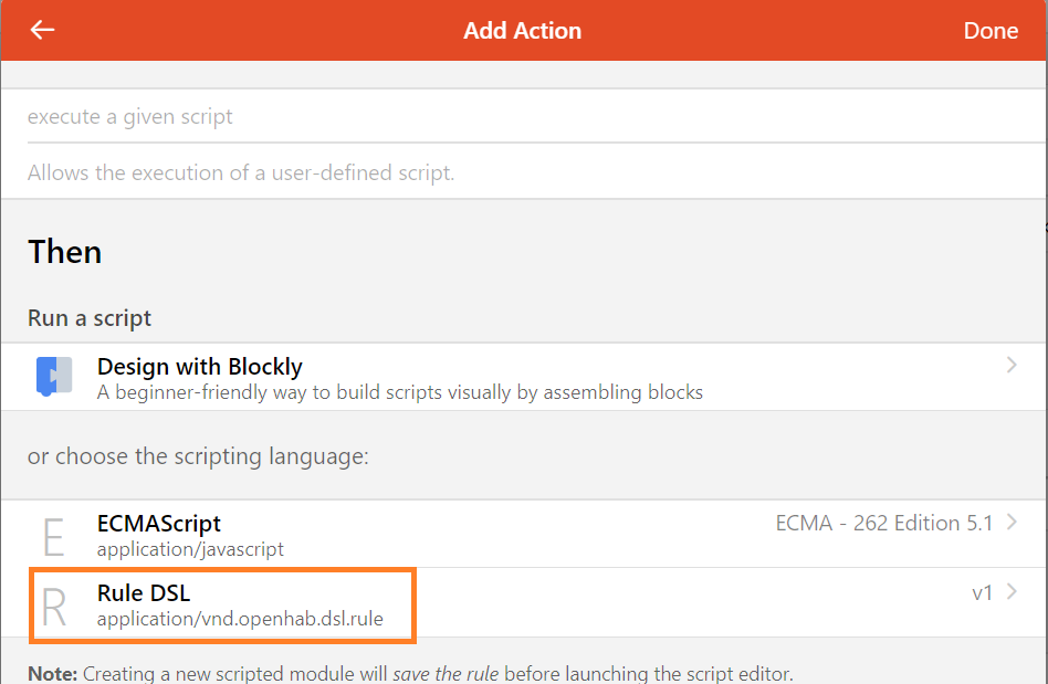

I think it’s trying to interpret your DSL script as javascript.
I found it by myself now, I chose the wrong script type, one must use ‘Rule DSL’:
Now it is working

First, read the network binding documentation carefully snd setup a network thing for your TV with the given MAC Address.
Then take the rule from the docs and modify it to your needs
val actions = getActions("network", "network:pingdevice:devicename")
if (actions === null) {
    logInfo("actions", "Actions not found, check thing ID")
    return
} else {
    // Send via MAC address
    actions.sendWakeOnLanPacketViaMac()
