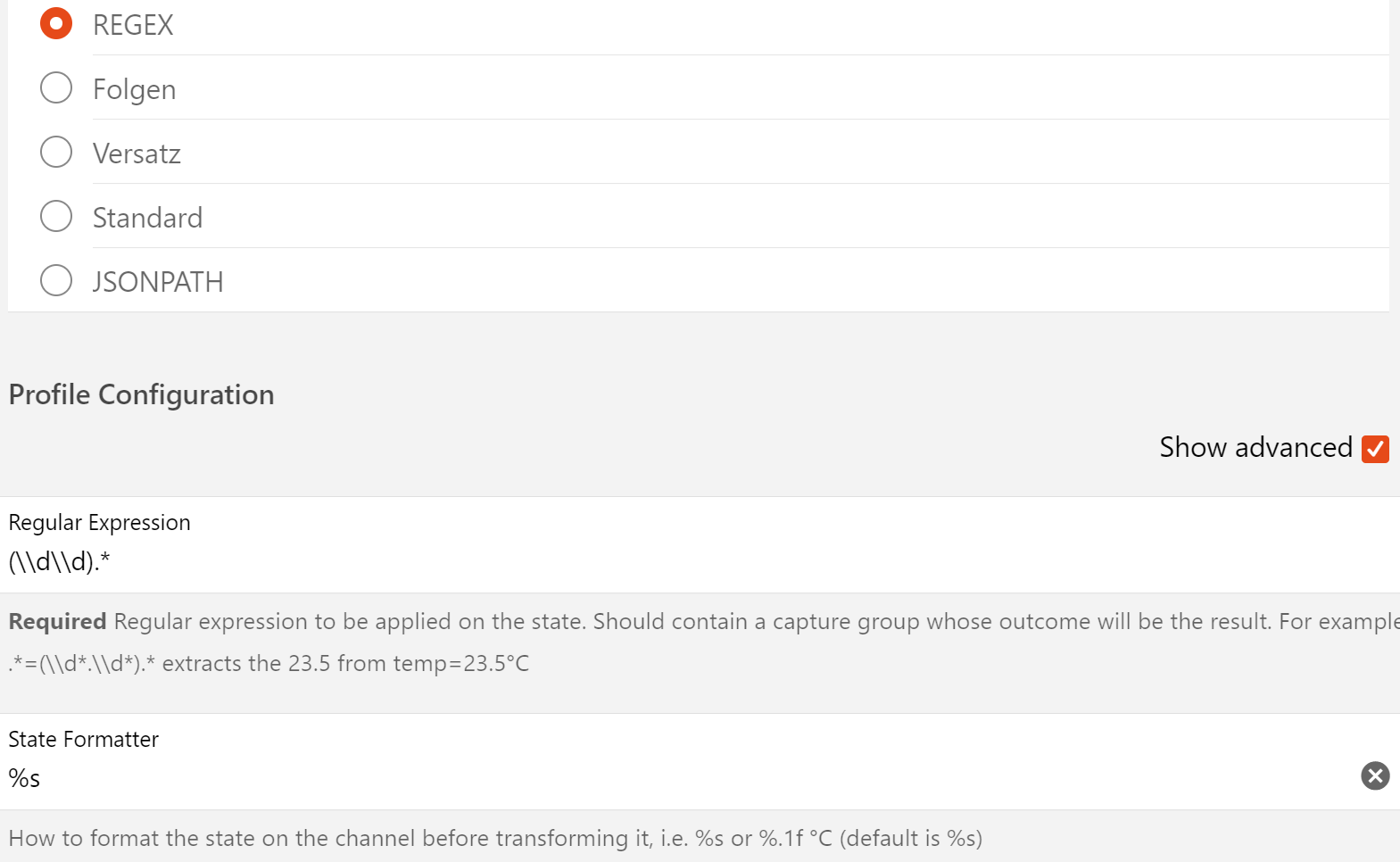

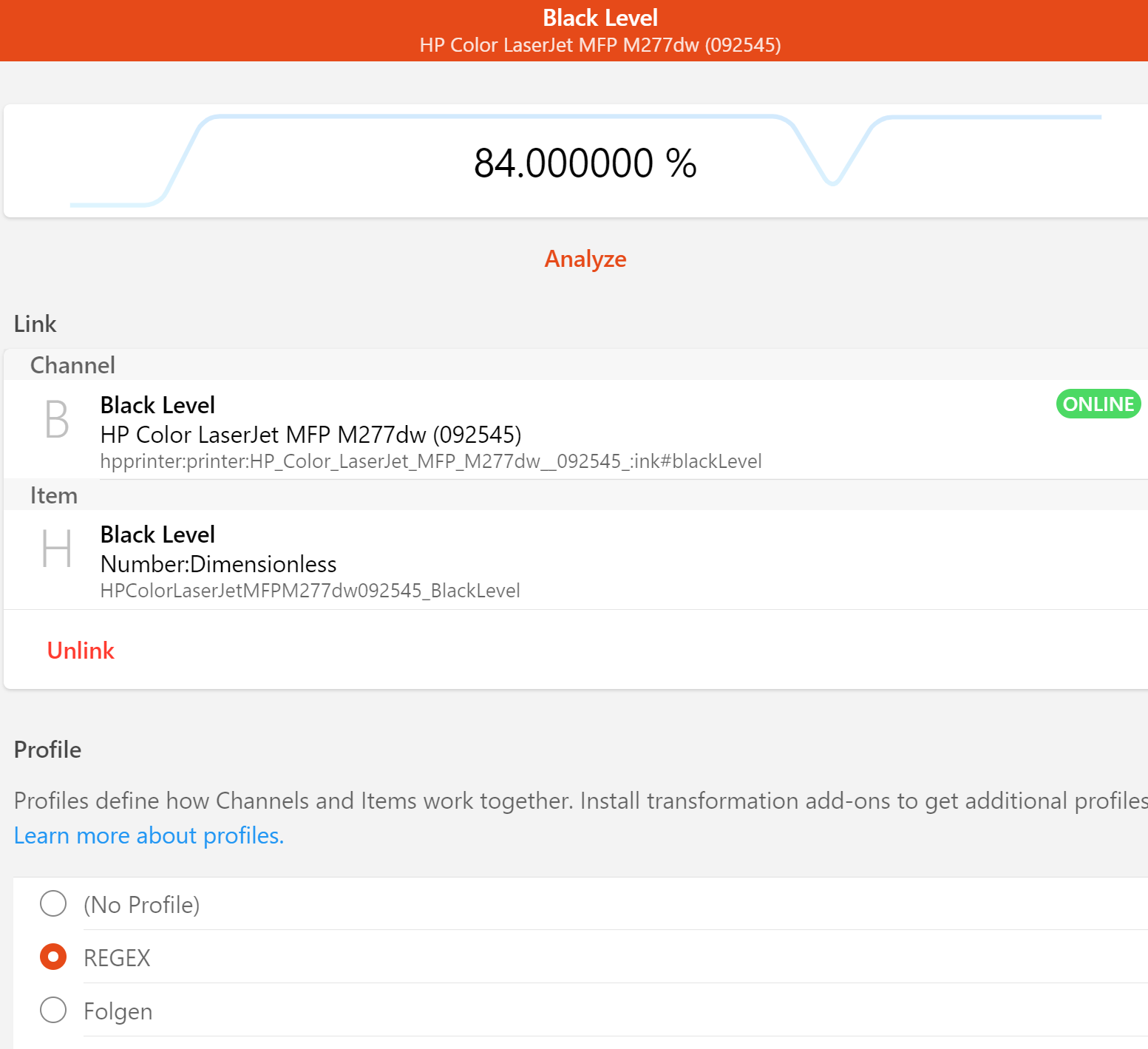

Here you are (concatenated picture):
I want the “84.000000 %” transformed to a “84%” in a gauge or lable card widget on a layout page. BTW: the gauge widget shows correctly 84 percent of the circle.
As I wrote, I tried several item configs and profile reg expressions. Some warning examples here:
[WARN ] [.profiles.RegexTransformationProfile] - Could not transform state ‘85 %’ with function ‘.’ and format ‘%.1f %%’
[WARN ] [.profiles.RegexTransformationProfile] - Could not transform state ‘85 %’ with function '.
’ and format ‘%d %%’
[WARN ] [.profiles.RegexTransformationProfile] - Could not transform state ‘84 %’ with function ‘(\d\d).*’ and format ‘%.0f’
The one in the picture above shows no warning log, but I find no working regex to get the “84%” or at least “84” output. And yes, I also tried different escapes “\”.
That’s just an administrator view.
You don’t need any transformation,just a format
