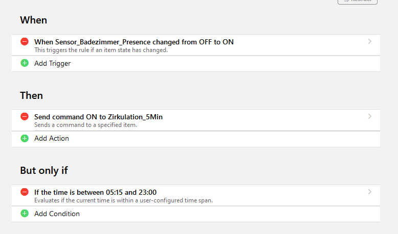

Thanks for your reply. The sequence is:
When MotionSensorBath turns ON
Then Turn pseudo switch Zirkulation_5min ON
Turning on that switch will result in the corresponding rule to be triggered, which is supposed to check if the pump (the actual switch for it is called Zirkulationspumpe) is OFF, and if that’s the case, it should check if the pump has already been turned ON in the past 25 minutes. If that is the case, it should not do anything. If it wasn’t turned on, it should turn it on for 5 minutes and turn it off after those 5 minutes.

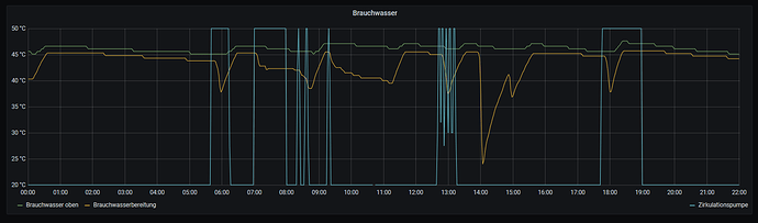

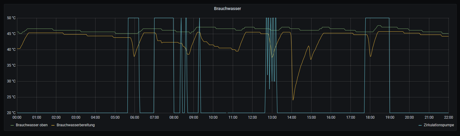

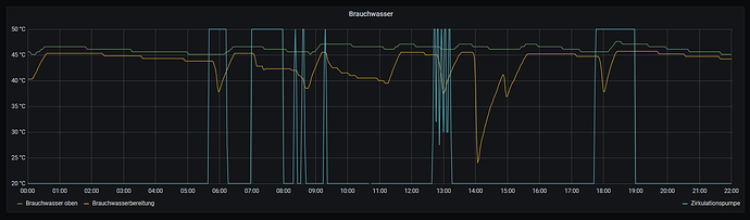

Yea, I have influxdb installed and openHAB persists quite a few items to it:
The blue “spikes” are from the Zirkulationspumpe item. At around 13h (1 pm) you can see quite a bit of turning off/on of the pump as I was testing..
So I guess there is data there. Maybe something did change in OH3, would be nice to find out if so and what did change.

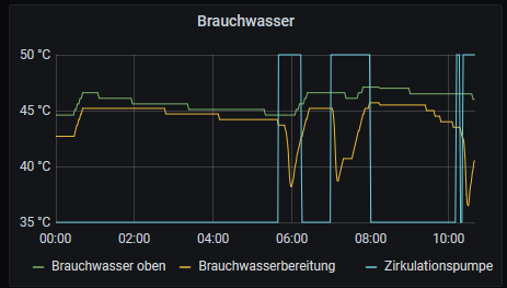

I think I just found out what’s wrong. In InfluxDB, the timestamps for the data are one hour behind. I’m not sure why that is, but at least Grafana displays the data with my correct time.
This is the current data for Zirkulationspumpe in InfluxDB (it’s 10:42 right now).
Grafana shows:
What’s going on? Is openHAB not doing some kind of timezone adaptation that it should be doing? I can’t seem to find where Grafana is configured to adapt the timezone..

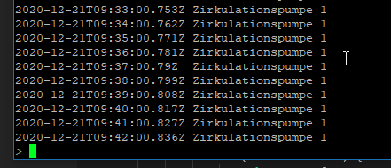

Looks like the timestamps are fine (the pump has been turned on after the first timestamp in this example of the log):

Ok, looks like I’m not the only one having the problem:
Hi Mario,
Sorry I miss your post during my research.
I am convinced our problem comes from influxdb persistence binding. Do you also have an influxdb v1 database?
Hi Olivier,
yea, I do have an influxdb v1 database. What to do now? :slight_smile:
Have you tried a different persistence service to make sure that it’s caused by the influx persistence service?
I think we shall open an issue against influxdb persistence binding.
Persistence of switch items works fine with rrd4j. It seems also to work fine with influxdb v2 but I didn’t try since migration from v1 to v2 seems not straightforward with docker.
Alright, I’m not sure what you expect to see but that looks like good data from an “everyminute” strategy.
We should bear in mind here that at the moment your rule runs, the current state of your Item may not yet be written to db, that’s a process that takes time.
There certainly are long-standing doubts about changedSince() effectiveness with Influxdb
I wonder if part of it is ambiguity over what it’s supposed to do - tell you if it’s different ‘now’ compared with ‘then’, or to tell you if it changed (and maybe changed back again) between ‘then’ and ‘now’.
