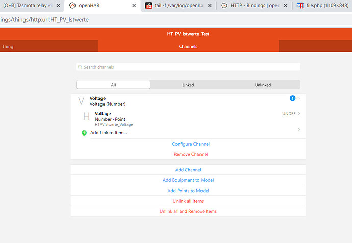

I did try that first, see the printscreen.
But this config always returns an error.
2021-02-09 22:28:25.217 [WARN ] [.profiles.XPathTransformationProfile] - Could not transform state 'UNDEF' with function '(number(//Measurements/Measurement[@Type='AC_Voltage']/@Value))' and format '%s'
If I use a string, I can get the value, but than I have to do the rules, I thought.
That’s using a profile. (That should work,but there is a bug.)
Apply your transformation directly in the HTTP Thing/channel of number type, link to a Number type Item without using a profile.
You could even add a unit of “V” in the number channel, and link to a Number:ElectricPotential type Item.
