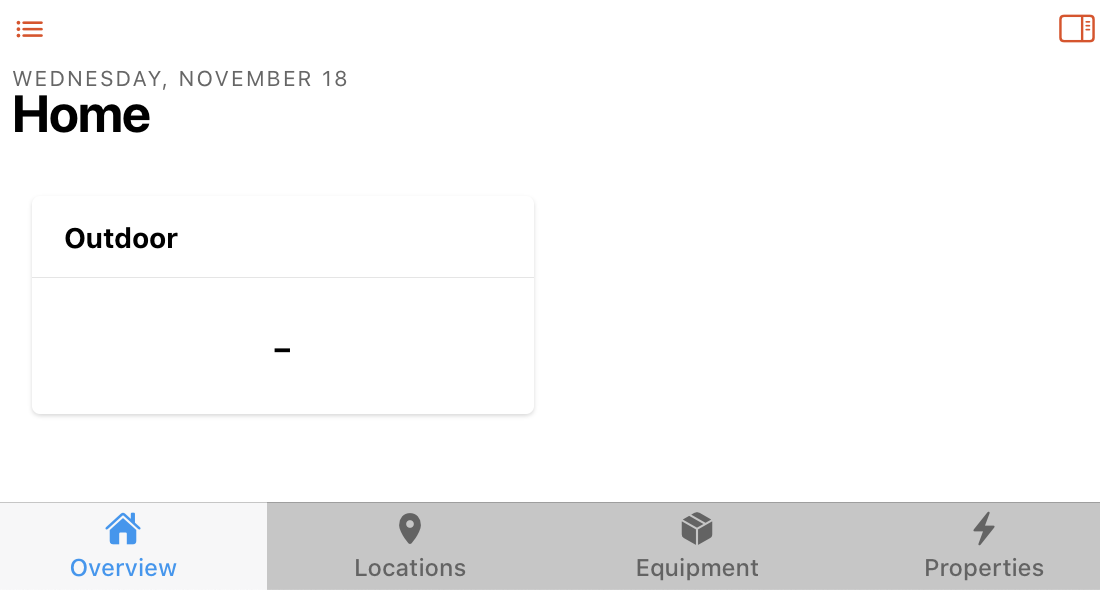

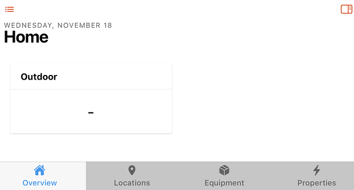

That said, in latest snapshots (I think #2012 forward) I’m always getting state as “-” for all items - screenshots from latest #2017 build, fresh install, added a single item:

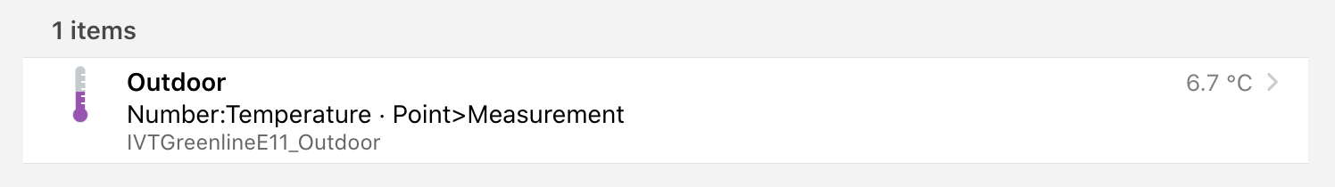

while in items section I can see the value:
Tried accessing page from safari and chrome with same result, if it makes any difference.

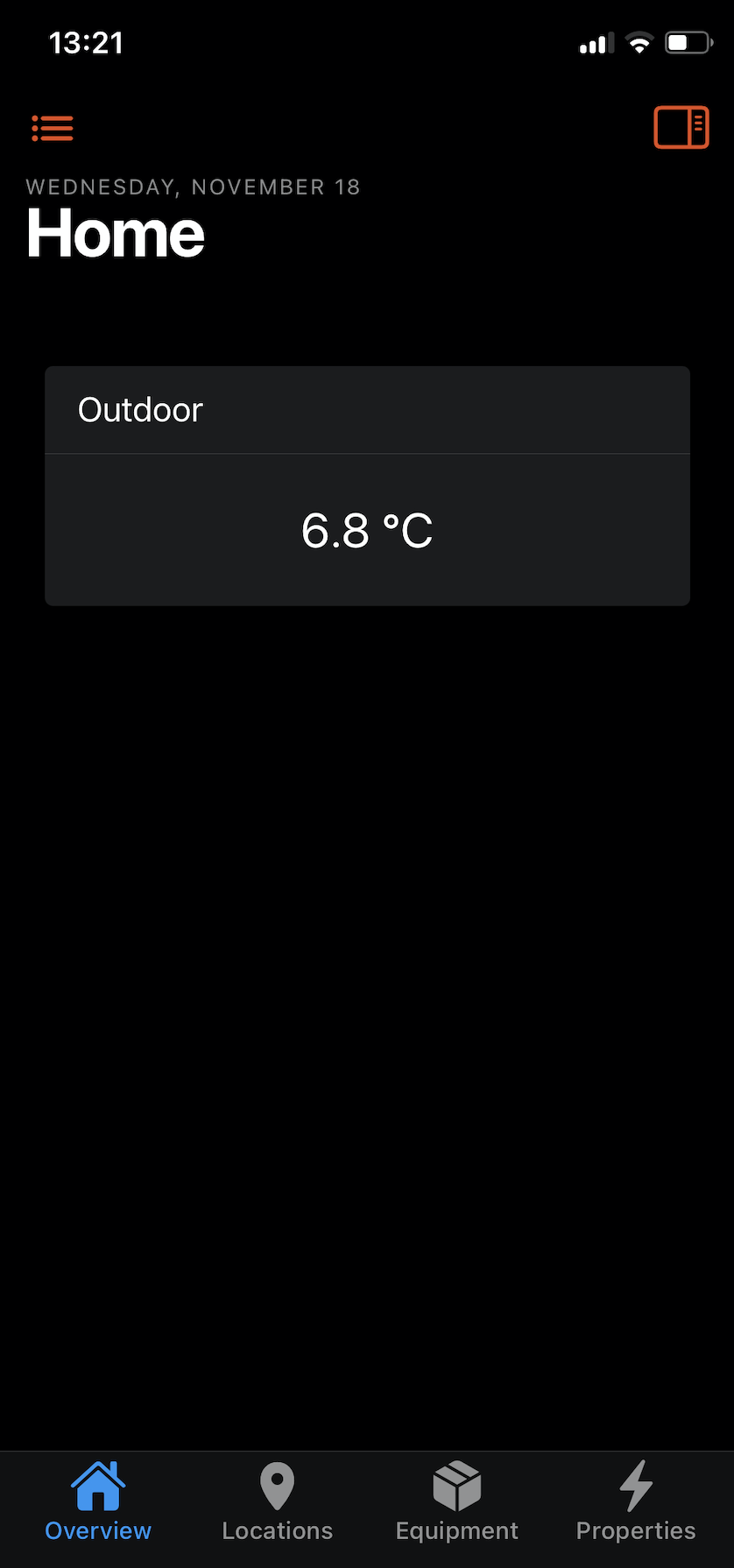

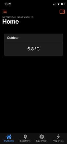

The funniest thing is, I can see it rendered fine on my phone :slight_smile:
Please let me know if others can reproduce the same or is there something wrong ith my setup - thank you!

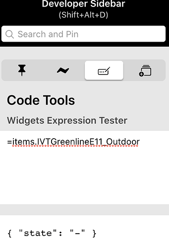

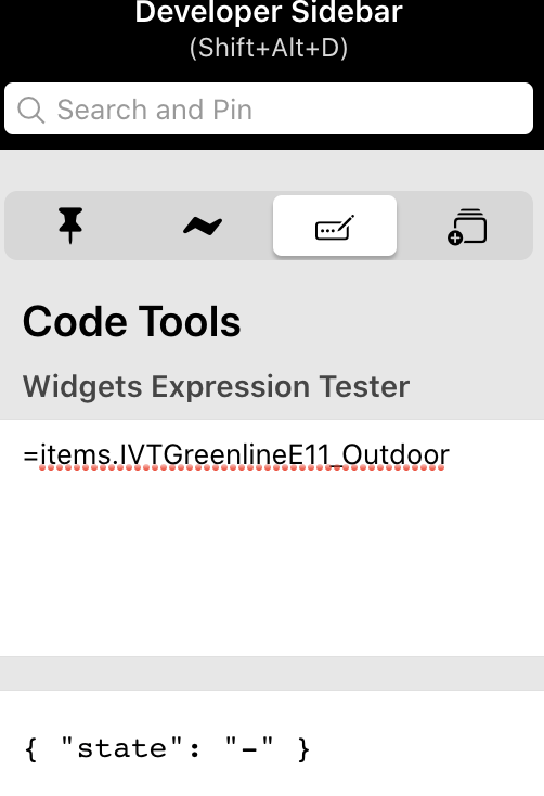

Sure your expression is correct ?
I Think it needs to be
=items.IVTGreenlineE11_Outdoor.state
I think =items.IVTGreenlineE11_Outdoor just dumps a json representation of item IVTGreenlineE11_Outdoor - so a single property state with value “-”.

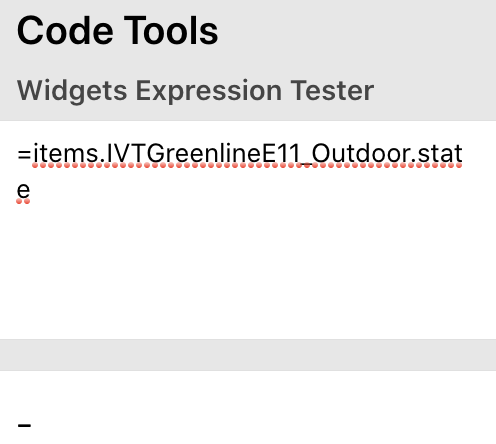

Nevertheless, I tried and got

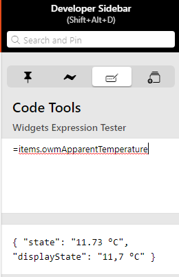

OK, rechecked and confirmed working generally :
There seems to be an issue when item name contains an underscore…
@ysc Is this already known and reported ???

Hm, it seems to be an issue when I access it from my mac(s), can reproduce the same from two laptops running macOS Catalina 10.15.6 and 10.15.7 … tried both safari and chrome.
Works from iPhone 11 and Windows 10 laptop :thinking:
