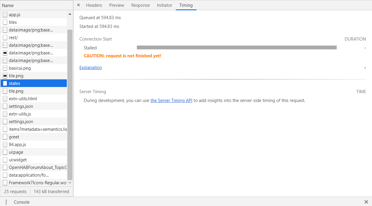

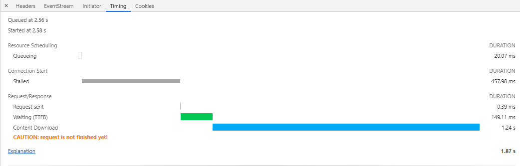

I have renamed this thread as the issue is to do with the requests for an SSE stream from REST API are not going through (see my post here).

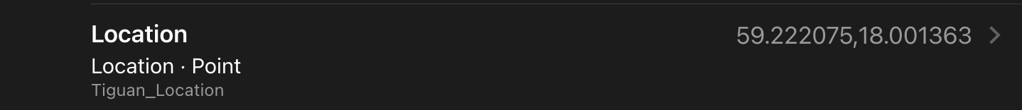

I started setting up stuff using my laptop. After fiddling around for a while, I got the Model and some Things and Items set up. However I did things, I absolutely could not get the Main UI to display Item states on cards. I could see their states in the Item config menu and HABPanel, but not on cards.

I have tried debugging the JS in Chrome to see when things go wrong, and found out a little: HABot (on the Main UI) returns the correct item, and the correct item states are being got from the REST API, but it seems that the cards use something else, which is not working.
