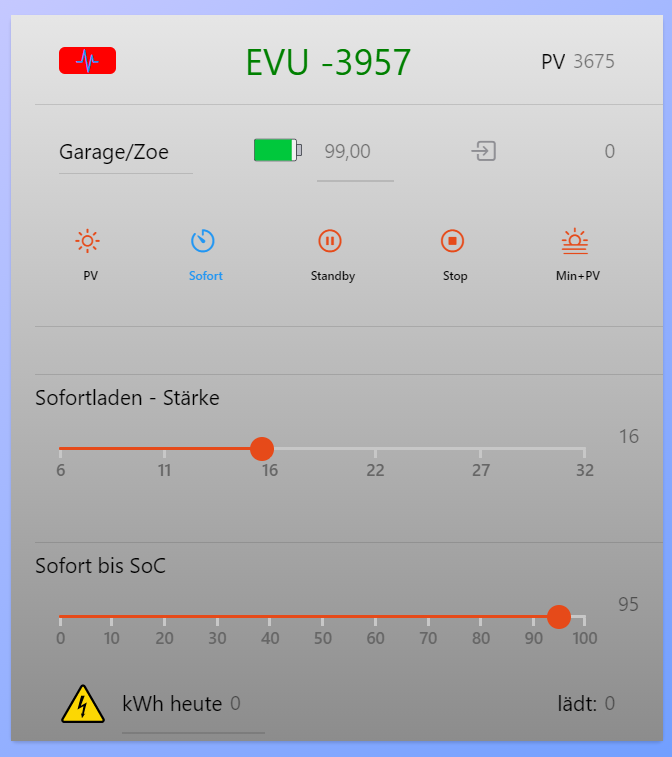

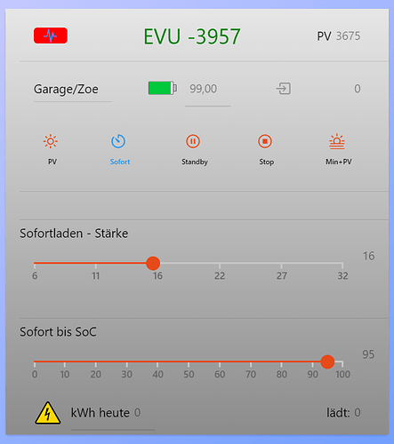

  1. Electricity generation and electric car settings (connected to openwb)
    First line: opens graph (1b), changes color when hovering above;; “EVU” changes color (negative = green, positive = red; meaning buying and selling electricity)
    a)Drop-Down with several action-items in a line
b) rather simple graph, when clicking on the red icon (upper left)

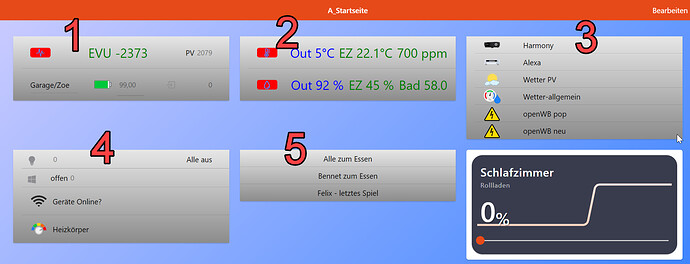

  1. Some basic climatic information (inside, outside); colors depend on values (e.g. red when hot or high CO2-ppm)
  2. Simple item buttons, but with icons and black text color

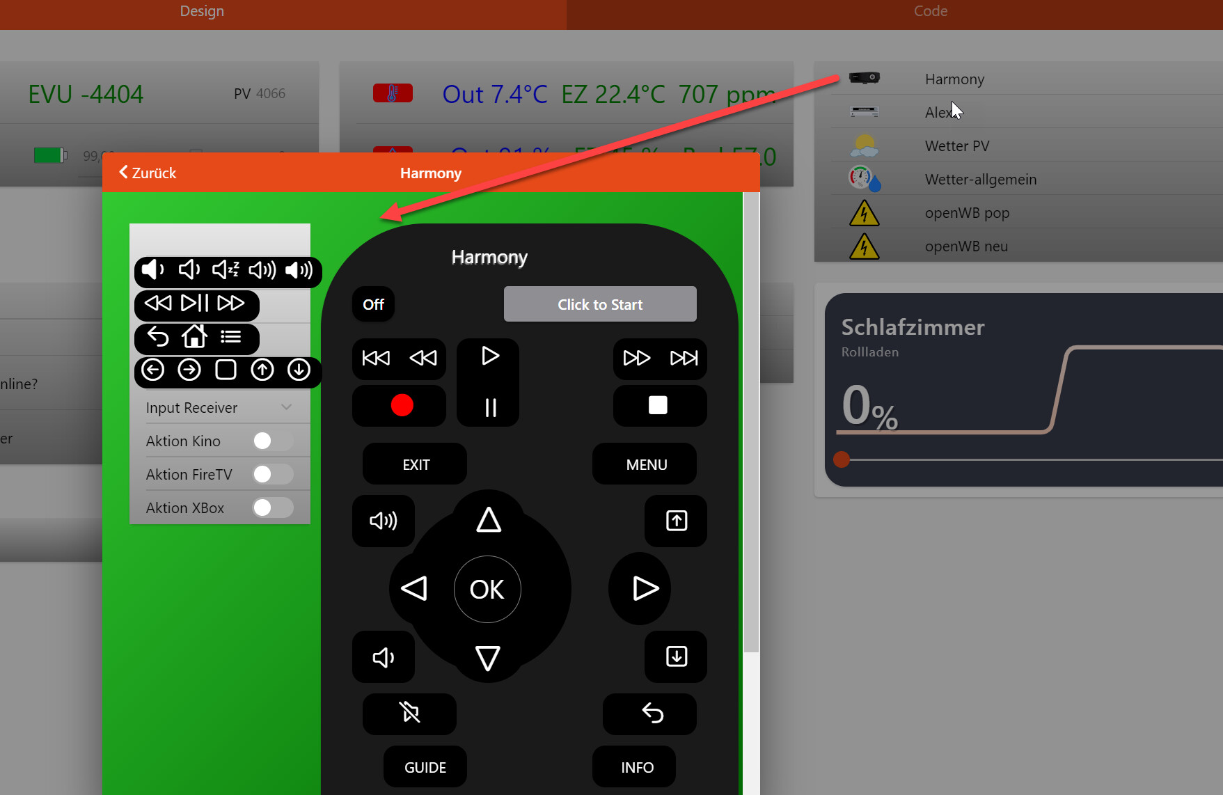

    a) Harmony Hub - media control
    Looks nicer on smartphones, where the remote control appears below the left section, not next to it. The remote control is a widget I found here: OH3 Harmony Widget - #7
    Because it doesn’t allow direct control of specific devices, I added the left part. Here I can control the receiver (loudness and Input) and the Fire TV directly. The three actions (Aktion Kino, FireTV, XBox) trigger Harmony-actions (e.g. turn on projector, receiver, Xbox and put receiver-input to Xbox). These can be triggered by Alexa-voice commands, too.

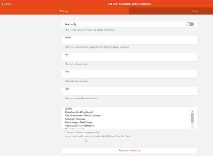

b) Alexa-output
Here I have some drop down-fields where I can tell which device should be used, the music source (playlists and radio-stations), some music information. Furthermore I can enter commands or text which will be send to the selected device (e.g. to call a kid -our house is quite large and this reduces shouting/walking)
  1. Controls for / information about lights, windows, connected internet devices, heat control
    a) Lights (took some work; repeater function is used…):
b) windows: shows open/closed windows and how many windows are open (similar to the “how many lights are turned on”-functionality

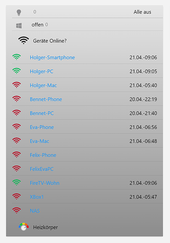

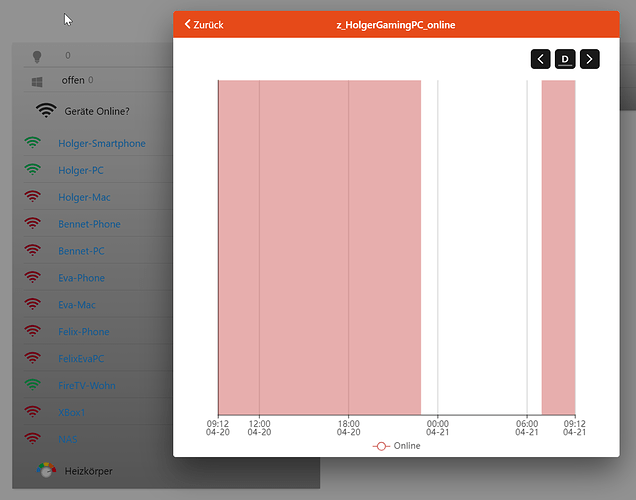

c) internet devices: which are online, offline, when were they last seen? I wanted a graph that shows online/offline times somewhat like this:
But since Ithat was too difficult for me, here’s the simpler solution:
Clicking on a device opens a graph like:
  1. Just simple buttons that trigger alexa voice commands (tell kid to stop playing, to come to eat), they can be triggered by voice commands, too.
The basic idea was to have one central site which offers most of the needed functionality with a maximum of one click. I intentionally didn’t use the standard overview page for that due to its limitations (e.g. no background colors)
So, if you’d like some more detailed information (especially the code) about some of these functionalities, let me know and I’ll post them here.
Next things to do will be:
  • add some devices for which I’d like to use Zigbee2MQTT but I still have trouble installing the zzh-hub correctly
  • add a calling list from the fritzbox, still struggling here too, but I’ll post here when/if I manage to get an acceptable solution.

  1. Electricity
component: oh-list-card
  accordionList: true
  noChevron: true
  style:
    background: linear-gradient(to bottom,#e6e6e6 0%,#8c8c8c 100%)
  default:
    - component: f7-list-item
        accordionItem: true
        content:
          - component: oh-button
              class:
                - margin
                - display-flex
                - flex-direction-column
              icon-f7: waveform_path_ecg
              iconColor: blue
              style:
                --f7-button-bg-color: red
                --f7-button-hover-bg-color: blue
                --f7-button-pressed-bg-color: blue
                height: auto
              action: navigate
              actionModal: page:z_EVU_PV
              actionPage: page:z_EVU_PV
          - component: Label
              text: =("EVU " + (items.openWBVerbindung_openWB_EVU.state))
              style:
                margin-top: 0px
                left: 0px
                font-size: 24px
                color: '=(items.openWBVerbindung_openWB_EVU.state < "0") ? "green" : "red"'
          - component: oh-label-item
              title: PV
              item: openWBVerbindung_openWB_PV
        accordionItem: true
        content:
          - component: oh-list-item
              title: Garage/Zoe
              icon: oh:battery
              iconUseState: true
              item: openWBVerbindung_OpenWBLP1SoC
              class:
                - margin
                - display-flex
              icon-f7: square_arrow_right
              iconColor: '=(items.openWBVerbindung_openWBLP1angeschlossen.state === "0") ?
                "gray" : ((items.openWBVerbindung_openWBLP1ladend.state === "1")
                ? "green" : "orange")'
              style:
                --f7-button-bg-color: transparent
                --f7-button-hover-bg-color: transparent
                --f7-button-pressed-bg-color: transparent
                height: auto
              item: openWBVerbindung_openWBLP1ladeleistung
        default:
          - component: f7-accordion-content
              default:
                    accordionItem: true
                    content:
                          class:
                            - margin
                            - display-flex
                          action: command
                          actionItem: openWBVerbindung_openWB_LP1_lademodus
                          actionCommand: ="2"
                          icon-f7: sun_max
                          iconColor: '=(items.openWBVerbindung_openWB_LP1_lademodus.state === "2") ?
                            "blue" : "grey"'
                          text: PV
                          textColor: '=(items.openWBVerbindung_openWB_LP1_lademodus.state === "2") ?
                            "blue" : "grey"'
                          style:
                            font-size: 8px
                            height: auto
                          class:
                            - margin
                            - display-flex
                          action: command
                          actionCommand: ="0"
                          icon-f7: timer
                          iconColor: '=(items.openWBVerbindung_openWB_LP1_lademodus.state === "0") ?
                            "blue" : "grey"'
                          text: Sofort
                          textColor: '=(items.openWBVerbindung_openWB_LP1_lademodus.state === "0") ?
                            "blue" : "grey"'
                          style:
                            font-size: 8px
                            height: auto
                          class:
                            - margin
                            - display-flex
                          action: command
                          actionCommand: ="4"
                          icon-f7: pause_circle
                          iconColor: '=(items.openWBVerbindung_openWB_LP1_lademodus.state === "4") ?
                            "blue" : "grey"'
                          text: Standby
                          textColor: '=(items.openWBVerbindung_openWB_LP1_lademodus.state === "4") ?
                            "blue" : "grey"'
                          style:
                            font-size: 8px
                            height: auto
                          class:
                            - margin
                            - display-flex
                          action: command
                          actionCommand: ="3"
                          icon-f7: stop_circle
                          iconColor: '=(items.openWBVerbindung_openWB_LP1_lademodus.state === "3") ?
                            "blue" : "grey"'
                          text: Stop
                          textColor: '=(items.openWBVerbindung_openWB_LP1_lademodus.state === "3") ?
                            "blue" : "grey"'
                          style:
                            font-size: 8px
                            height: auto
                          class:
                            - margin
                            - display-flex
                          action: command
                          actionCommand: ="1"
                          icon-f7: sun_haze
                          iconColor: '=(items.openWBVerbindung_openWB_LP1_lademodus.state === "1") ?
                            "blue" : "grey"'
                          text: Min+PV
                          textColor: '=(items.openWBVerbindung_openWB_LP1_lademodus.state === "1") ?
                            "blue" : "grey"'
                          style:
                            font-size: 8px
                            height: auto
                    accordionItem: true
                    default:
                      - component: oh-slider-item
                          title: Sofortladen - Stärke
                          item: openWBVerbindung_openWB_LP1_sofortladensollstromstaerke
                          min: 6
                          max: 32
                          step: 1
                          label: true
                          scale: true
                          unit: A
                    accordionItem: true
                    default:
                          title: Sofort bis SoC
                          item: openWB_LP1_DirectChargeSoc
                          min: 0
                          max: 100
                          step: 5
                          label: true
                          scale: true
                          scaleSteps: 10
                          scaleSubSteps: 1
                    accordionItem: true
                    content:
                          title: kWh heute
                          item: openWBVerbindung_openWBLP1Tagesladung
                          icon: oh:energy
                          title: "lädt:"
                          action: analyzer
                          actionAnalyzerItems:
                            - openWBVerbindung_openWBLP1ladeleistung
  1. Temperatures
  accordionList: true
  noChevron: true
  style:
  default:
        accordionItem: true
        content:
              class:
                - margin
                - display-flex
              icon-f7: thermometer
              iconColor: blue
              style:
                height: auto
              action: navigate
              actionModal: page:z_Temperaturen
              actionPage: page:z_Temperaturen
          - component: Label
              text: =("Out " + (Math.round((items.Netatmoaussen_Temperatur.state)*10)/10) +
                "°C ")
              style:
                margin-top: 0px
                left: 0px
                font-size: 24px
                color: '=(Math.round(items.Netatmoaussen_Temperatur.state) < "19") ? "blue" :
                  (Math.round(items.Netatmoaussen_Temperatur.state) > "22") ?
                  "red" : "green"'
          - component: Label
              text: =("EZ " + Math.round((items.NetatmoEsszimmer_Temperatur.state)*10)/10) +
                "°C"
              style:
                margin-top: 0px
                left: 0px
                font-size: 24px
                color: '=(Math.round(items.NetatmoEsszimmer_Temperatur.state) < "19") ? "blue" :
                  (Math.round(items.NetatmoEsszimmer_Temperatur.state) > "22") ?
                  "red" : "green"'
          - component: Label
              text: =items.NetatmoEsszimmer_CO2Gehalt.state
              style:
                margin-top: 0px
                left: 0px
                font-size: 24px
                color: '=(Math.round(items.NetatmoEsszimmer_CO2Gehalt.state.split(" ")[0]) <
                  "900") ? "green" :
                  ")[0]) > "1200") ? "red" : "yellow"'
        accordionItem: true
        content:
              class:
                - margin
                - display-flex
              icon-f7: drop
              iconColor: blue
              style:
                height: auto
              action: navigate
              actionModal: page:z_Feucht
              actionPage: page:z_Feucht
          - component: Label
              text: =("Out " +items.Netatmoaussen_Luftfeuchtigkeit.state)
              style:
                margin-top: 0px
                left: 0px
                font-size: 24px
                color: '=(items.Netatmoaussen_Luftfeuchtigkeit.state < "40") ? "red" :
                  (items.Netatmoaussen_Luftfeuchtigkeit.state > "60") ? "blue" :
                  "green"'
          - component: Label
              text: =("EZ " +items.NetatmoEsszimmer_Luftfeuchtigkeit.state)
              style:
                margin-top: 0px
                left: 0px
                font-size: 24px
                color: '=(items.NetatmoEsszimmer_Luftfeuchtigkeit.state < "40") ? "red" :
                  (items.NetatmoEsszimmer_Temperatur.state > "60") ? "blue" :
                  "green"'
          - component: Label
              text: =("Bad " +items.KlimainfoBad_Luftfeuchtigkeit.state)
              style:
                margin-top: 0px
                left: 0px
                font-size: 24px
                color: '=(items.KlimainfoBad_Luftfeuchtigkeit.state < "40") ? "red" :
                  (items.KlimainfoBad_Luftfeuchtigkeit.state > "60") ? "blue" :
                  "green"'

3) List buttons - this is a little more
a) main page:
  style:
  default:
        header:
          - component: f7-row
              class:
                - align-items-center
              style:
                height: 20px
                flex-wrap: nowrap
                width: fit-content
              default:
                - component: f7-col
                    class:
                      - display-flex
                      - flex-direction-row
                      - margin-top
                      - margin-bottom
                      - justify-content-flex-start
                    style:
                      height: 100%
                      width: fit-content
                    default:
                          icon: oh:projector
                - component: f7-col
                    class:
                      - display-flex
                      - margin-top
                      - margin-bottom
                    style:
                      height: 100%
                      width: fit-content
                    default:
                          title: Harmony
                          action: popup
                          listButton: true
                          actionModal: page:Harmony
                          color: black
        header:
          - component: f7-row
              class:
              style:
                height: 20px
                flex-wrap: nowrap
                width: fit-content
              default:
                - component: f7-col
                    class:
                      - display-flex
                      - margin-top
                      - margin-bottom
                    style:
                      height: 100%
                      width: fit-content
                    default:
                          icon: oh:receiver
                - component: f7-col
                    class:
                      - display-flex
                      - margin-top
                      - margin-bottom
                    style:
                      height: 100%
                      width: fit-content
                    default:
                          title: Alexa
                          action: popup
                          listButton: true
                          actionModal: page:Alexa
                          color: black
        header:
          - component: f7-row
              class:
              style:
                height: 20px
                flex-wrap: nowrap
                width: fit-content
              default:
                - component: f7-col
                    class:
                      - display-flex
                      - margin-top
                      - margin-bottom
                    style:
                      height: 100%
                      width: fit-content
                    default:
                          icon: oh:sun_clouds
                - component: f7-col
                    class:
                      - display-flex
                      - margin-top
                      - margin-bottom
                    style:
                      height: 100%
                      width: fit-content
                    default:
                          title: Wetter PV
                          action: popup
                          listButton: true
                          actionModal: page:z_Wetter_Sonneneinstrahlung
                          color: black
        header:
          - component: f7-row
              class:
              style:
                height: 20px
                flex-wrap: nowrap
                width: fit-content
              default:
                - component: f7-col
                    class:
                      - display-flex
                      - margin-top
                      - margin-bottom
                    style:
                      height: 100%
                      width: fit-content
                    default:
                          icon: oh:humidity
                - component: f7-col
                    class:
                      - display-flex
                      - margin-top
                      - margin-bottom
                    style:
                      height: 100%
                      width: fit-content
                    default:
                          title: Wetter-allgemein
                          action: popup
                          actionModal: widget:weatherPopup
                          listButton: true
                          actionModalConfig:
                            itemPrefix: OneCallAPIweatherandforecast_
                            itemPrefix2: Localweatherandforecast_
                            wordingFeel: Gefühlt
                            wordingHumidity: Luftfeuchtigkeit
                            wordingWind: Wind
                            wordingPrecipitation: "%-Niederschlag"
                          color: black
        header:
          - component: f7-row
              class:
              style:
                height: 20px
                flex-wrap: nowrap
                width: fit-content
              default:
                - component: f7-col
                    class:
                      - display-flex
                      - margin-top
                      - margin-bottom
                    style:
                      height: 100%
                      width: fit-content
                    default:
                          icon: oh:energy
                - component: f7-col
                    class:
                      - display-flex
                      - margin-top
                      - margin-bottom
                    style:
                      height: 100%
                      width: fit-content
                    default:
                          title: openWB pop
                          action: popup
                          listButton: true
                          actionModal: page:z_openWB
                          color: black
        header:
          - component: f7-row
              class:
              style:
                height: 20px
                flex-wrap: nowrap
                width: fit-content
              default:
                - component: f7-col
                    class:
                      - display-flex
                      - margin-top
                      - margin-bottom
                    style:
                      height: 100%
                      width: fit-content
                    default:
                          icon: oh:energy
                - component: f7-col
                    class:
                      - display-flex
                      - margin-top
                      - margin-bottom
                    style:
                      height: 100%
                      width: fit-content
                    default:
                          title: openWB neu
                          listButton: true
                          action: url
                          actionUrl: http://192.168.178.56/openWB/web/index.php
                          color: black

b2) example of item-definition for drop-down field (Alexa devices, same for music sources): settings/items/metadata/state description:
  1. lights, windows, online, heater
    The most interesting part are the lights. Windows are basically the same, just simpler. Online devices and heater are not very special. So I focus on highlighting the lights. (YAML-code is everything, though).
  • a repeater is used again, so it’s easy to add new lights
  • when clicking on a lightbulb, it’s brightess is set to 80
  • the number of running lights is derived from an item whose value is calculated with a rule (see below YMAL code)
  • similar with the button for switching off all lights.
    For some reason, this doesn’t always work like it should. Sometimes I need to press the buttons twice.
        accordionItem: true
        content:
              title: Geräte Online?
              icon: oh:network
              height: 25px
        default:
              default:
                - component: oh-repeater
                    sourceType: array
                    for: devices
                    in:
                      - icon: network
                        iconState: HolgerGalaxyNote8_Online
                        title: Holger-Smartphone
                        action: page:z_Holger_Smartphone
                        afterState: HolgerGalaxyNote8_Zuletztgesehen
                      - icon: network
                        iconState: HolgerGamingPC_Online
                        title: Holger-PC
                        action: page:z_HolgerGamingPC
                        afterState: HolgerGamingPC_Zuletztgesehen
                      - icon: network
                        iconState: HolgerMacBookPro_Online
                        title: Holger-Mac
                        action: page:z_HolgerMacBookPro
                        afterState: HolgerMacBookPro_Zuletztgesehen
                      - icon: network
                        iconState: BennetSmartphone_Online
                        title: Bennet-Phone
                        action: page:z_BennetSmartphone_Online
                        afterState: BennetSmartphone_Zuletztgesehen
                      - icon: network
                        iconState: BennetPC_Online
                        title: Bennet-PC
                        action: page:z_BennetPC_Online
                        afterState: BennetPC_Zuletztgesehen
                      - icon: network
                        iconState: EvaSmartphoneHonor_Online
                        title: Eva-Phone
                        action: page:z_EvaSmartphoneHonor_Online
                        afterState: EvaSmartphoneHonor_Zuletztgesehen
                      - icon: network
                        iconState: EvaMariasMacBookPro_Online
                        title: Eva-Mac
                        action: page:z_EvaMariasMacBookPro_Online
                        afterState: EvaMariasMacBookPro_Zuletztgesehen
                      - icon: network
                        iconState: FelixSmartphone_Online
                        title: Felix-Phone
                        action: page:z_FelixSmartphone_Online
                        afterState: FelixSmartphone_Zuletztgesehen
                      - icon: network
                        iconState: EvasaltesNotebookFELIX_Online
                        title: FelixEvaPC
                        action: page:z_EvasaltesNotebookFELIX_Online
                        afterState: EvasaltesNotebookFELIX_Zuletztgesehen
                      - icon: network
                        iconState: FireTV_Online
                        title: FireTV-Wohn
                        action: page:z_FireTV_Online
                        afterState: FireTV_Zuletztgesehen
                      - icon: network
                        iconState: XBox1_Online
                        title: XBox1
                        action: page:z_XBox1_Online
                        afterState: XBox1_Zuletztgesehen
                      - icon: network
                        iconState: NASArndt_Online
                        title: NAS
                        action: page:z_NASArndt_Online
                        afterState: NASArndt_Zuletztgesehen
                    fragment: true
                    default:
                          accordionItem: true
                          content:
                                color: gray
                                class:
                                  - no-padding
                                  - display-flex
                                style:
                                  overflow: hidden
                                  color: var(--f7-block-text-color)
                                default:
                                  - component: oh-icon
                                      icon: =loop.devices.icon
                                      state: =items[loop.devices.iconState].state

  1. Alexa-speach commands
    nothing special:
  noChevron: true
  accordionList: true
  style:
  default:
        title: Alle zum Essen
        listButton: true
        color: black
        action: rule
        actionRule: Alexa_Alle_Essen
        title: Bennet zum Essen
        listButton: true
        color: black
        action: rule
        actionRule: Alexa_Bennet_Essen
        title: Felix - letztes Spiel
        listButton: true
        color: black
        action: rule
        actionRule: Alexa_Felix_Spielende
The buttons call rules which make Alexa devices say something. E.g. call for lunch on all devices (there are different, Alexa groups: All devices, just those on ground floor, …)
triggers: []
conditions: []
actions:
  - inputs: {}
    configuration:
      type: application/javascript
      script: |+
        ausgabe = "Essen ist gleich fertig, kommt bitte in die Küche!";
        events.sendCommand("AlexaAlle_SprichLautstarke","100");
        events.sendCommand("AlexaAlle_Sprich",ausgabe);
    type: script.ScriptAction

@Ursusprimus I am just starting out with MainUI. Couple of requests for you,
  1. Where do i paste the Yaml code you have pasted? For instance does it go in Pages>Overview>Code
  2. Please can you share the semantic model for your Harmony remote. I am trying to figure out where it should sit in the model.
I’ll do that but it might take a while; I’m on vacation with limited internet access.
