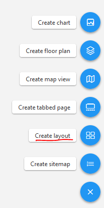

I think by OH3 you mean with MainUI. (you can achieve this with traditional sitemaps of course - Sitemaps | openHAB)
I have never tried do it with MainUI but I would go this way:
Go to Administration → Pages
1
on the bottom right clik plus sign and choose “Create layout”
2
Give it a label and choose a layout style.

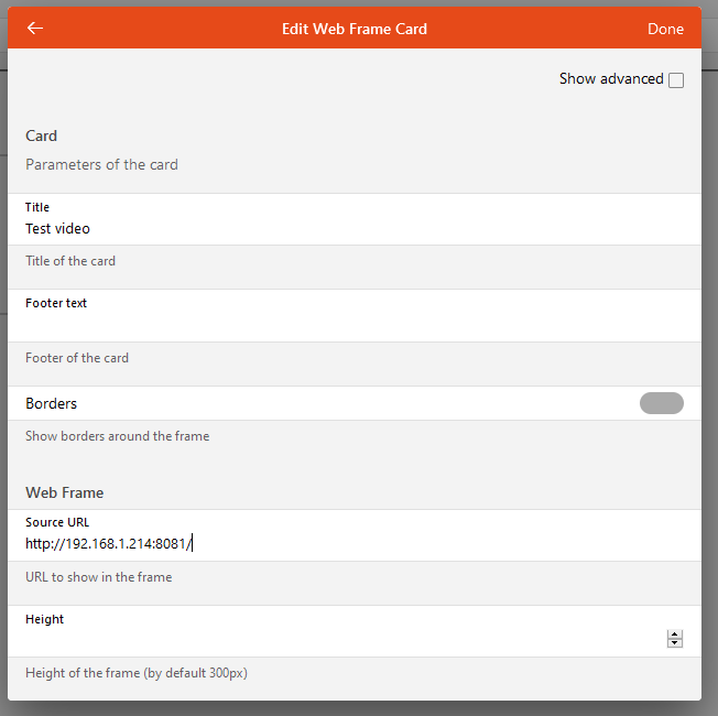

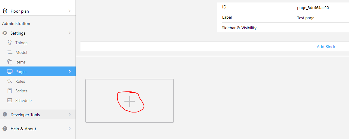

Then add masonry
Then click plus sign to choose template
4
5
6 7
  • Done
  • Save
Try to play with it maybe it will help you.
