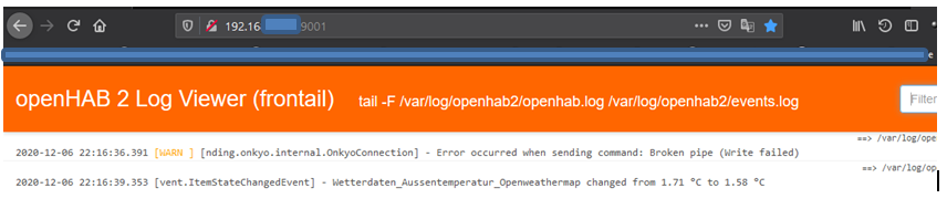

So i’ve no idea where the logviewer (which i know from oh2) is … on my old raspy-oh2.5 it was found in Port 9001:
Can anyone help?

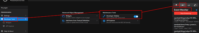

At the moment I just found a smaller, simple solution with the Developer Sidebar - maybe interesting for some of you:

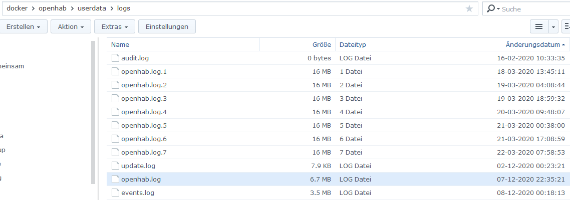

Ah, Thanks - this helps much! I’ve found the openhab.log and events.log easily by File Station …
what confuses me are the other files in the folder … if I understand it correctly, a new log file is started when the old one exceeds .16mb. … so i could remove the .log.1 - log.7, couldn’t i?
Then something else I don’t understand: in all logs are timestamps of (my) things from the beginning of the year - but I installed Openhab for the first time on Synology via docker just last month…(?).
You can remove the other files but anything beyond the 10th file gets deleted automatically anyway.
You probably are reusing the same folders as was used for OH 2 so OH 3 is just continuing the log.

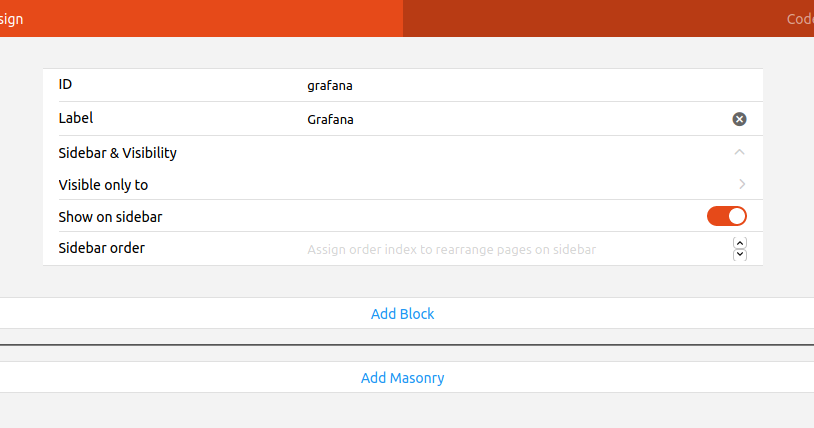

For that you just need to create a new Page.
From “settings → Pages” click on the + icon and select Layout (or one of the other page types you might want to create).
Give it an ID and a nice Name, open up the “Sidebar and Visibility” and toggle on “Show on Sidebar”.
