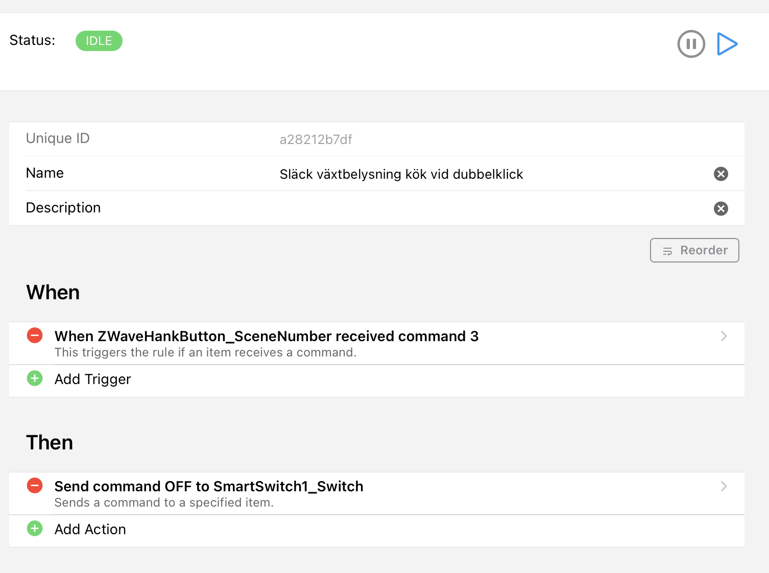

Now I’m trying to create rules that react to the Hank SCN01 when pressing the button. I have no success. The rule works if I play it, but nothing happens if I press the button. I can see that the device is online, but the only “sensor” is battery level and it is reported as 0%. I have set zwave to Debug level for logging, but I see nothing in the logs when the button is pressed. The top side led is only blinking blue a lot. Something I don’t understand when investigating the manual.
What more can I test to find out what’s wrong?

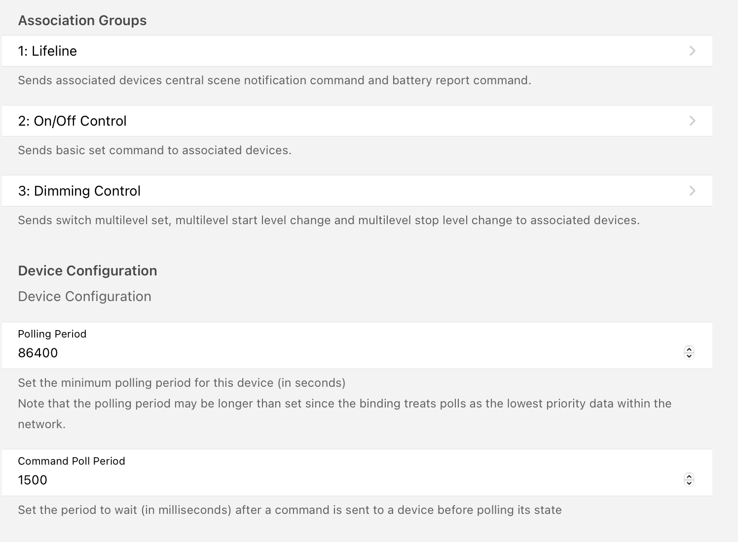

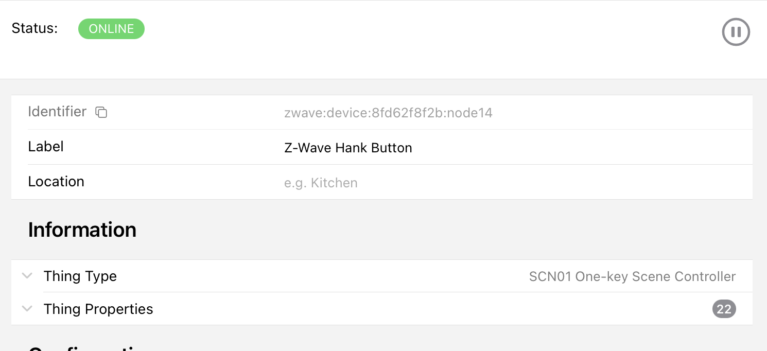

Now you have the problem that the other posters were writing about in your other thread, the battery device is not fully configured. Discovered, yes. IDed Yes. Configured No. How to tell is on the UI page you need 5 lines.
Screenshot 2021-09-10 172956
You need to use the wake-up button protocol, probably several times about 30 seconds apart. You can set the zwave to Debug and follow the progress (hopefully there will be progress). Also can you post the lower section of the UI page that shows Association group and wake-up interval? If the initial configuration gets those set, it’s only a matter of time. If not, it could be an adventure.

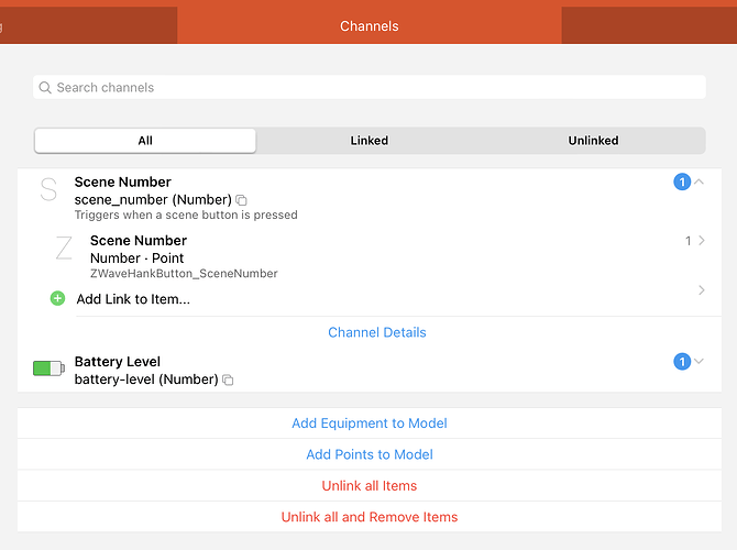

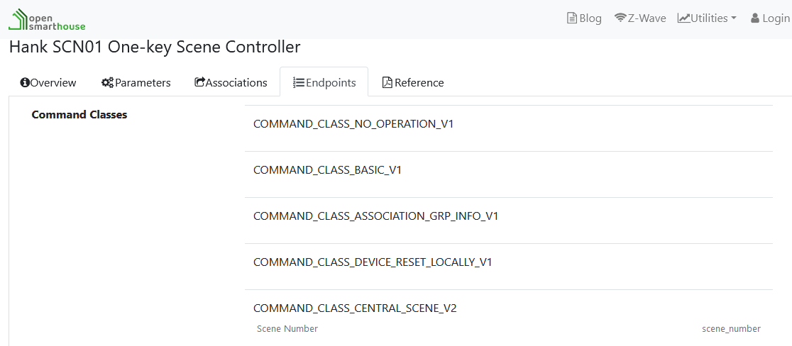

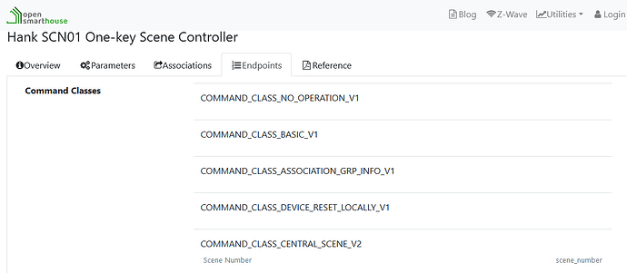

As long as there is no channel for the scene number, your device won’t work:
grafik
As @apella12 said: wake it up, wake it up, wake it up …
I can’t find any wake-up interval.
Screen Shot 2021-12-04 at 18.26.48
Screen Shot 2021-12-04 at 18.26.57
Well, there are two channels and scene number is one of them.
Screen Shot 2021-12-04 at 18.25.11

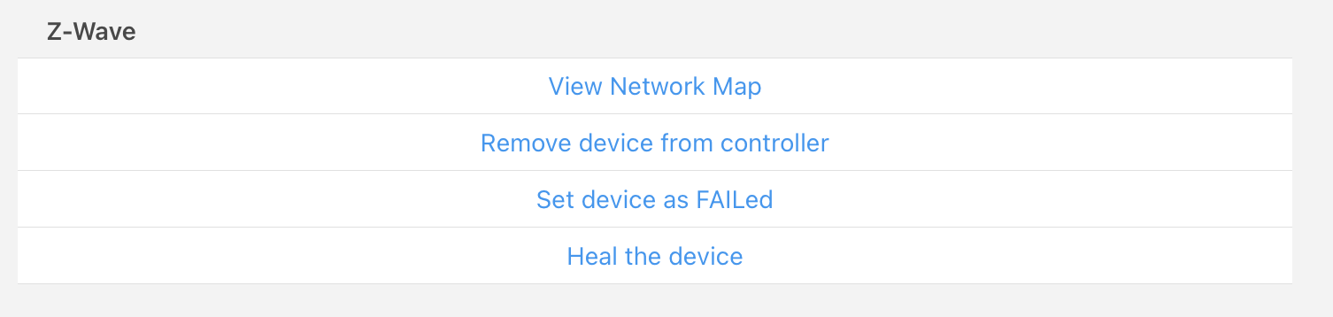

How many lines at the bottom of the ui thing for hank (I’m assuming it is node 14)?

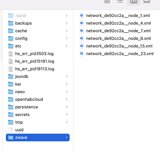

Also is there an xml in userdata/zwave for the hank node?
Bob
No user data for node 14.

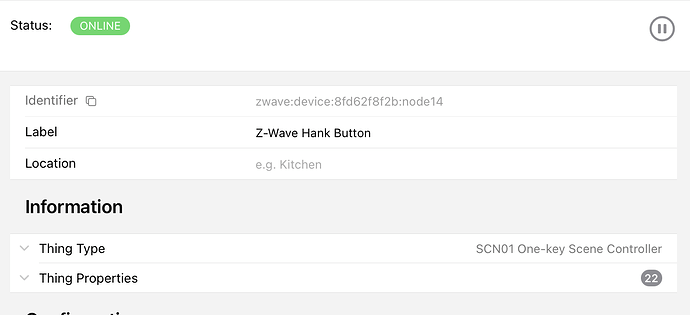

I updated location for the thing and got this response:
