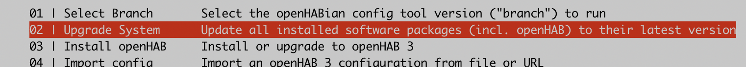

I just had the idea to select
but it didn’t help either.

Reading through the description, I’d guess this option only performs an apt upgrade or apt full-upgrade which upgrades all installed packages but keeps the distro version.
As described in the CHANGELOG above, the command to upgrade the system would be apt dist-upgrade, but those operations are potentially risky — I wouldn’t recommend to do.
Ok, only now I understand what it seem to mean: openhabian will NOT automatically upgrade to bullseye even though when you install it fresh it would be based on bullseye (sometimes you read something but you just overread it even though in this case the statement is more than clear - mea culpa).
Is that correct?

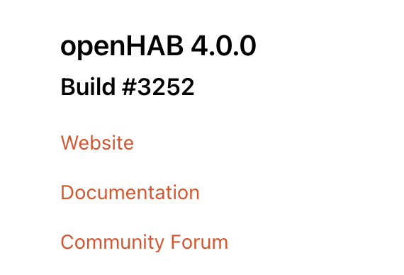

(my hope would be that this would be adapted in case openhabian-config eventually delivers a different distribution)
at least now openHAB is starting up again and 4.0.0
is up
