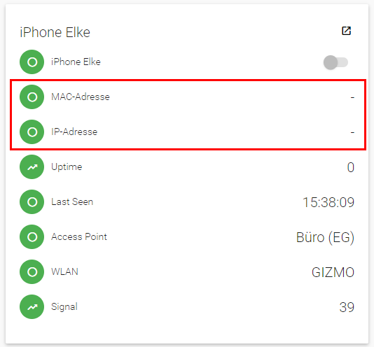

Updated to 6.0.28 a few days ago, not my presence detection doesn’t work anymore. IP address and MAC address is being reported empty by the binding. Anyone else having this issue?
I have similar problems after updating to 6.0.28. The presence detection toggles in a few seconds interval. Alexa which is announcing somebody coming home is talking all the time. I disabled it therefore. I don´t know if the binding could fix this or if this is a bug in the controller (which I assume).

FWIW i am having the same issue as most people here. My devices are constantly showing ‘ON’ and not changing. My devices are reporting the correct MAC and IP to the binding though. I am using controller version 6.0.28.
