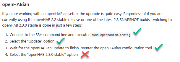

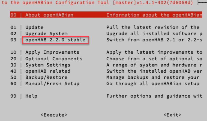

But when I try to upgrade my openhabian snapshot 2.3.0 to stable 2.3.0, I only get the following screen:
any ideas?
I believe this is just a hard coded text that hasn’t been updated yet.
Selecting the option will always install the latest version available, not just 2.2.0.
Either way, openHABian can also follow the same update procedure as APT based installations

it is fixed: now their is only openhab stable without any version number.

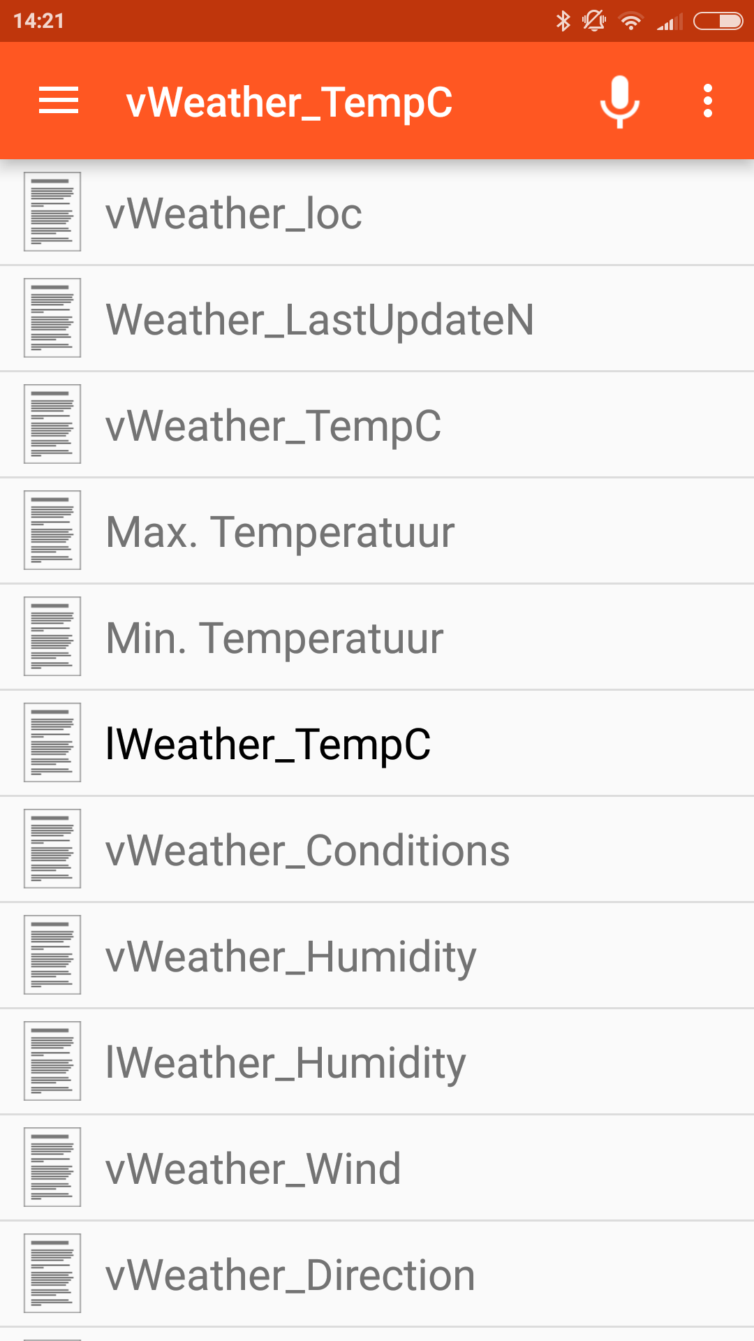

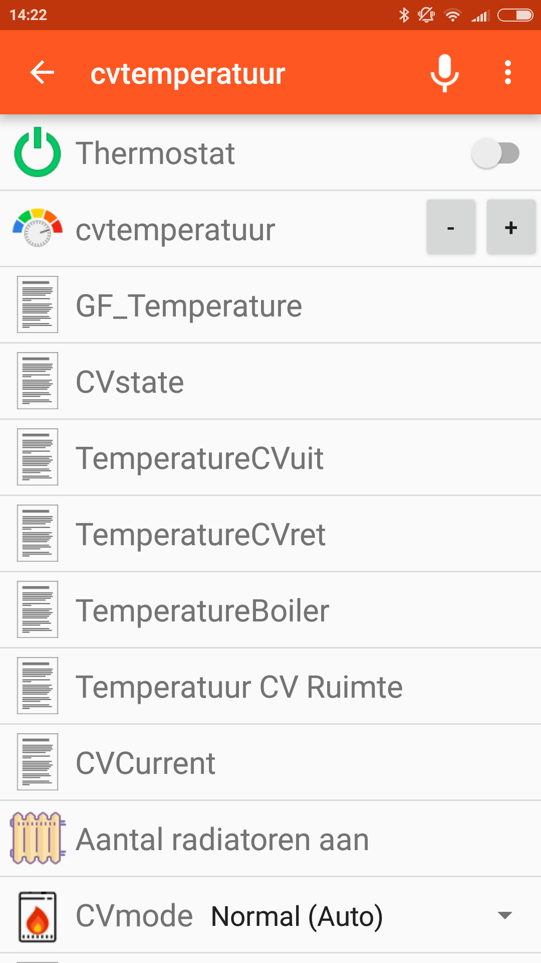

I can only speak for myself though that I regret the update as it seemed to have broken a lot of things, if not everything. None of my items (e.g. the weatheritems (http call with JSONPATH transform)) are not recognised anymore, seeing only item names and no longer the labels, icons or values
My logs are full of error messages of items that cant be found:

and on ip:8080, I see no user interfaces anymore, just grafana, find and help
I am sure I can get it fixed somehow but for now I think I will just put my old files back

Thanks, but that is not the only problem. 99% of my items cant be found, neither can my UI’s.
Everything is just completely broken
