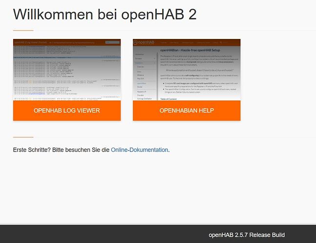

what I wrote in my previous post:
The raspberrypi-kernel package was updated yesterday, resulting in the kernel version to jump from 4.9 to 5.4.
Following Telegram problem here:
2020-07-24 22:45:02.264 [ERROR] [ntime.internal.engine.RuleEngineImpl] - Rule 'Telegram senden, wenn die Alarmanlage unscharf ist': An error occurred during the script execution: Could not invoke method: org.openhab.binding.telegram.bot.TelegramActions.sendTelegram(org.eclipse.smarthome.core.thing.binding.ThingActions,java.lang.String,java.lang.Object[]) on instance: null
Furthermore there is no access through openhab:8080 to the PaperUI, Basic UI, etc.
App is working wonderfully instead to 2.5.7 → no eclipse error for the time being
I reboot the Raspberry Pi3 three times but no good result. The last shutdown with power off did it not too.
