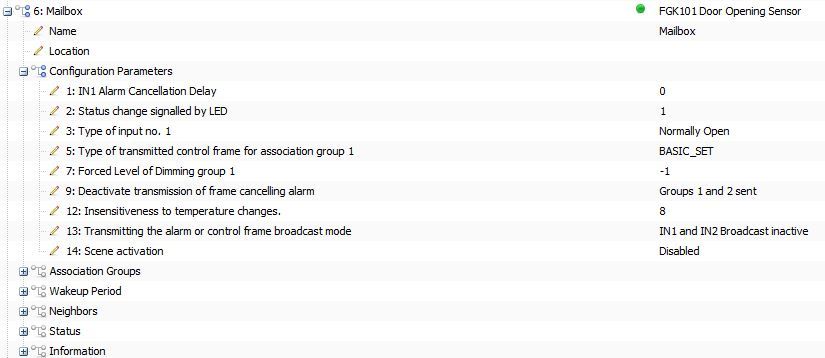

If you want to change the configuration of your zwave devices it’s the easiest way:
Note that this is a screenshot from openHAB1, but habmin in openHAB2 works the same way …
