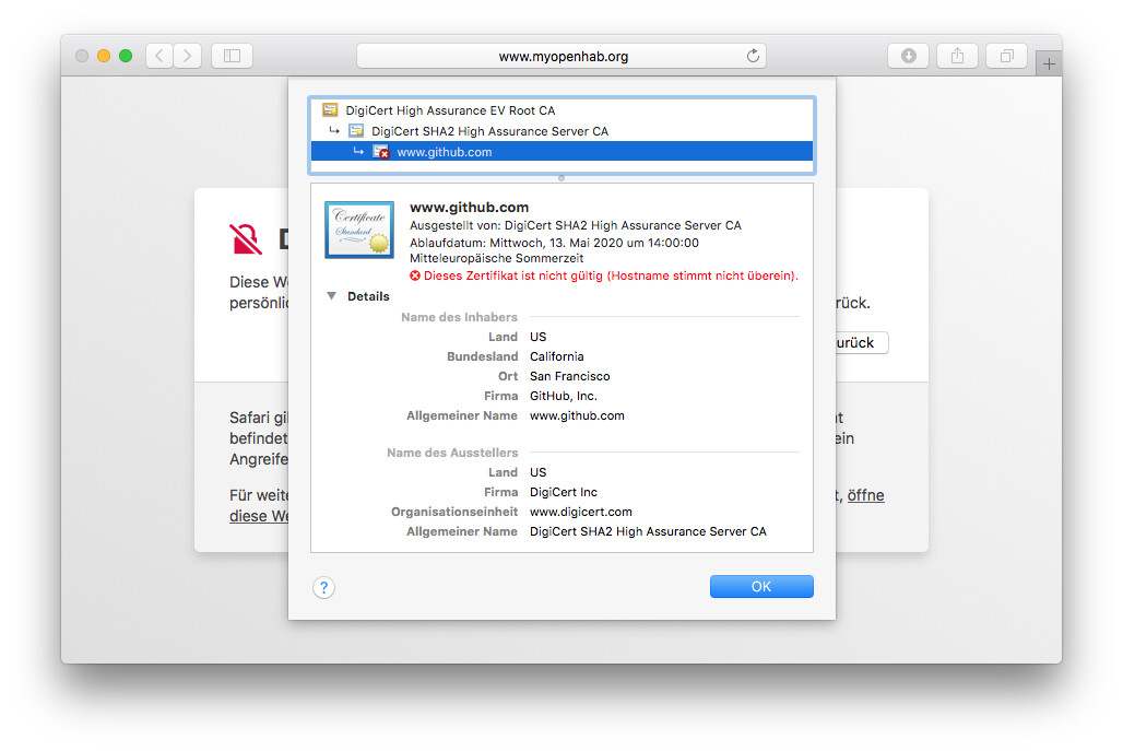

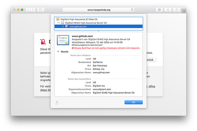

i get web socket errors and even though it says „Connected“ in the log I am unable to control remotely.
this started yesterday after 23pm CET without any configuration change on my end
I currently see for https://www.myopenhab.org a wrong SSL certificate which is issued for GitHub?

Accessing the URL I still get an “Inavlid Certificate” (DLG_FLAGS_SEC_CERT_CN_INVALID)

This is not a new problem. https does not work with www.myopenhab.org becauise of the certificate.
The cloud service uses https://myopenhab.org and its certificate (issued by Let`s encrypt) is OK.
