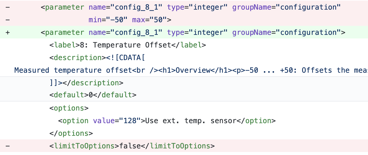

Temperature Offset has the same problem.
It cannot be set to 128 (special value for external sensor), but only from -50 to +50
I cannot imagine this didn’t work for previous versions of openHAB, so my guess it is a openHAB 3 issue.

Don’t get me wrong,. I really appreciate your help and promptness to change the DB, but the more I am thinking and reading about it the more I get convinced the solution is to keep the DB as is and change openHAB so it allows all option values and the range (even if some of the option values are outside of the range)
You might have misunderstood, there was an error in the database causing the binding not to accept those values. Definitely no code changes needed, just wait for the next SNAPSHOT including the DB update.

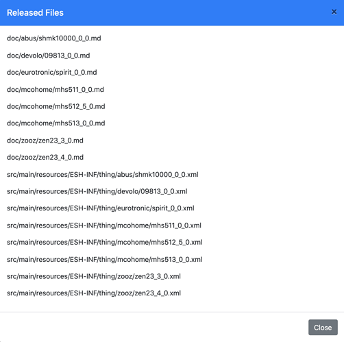

That depends on when @chris next exports the database. He exports the database and then the binding build after that will have the changes.
I did the last export an hour or so ago…
That was before my changes, unfortunately. I changes things about 35 minutes ago.

Just extending the minimum range on one parameter & the maximum range on another should not break anyone.
I agree it does not break things.. But I think the best solution is for openHAB to allow all the listed option values (even if outside of the range) and all values within the range.
So with the config range -50 - 50 and the option value 128 it accepts 128 AND -50 - 50
And with range 5-30 and the option value 0 it accepts 0 AND 5 - 30.
This way the DB also reflects the real possible options.
I think openHAB did this in the past…

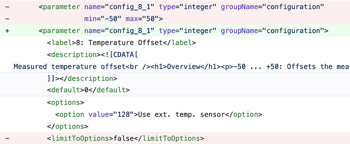

Hmmm - I don’t think this will work now…
The above has removed the limitToOptions - so I think this now defaults to true, and if so, I think now you will only be able to select the “Use ext temp sensor” option.
I know there was an issue open in OH3 as the inputs weren’t selecting data correctly. Probably the database was ok previously.
This has now been fixed.
