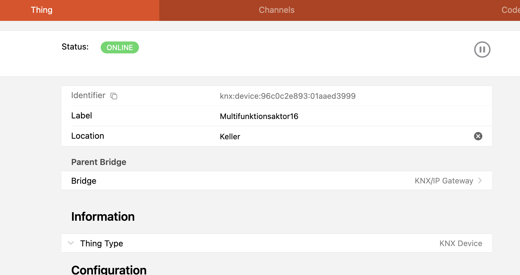

Hi @djoope , I have the same problem as you. Once I removed the individual address from thing, the device came online. Can you make screenshots on how you did the setup of channel and points? Here is my KNX Thing (actuator), I use it to control all some of the lights (On/Off) and dimming functions. I find the documentation not really clear so I am stuck at this step. I wanted to try editing the config files, I can’t get to create a token. Another error, that I don’t get. My setup is on RPI4

I simply cannot get it work, but I am also fairly new to KNX & ETS, so that might be the problem. I have one single actuator (on/off) in ETS which is controlled by a touchpanel, and it is working fine. I have only one Group Address, where I simply link the touch panel and the actuator.
In openhab I can get a bridge and device online, but no communication to or from the bus via item in OH.
