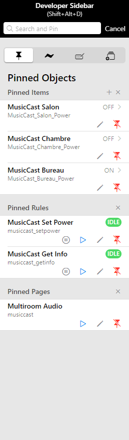

Developer sidebar

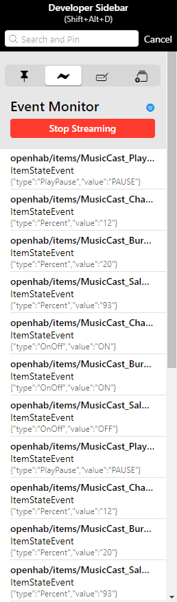

You can now invoke a new “developer sidebar” from the developer tools menu or anywhere with the Shift+Alt+D keyboard shortcut - it will only be displayed to admins and if the window is large enough (1280 pixels wide or more) with a set of productivity tools when you’re configuring your system.
  • the search box/pinning feature will search items, things, rules (& scripts), and pages and will allow you to pin them on the sidebar. It’s only temporary because they will not be retained if you close it, but it can be handy to quickly control an item or go edit another object while you’re working on something;

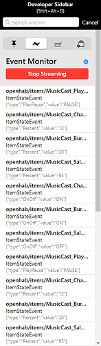

  • the event monitor will display the raw events that arrive on the bus, eventually matching a topic filter (like openhab/items/ItemPrefix*/statechanged);

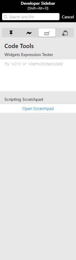

  • the widgets expression tester will help with the expressions that you can include in pages or widgets;
  • the scripting scratchpad will create a script named scratchpad if it isn’t present (asking you for your preferred language) or open it. You can use it to run code quickly;

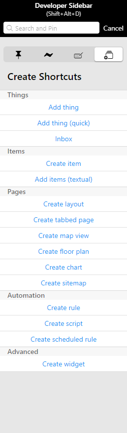

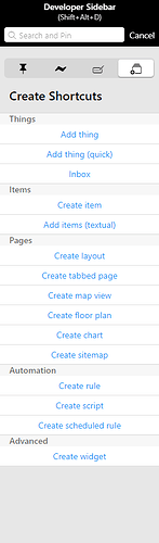

  • the shortcuts on the last tab will save you a few clicks when you create objects

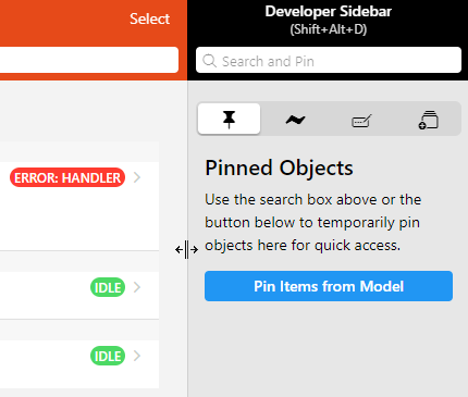

You can resize the sidebar if it’s too narrow:

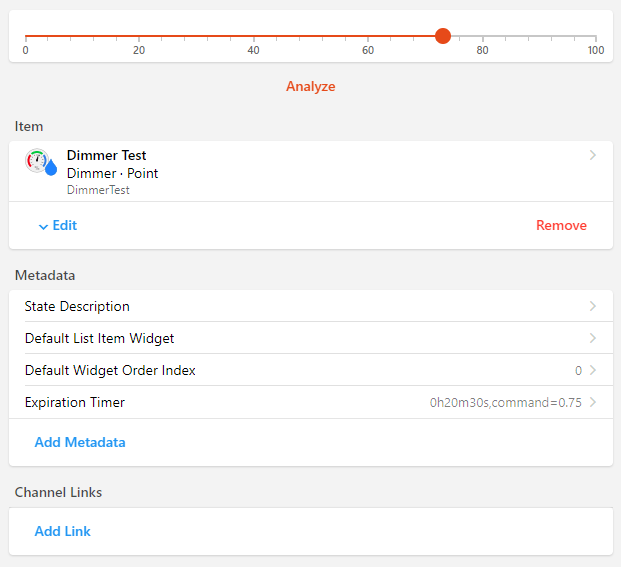

Metadata editors for expire & widget order
The metadata namespaces are more accessible in the model editor, before you had an entry for every known namespace even if it was not used and they were hidden below 2 collapsible sections. Now you see only the namespace which are defined and can add more easily from the model editor.
openHAB has core support for expire functionality, compatible with the syntax of the former binding, except it’s metadata, so the UI has an editor for that.
2020-11-19_20-59-16
the widgetOrder (Default Widget Order Index) metadata namespace allows you to reorder items when presented in autogenerated lists.

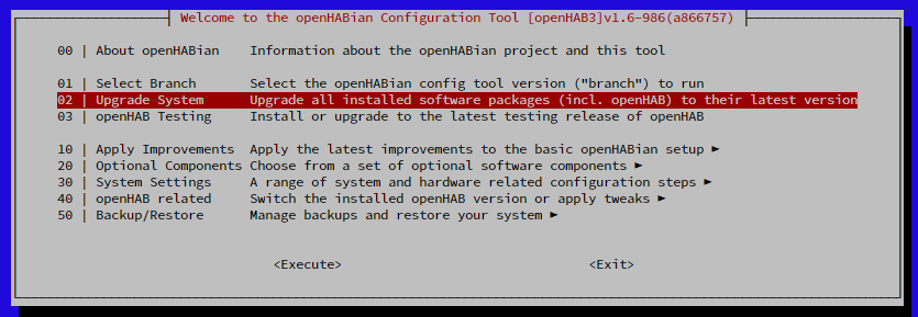

I have a question regarding updating to OH3 M3. I used Openhabian on my rPi4 to do the initial install of OH3 M2. After a few tweaks, it’s running pretty solidly at the moment. Do you use Openhabian again to update to OH3 M3? If so, what menu do I do it in? I believe Openhabian 1.6 is still in beta for OH3.

Option 2
Thanks @denominator. I tried that option and it did not upgrade to OH3 M3. It’s still at OH3 M2 after running option 2. Is there a way I can invoke the upgrade manually?
Make sure you are running the openhab3 branch of the openabian tool
I selected the OH3 branch in Openhabian then ran option 2 again. No luck.

Edit: try selecting option 3. The milestone builds are in the ‘testing’ branch. Once you switch to the testing branch the above two commands are how you upgrade.
The snapshots and Milestones are in different branches.Snapshots are in Unstable and Milestones are in Testing.

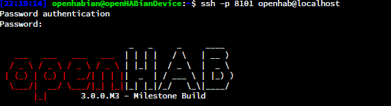

sudo apt-get update
sudo apt-get upgrade
did the trick!
