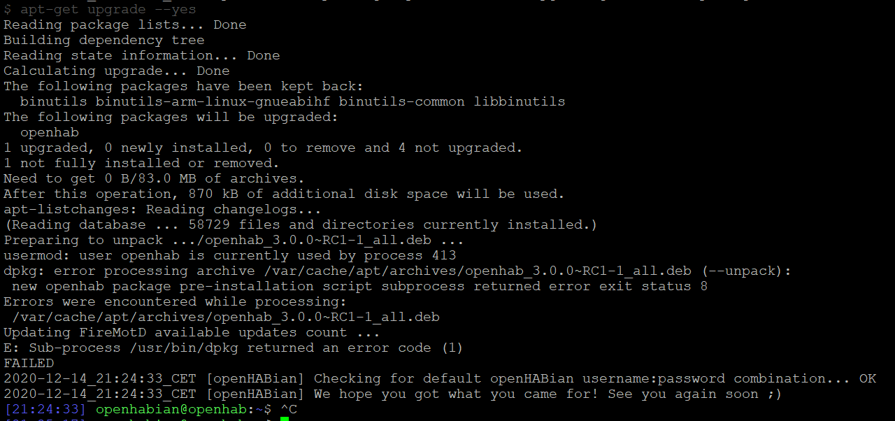

Error during upgrade
I have tried to upgrade from M5 to RC1 using “sudo openhabian-config”, master and option 2 : Upgrade System - but I get the following error:
Solved
After running “sudo systemctl stop frontail.service” I can now upgrade to RC1.

using master of openHABian config tool and tried with option 40-41 | openHAB testing and 40-42 | Upgrade to openHAB 3
There is another process running as user openhab, @Erling screenshot shows it as 413.
Identify this process, stop it and upgrade again.
@Benjy What does the usermod do here? Is it really needed for updates ?

Thanks, in my case it’s PID 553:
openhab 553 0.8 1.2 144004 49088 ? Ssl 21:33 0:11 node /usr/bin/frontail --ui-highlight --ui-highlight-preset /usr/lib/node_modules/frontail/preset/openhab.json -t openhab -l 2000 -n 200 /var/log/openhab/openhab.log /var/log/openhab/events.log
when I kill this process it starts again with another PID and then I get the same message but with the new PID.
Upgrade errors out with the same message.
Don‘t kill the process, do a clean
sudo service frontail stop
or whatever command it takes on your system.
I normaly stop frontail before upgrading, as I also delete the logs.
ah perfect, thanks!
After stopping the frontail service the upgrade passed fine.
Weird as it’s the first time I needed to do this.
