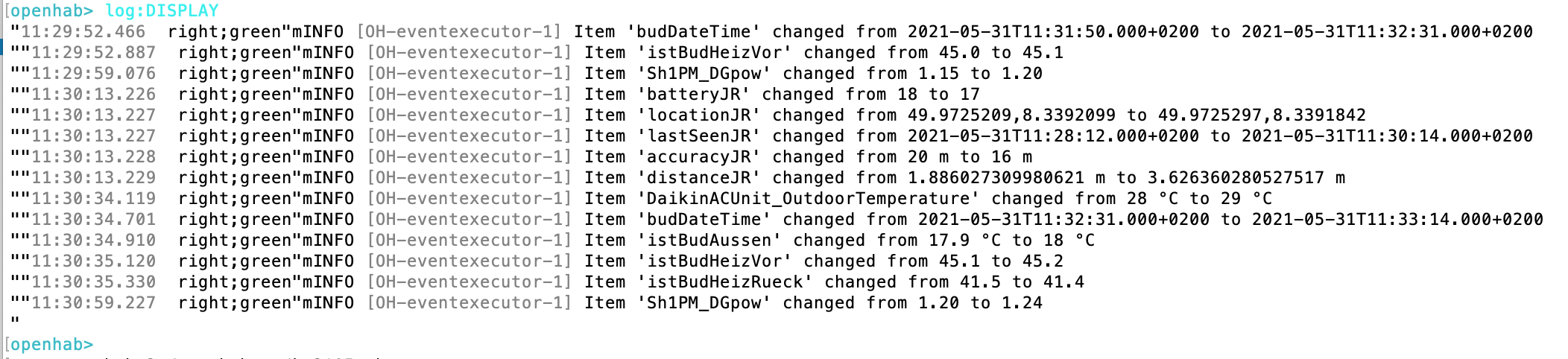

Hi @Kai,
taking these settings 1:1 seems not to work very well:
But it is a good hint where to start redefining the settings to get the previous output format :+1:

This also did not bring the colors back :frowning:
It also seems that the log:DiSPLAY has now the ā€œtailā€ option per default as I only get the last few lines when running the command???
