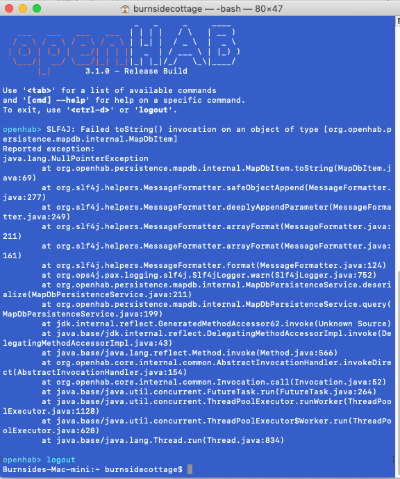

3.1.0 Release version spawned a terminal error list so I reverted back to 3.1.0-M4 because I didn’t trust it. 3.1.0-M4 has always had an error free terminal window,
I did a logout/startup of the new OH a few times but it still generated this error list in the terminal.
Screen shots of terminal window attached. Does anyone understand this gibbberish??
I did my upgrade in the usual way by creating a backup and then restoring that backup into the newly downloaded version.
Thanks in advance.
Looks like that one of your items that is being used in mapdb persistence is null.
NPE ( NullPointerExeception ) was recently introduced.
Hi Wolfgang, so OH3.1.0 release now flags these inconsistencies? Can I just ignore the problem? I think there were errors showing up run the OH user log too. How would I find and fix the problematic item? All my items have seemed fine and nothing has showed as null up till this upgrade claims that something is amiss.
