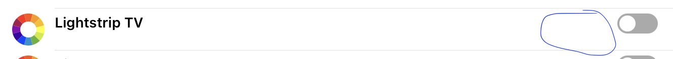

Hi there,
based on major problems on my system I did today a fresh install of openhabian and open hab 3.4
I am using
- Linux 5.15.76-v7l+
- OH 3.4.0
- Raspberry Pi 4 Model B Rev 1.1
- Deconz and Hue Binding
My Problem is now, that in mainUi location I do not see color selections any longer. In 3.3 it still was there. I am not sure if item type for color have changed. If it is a config thing, I will open a new post, but due to having the problem since 3.4, I post it here, sorry Markus.
Color ZigLightstrip_1 "Lightstrip TV [%s]" <colorwheel> (gLicht_Wohnen,gChart) ["Switch","Light"] { alexa="ColorController.color,Lighting,BrightnessController.brightness", channel="hue:0210:00212E03B617:Lightstrip1:color" }
I would expect the selection field to chose the color, which was possible before I did the cleanup. Is this something. I did from or is it a bug in 3.4.0?
Kindly,
Woogi
Found the solution. Semantic Definition needs to be [âControlâ,âLightâ]. This changed to 3.3, I assume. For my Dimmer items it is the same [âSetpointâ,âLightâ] instead of [âSwitchâ,âLightâ]. Hope this helps someone.
