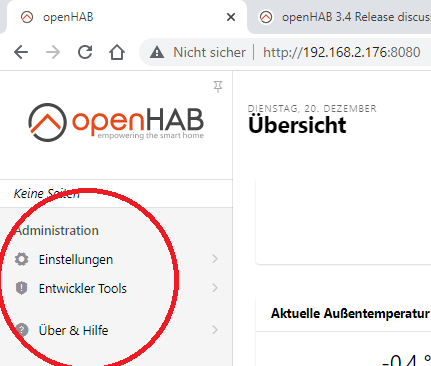

i updated to 3.4 and now i cant access:
Settings
Developer Tools
Help
if i click on them nothing happend.
has anybody else the same problem?
it only works if i type the ipadress:port/setting in my browser.
in Openhab app they are also not accessable
No, I just checked. I can click on them all and it works. What browser are you using, has your startup finished, have you restarted your browser?
