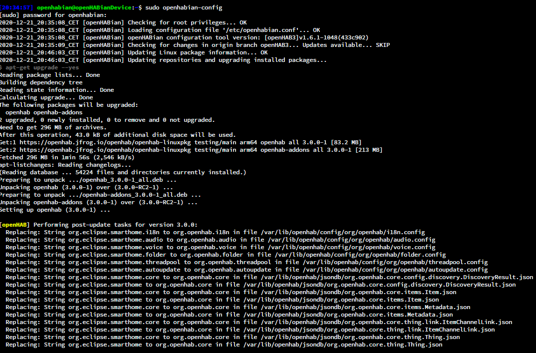

I solved it,
i needed to upgrade to the latest openhab 2.5x and then install openhab 3
@andrea_cecchi details?
[Edit]
oh. I just went for option nr 02 on the openhabian-config first. And then option 03
