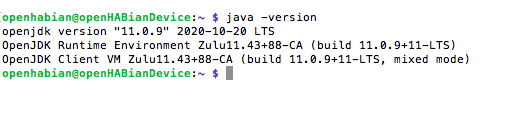

Just to check:
java -version
shows that Zulu 11.X is installed ?

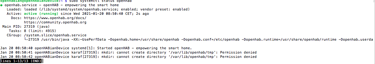

I have now entered the commands and attached the results as a picture.
Your first picture shows a permission issue for the temp folder. Please use “fix permissions” in openHABian.
Thank you for your help.
That was exactly the problem.
Now I can start Openhab 3.
Best regards
Great, please mark this topic as solved then.
