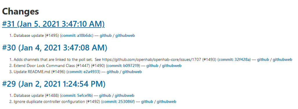

I just updated to the latest Zwave snapshot and the switches are working again!
openhab> bundle:list -s | grep zwave
251 x Active x  80 x 3.1.0.202101050341      x org.openhab.binding.zwave
What I do not understand though is that I was on the previous snapshot version of the binding and it did not work even though your commit was listed for the Jan 4th version…
However, since it is working now I am a happy camper! Thanks again
