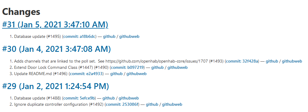

An update/commit from digitaldan solved the issue.
I updated to the latest snapshot version of the Zwave binding and the switches are working again:
Well this is good news, I also went ahead and updated to the same zwave snapshot will do some testing after work.
For anyone else looking to grab the new snapshot I ran this command from Karaf:
update org.openhab.binding.zwave https://ci.openhab.org/job/openHAB-ZWave/31/artifact/target/org.openhab.binding.zwave-3.1.0-SNAPSHOT.jar

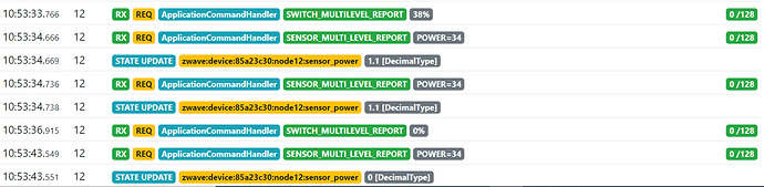

I am having a similar issue with Fibaro FGD212 Dimmer 2 modules not updating when pressing the physical switch on the wall. I am running the latest zwave snapshot as suggested. The normal switches work fine, only dimmers seem to be affected.
openhab> bundle:list -s | grep zwave
263 x Active x  80 x 3.1.0.202101180339      x org.openhab.binding.zwave
When an unsolicited “SWITCH_MULTILEVEL_REPORT” is received from pressing the dimmer switch there is no “STATE UPDATE” for the “switch_dimmer1” channel. Other channels like “sensor_power” are being updated as expected.
When the Dimmer module is polled the “switch_dimmer1” channel is updated.
Any advice would be hugely appreciated.

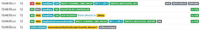

@chris, do you think this is a bug in the zwave code? When receiving an unsolicited “SWITCH_MULTILEVEL_REPORT” a “STATE UPDATE” is not being called.
I think that’s pretty unlikely to be honest.

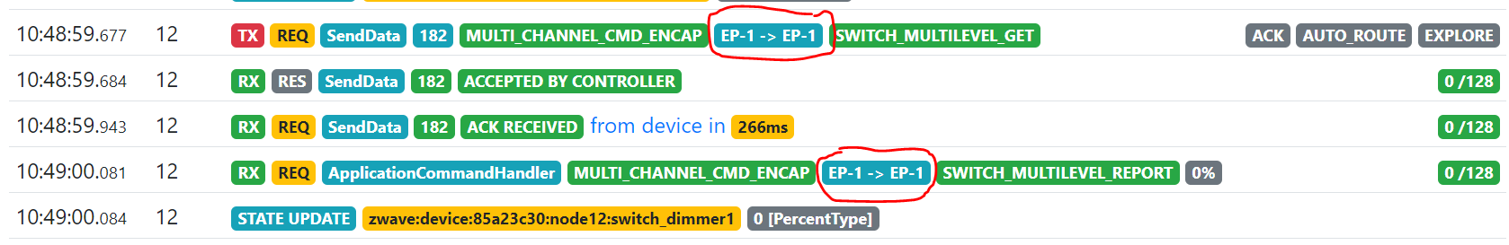

That’s because the command is not encapsulated for the correct endpoint.
Thanks for your response.
I see what you mean about the unsolicited command sent from the Fibaro FGD212 dimmer device not containing the EP-1 context.
Unsolicited command from FGD212 dimmer device
vs this for the polled response
I noticed the sensor power unsolicited command from the dimmer also does not contain the EP-1 context (guess it’s related to the device itself), but the STATE_UPDATE is still called.

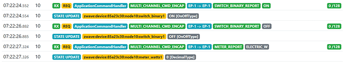

I did some more testing with other devices and the Fibaro Switch FGS223 devices do send the EP-1 (or EP-2) context in unsolicited commands
The Fibaro Switch devices contain two individual switches, the EP context would be required to distinguish between EP-1 and EP-2.
Given the Fibaro FGD212 dimmer device only has one physical dimmer, would the dimmer device be required to send the EP context? or should the zwave binding use a default of EP-1 if there is no context in the received command?
