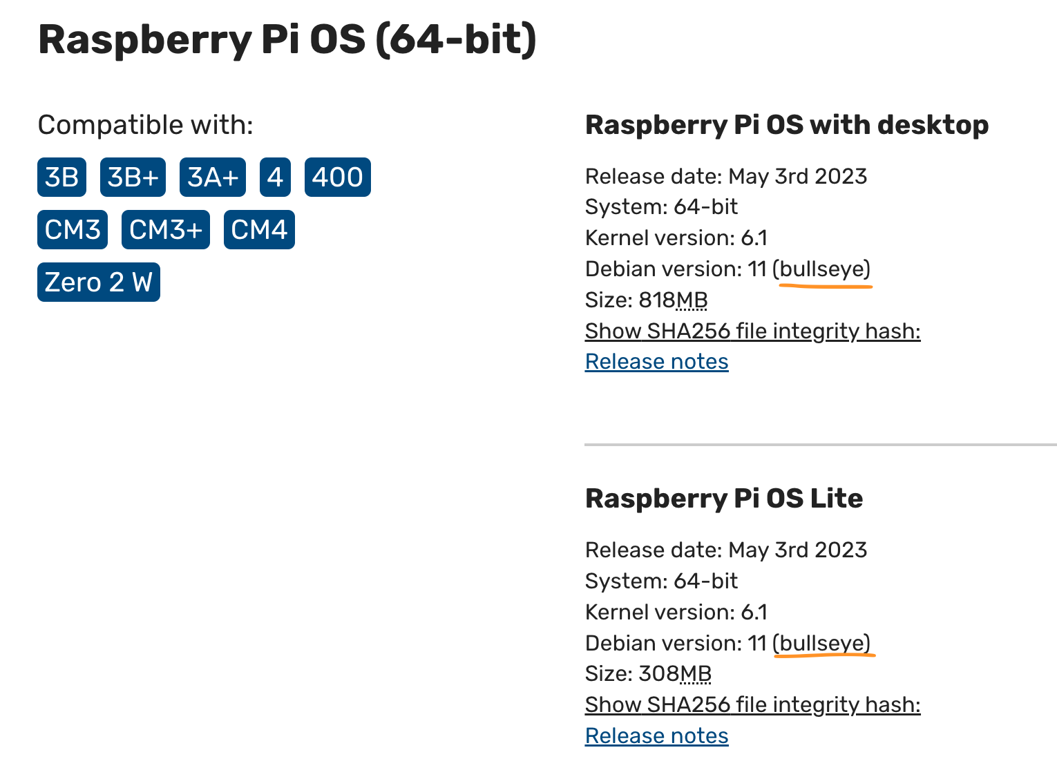

Debian has released bookworm but the latest version of Raspberry Pi OS is still bullseye, at least according to the download website: Raspberry Pi OS downloads – Raspberry Pi
Raspberry Pi OS is not stock Debian so it usually takes a little bit of time from Debian release and Raspberry Pi OS release, though I expected support to be available before now.

I don’t expect there to be a noticeable day-to-day difference for many openHAB users, RPi OS bullseye is already on the 6.1 Kernel and contains Java 17. (I currently use a Debian bookworm image on my RPi 4 and I’m not sure I can tell!)
Bookworm for Pi S has been released a few days ago.
