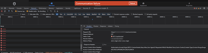

Did you ever solve this issue? It happens to me, too today I migrated from openHAB 3.4.4 to 4.0.4 and even after several restarts of openHAB’s Docker container (even after rebooting the Raspberry Pi), I see the following:
When calling log:display in the openHAB client, I don’t see any errors or warnings.
This bug has some implications as I’ve built this tool to automatically capture screenshots from an openHAB layout page - which does no longer work as the Communication failure box hides the shield icon/login button - so now I can no longer use my tool
