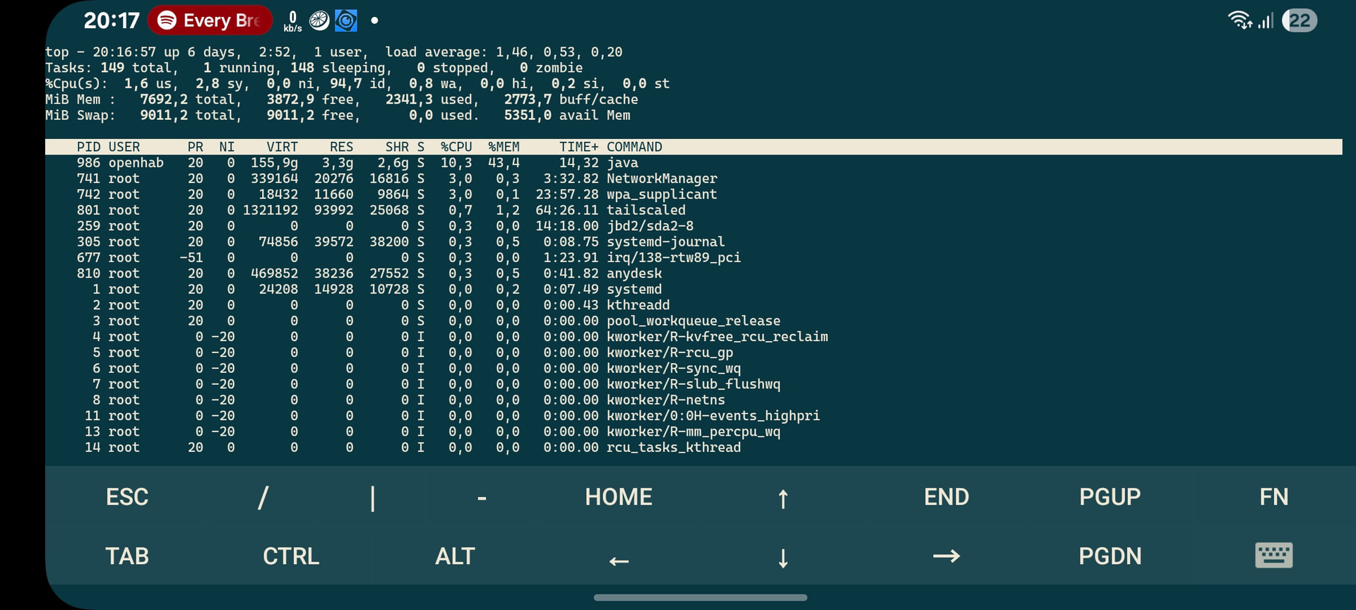

2.Staging OH5, and errors
I am still waiting that OH5 staged setup crashes, as it is running only 5 days, mwanwhile i have same setup as i did on 31.10.25 when i harvested a sys log for OH5 crash.
oh_log_31_10_25.txt (814.1 KB)
This log may or may not show the root cause od why it crashed, but sure it shows it strugled.

CPU load of rules on home server is like noticable in bursts, normally is like load avg 0.5 but it spikes to 3 every hour.
Now IO isnt too bad as Influx just writes and never agregates to rewrite in my setup, it uses less cpu and disk as RRD4J did and it ate my drive alive then thi IO was crazy.
The only thing is that i dont know how to measure what rule is loading the system how much as that ttop in cli console hides rules under hanler IDs.

It’s important to understand what “load” means on a Linux machine. It is not a measure of the CPU. It is the average number of processes that are stuck waiting for any resource over that time period. That resource could be CPU but usually it’s more often waiting on SWAP or some other IO. A load of 3 means you have on average three processes that want to run but can’t because they have to wait for some resource.
It’s pretty common to see a system with a high load but almost no CPU utilization. Everything is stuck waiting for something and the CPU has nothing to do.
Information like what you get from iostat, thread dumps, etc which have been bright up above will help identify what resource is becoming the bottleneck.

That iostat is great, i also used iotop before and i also used iftop sure, but usually i see broad picture not specifically the component that is giving issue in OH. I can revisit that for sure.
