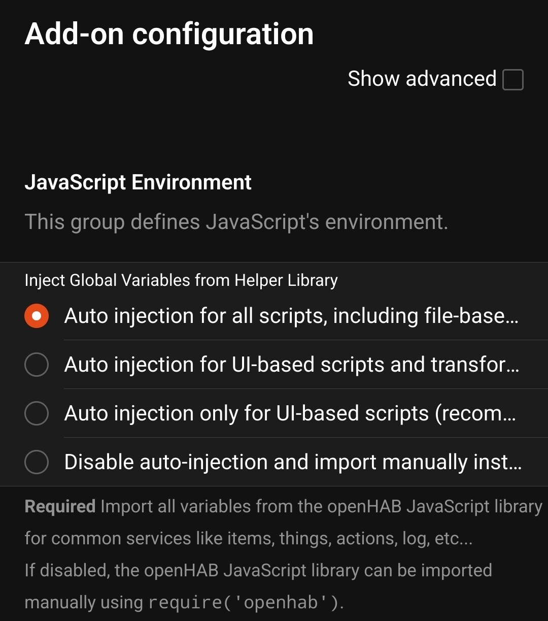

Under MainUI → Settings → JavaScript Scripting is “Use Build-in variables” selected? That should autoimport openhab-js for rules and transformations.

auto-injection is switched on.

no, it’s a different item. That’s why the helper is necessary. The profile decides based on the value of another item if the input should be used.
I would expect the code to inject the library, can’t see an obvious issue (though it’s my own code so I might be “blind” finding an issue that I made).
@Larsen
Can you please turn on DEBUG logging for JS Scripting? We need the logs related to an engine ID that starts with openhab-transformation-script-| and then a random number.
BTW you should be able to mitigate the issue by using require(“openhab”).items… (sorry for the wrong quotes).

I forgot to say: I made the change and now all scripts are working again.
