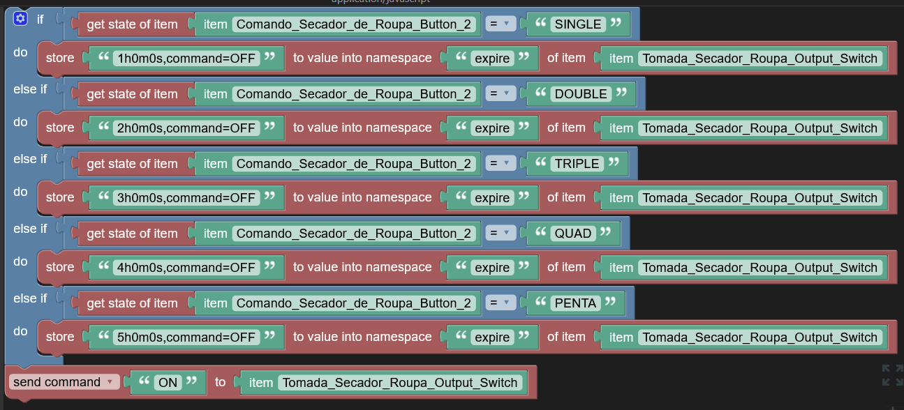

I have this rule written in blockly
In 5.0.2 all ok. But in 5.1.0.M1 none of the “store expire” commands are working, only the final ON command.

They fail how? Errors (if so what’s the error) or don’t run? If they don’t run, have you logged out the value of the Button Item to make sure it is what you think it is?
Note, there are changes in work in 5.1 M1 which change how the event Object works and the necessary changes to Blockly have not yet been merged. Those should not come into play here but it’s worth paying attention to.

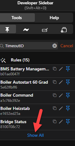

Upgraded to M2 –> Can someone double check if this button works?
For me it works only in “Items”.
In “Things”, “Pages”, “Inbox”, “Rules” nothing happens.
In Developer Sidebar I see a similar issue. “Show All” does not work 100% (e.g. for rules not):
