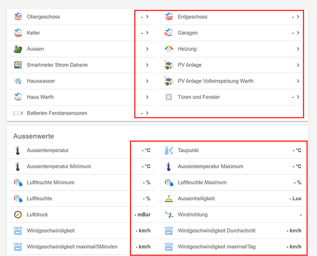

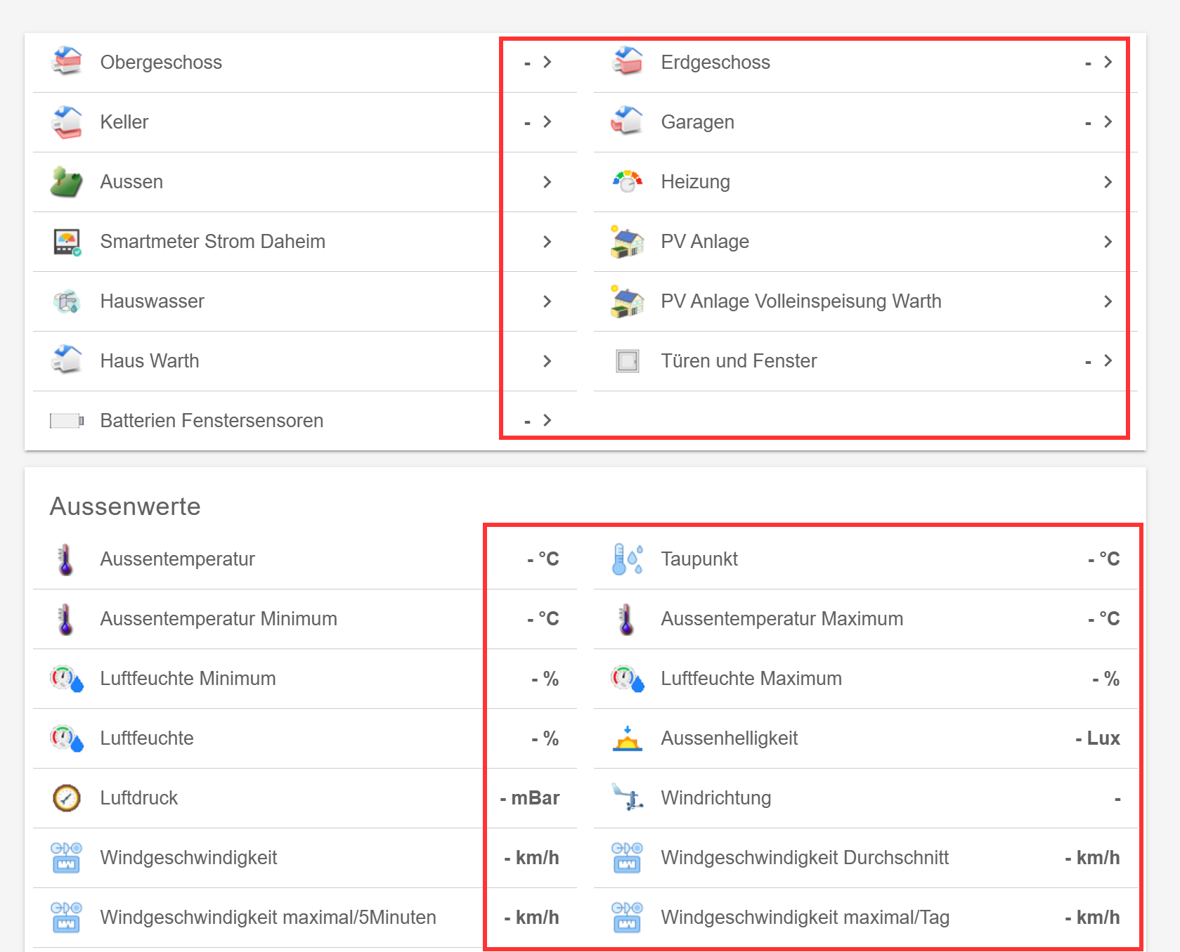

I updated my Testsystem from OH 5.0.3 to OH 5.1.0 M4.
all of my persisted data are now “null” in BasicUI
both persistence bundles are active:
329 │ Active │ 80 │ 5.1.0.M4 │ openHAB Add-ons :: Bundles :: Persistence Service :: MapDB
330 │ Active │ 80 │ 5.1.0.M4 │ openHAB Add-ons :: Bundles :: Persistence Service :: RRD4j
historical data in diagrams are working
it look’s like the state isn’t restored on startup correctly.

UPDATE: this error is shown in openhab.log:
2025-12-15 08:13:14.121 [WARN ] [el.core.internal.ModelRepositoryImpl] - DSL model ‘mapdb.persist’ has errors, therefore ignoring it: [8,2]: no viable alternative at input ‘default’
Did something change here or is this a bug?
it was a error in my configuration.
commented out:
//default = everyChange, restoreOnStartup
in strategies section:
Strategies{
jedeMinute : “0 * * * * ?”
jedeStunde : “20 0 * * * ?”
//jedenTag : “40 0 0 * * ?”
// Geändert 01.02.2002. Bisher:
// Auf:
// Geändert (auskommentiert) 15.12.2025 wegen fehlendem Restore beim startup
now item states were restored on startup.
Sorry!
