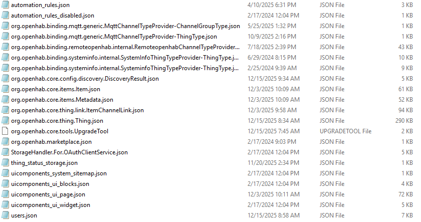

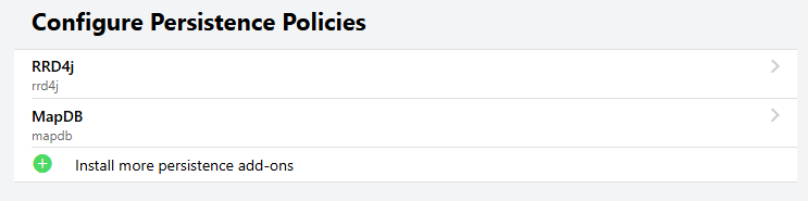

I have had a bit of a problem with persistence.
On docker upgrade I got this message;
[main] INFO org.openhab.core.tools.UpgradeTool - Executing persistenceCopyDefaultStrategy: Move persistence default strategy configuration to all persistence configuration without strategy defined
[main] INFO org.openhab.core.tools.internal.PersistenceUpgrader - Setting default strategy on persistence configurations without strategy '/openhab/userdata/jsondb/org.openhab.core.persistence.PersistenceServiceConfiguration.json'
[main] ERROR org.openhab.core.tools.internal.PersistenceUpgrader - Cannot access persistence configuration database '/openhab/userdata/jsondb/org.openhab.core.persistence.PersistenceServiceConfiguration.json', check path and access rights.
Then my dsl files were rejected;
2025-12-15 07:52:10.983 [WARN ] [el.core.internal.ModelRepositoryImpl] - DSL model 'mapdb.persist' has errors, therefore ignoring it: [2,1]: no viable alternative at input 'default'
2025-12-15 07:52:10.984 [INFO ] [el.core.internal.ModelRepositoryImpl] - Unloading DSL model 'mapdb.persist'
2025-12-15 07:52:10.985 [INFO ] [el.core.internal.ModelRepositoryImpl] - Loading DSL model 'jdbc.persist'
2025-12-15 07:52:10.997 [WARN ] [el.core.internal.ModelRepositoryImpl] - DSL model 'jdbc.persist' has errors, therefore ignoring it: [3,1]: no viable alternative at input 'default'
There appears to be no persistence or graphs and canât reach the configure menu for them.
Iâm trying to going back to M3. Still not sure. Will update when I know

Same persistence issue. In Main UI, these menus wonât even open. Back to M3 and they are accessible.

Iâm back on M3 for now. I see by the discussion a breaking change. I had already figured it was the default. My mapdb.
Strategies {
default = everyChange
Items {
* : strategy = everyChange, restoreOnStartup
The only thing I donât understand going forward is the write access issue. I have a full jsondb and it is in the docker container like everything else.

Edit: Also maybe of interest
reckhoff@raspberrypi:~/openhab $ grep ':1000:' /etc/group
reckhoff:x:1000:openhab
EDIT2: Just noticed on my other system (that I updated last night) that I canât get UI persistence menus like @kjknauss to work. I have no text files there. Persistence seemed to be working so I didnât notice.
