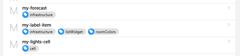

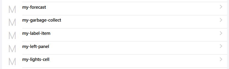

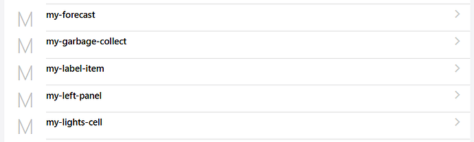

Version 5.1.M4, lost TAGs (not displayed anymore, still present in widgets) in Developer tools→Widgets …
Also, TAGs are not searchable anymore.
V5.0.3
V5.1.M4
Regards
/Sas
I’ve created a fix for this.
In next release ?
Regards
/Sas
That’s my fault, sorry. I modified oh-toggle and broke this.
I have already created a fix.
Both fixes will be included in RC1.
