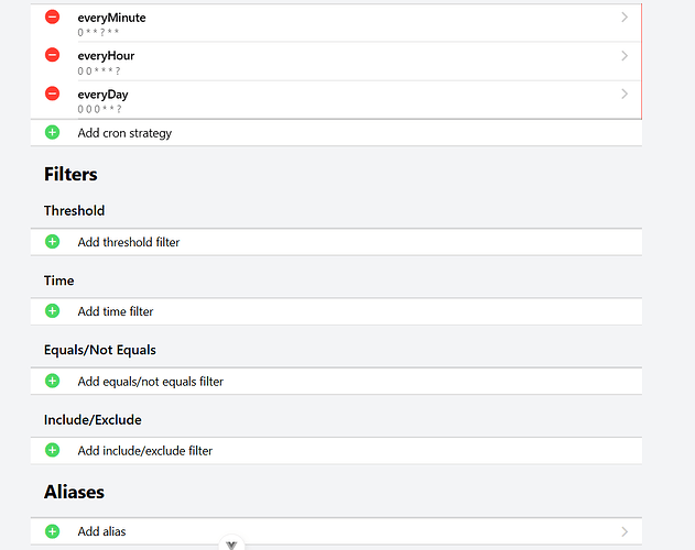

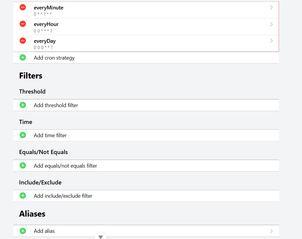

To illustrate what I mean, just look at how the configuration in the UI looks:
There are lots of options there, but no descriptions. Sure, I understand what an include or exclude filter is, but I have no context here, so I have no idea what I include or exclude. It’s the same with pretty much all of them. They just don’t give me the information I need to understand what possibilities they give me. I’m sure I can find out by digging, but that isn’t really suitable when I’m trying to get an overview over how to approach this. Having to “read an entire manual” to understand all the options before I’m able to get an overview over how to make a strategy that fits me is a big part of what makes me procrastinate.
It’s the same with the different persistence “engines”. I feel that they aren’t sufficiently exlained that I know what I shoud choose. In-memory persistence for example seems like an oxymoron to me. I’m sure it has its uses, but it’s not apparent to me, and I don’t quite understand why I’m faced with having to make some decision about it - it is “recommended” for installation, and if I install it, I’m also expected to make a configuration for it, that makes it do something meaningful.
To try to avoid writing a novel, I’ll stop here, but I could write much more “in the same direction”. The gist of it is that I feel that I must make decisions about things where I don’t have the necessary information, and acquiring that information feels a bit overwhelming. On top of this already existing “dilemma”, people are now being forced to do this, in the middle of an upgrade where lots of other things are going on.

I agree, the inline docs here should be improved. An issue would be welcome I think.
In the mean time, each of these is covered in the docs reasonably well. There’s always room for improvement.
Note, the developer sidebar always will link you to the specific page and often the specific part of a page in the docs based on what screen in MainUI you have open.
But there is a good opportunity here. The help section implements a wizard for some parts of OH. We could implement an initial persistence configuration wizard to walk the user through creation of a custom config.
An issue for this would be good too.

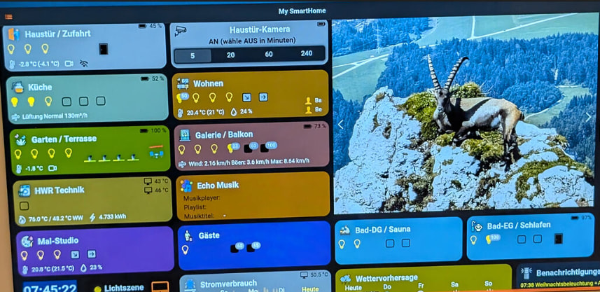

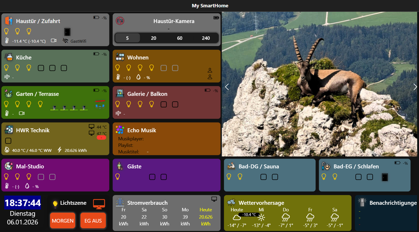

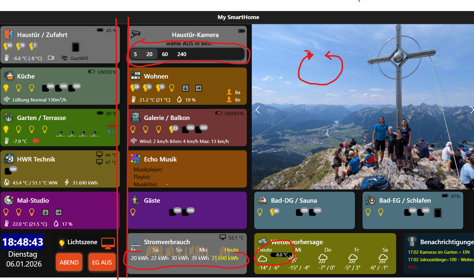

I try to support the resolution of the 5.1 problem with “canvas-layout pages”
Test-Result of 5.0.3 - 5.1.0 - 5.2.0 Comparison:
Page of 5.0.3 (old version)
Page of 5.1.0: (live version)
Page of 5.2.0: (test version)
Most of the problems caused by 5.1.0 compared to 5.0.3 are solved in version 5.2.0 but the pictures in widget “photoframe_2” are still not moving in 5.2.0.

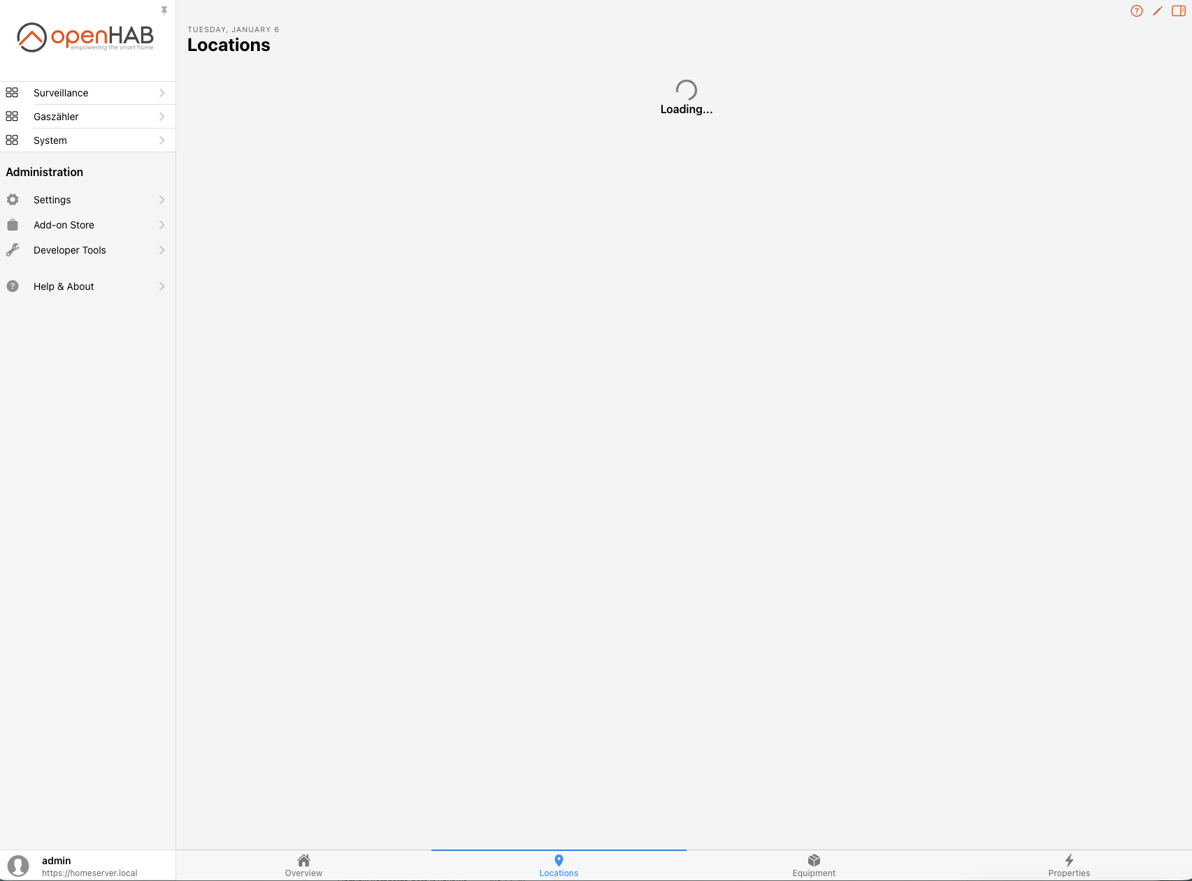

First of all thanks for another openHAB version!
After upgrading my installation to openHAB 5.1 the Locations, Equipment and Properties view on the home page do not work any more. Did I miss a breaking change there?
The pages only show a loading indicator but no error is shown (neither in browser debugging tools nor on the openhab side.
Also when opening the Home page from the pages view it only shows the loading indicator.
Any hints appreciated.

What does the browser console show? Have you tried reload and clear cache from the about page of Main UI?

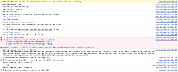

Clear cache and reload was of course done. The browser console does not actually show anything when clicking on locations/equipment/properties. But I see the following when refreshing the homepage.
